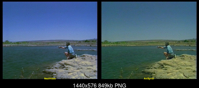

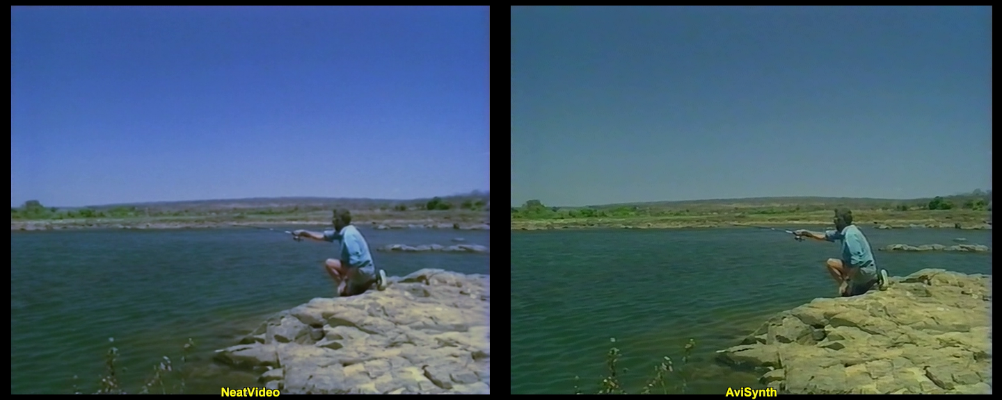

    In Virtual Dub 2: Yadif Double Frame Rate deinterlace, Colourmill colour adjustment, Neat Video denoiser on default, cropped and resized, exported at CRF 16.
    Thanks Alwin, this gives the opportunity for an additional comparison (colors apart) between NeatVideo approach and AviSynth approach (within the limits of used parameters). The winner is obvious.
    Here the comparison with the sli images: https://imgsli.com/MTU2Mjg5

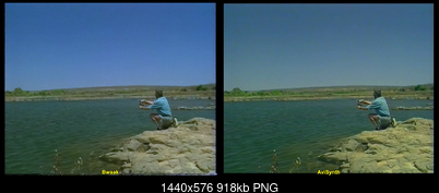

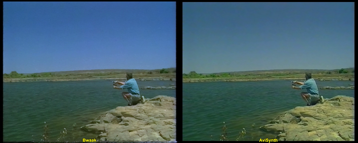

    Here is my take https://easyupload.io/rhenrx The file is 8 MB, will expire in 6 days.
    All in VDub2:
    - MSU Deinterlacer
    - 6-axis color correction
    - Camcorder color denoise (56)
    - Temporal smoother (3)

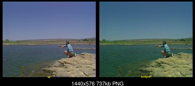

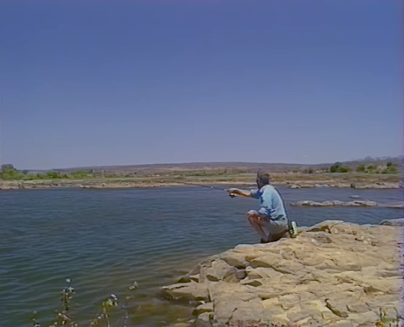

    And my attempt:
    1. VirtualDub2 - deinterlace, crop, ColorMill, resize, Neat Video
    2. VEAI - AMQ
    (A bit oversharpened, color range not corrected, without paying attention to aspect ratio)
    [Attachment 69289 - Click to enlarge]

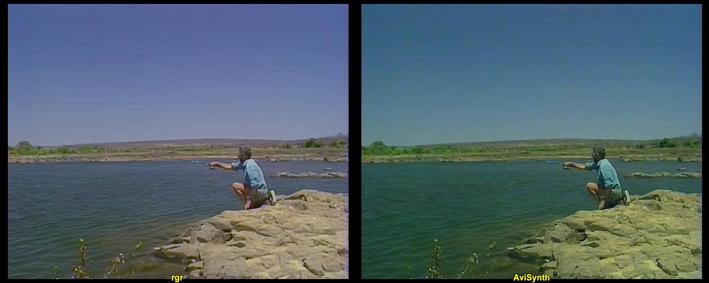

    Thanks Bwaak and rgr for your attempts.
    Comparison between Bwaak and AviSynth:
    Here the comparison with the sli images: https://imgsli.com/MTU2NDcz
    Comparison between rgr and AviSynth:
    Here the comparison with the sli images: https://imgsli.com/MTU2NDcy
    Even with these two new cases (color apart) the winner is evident

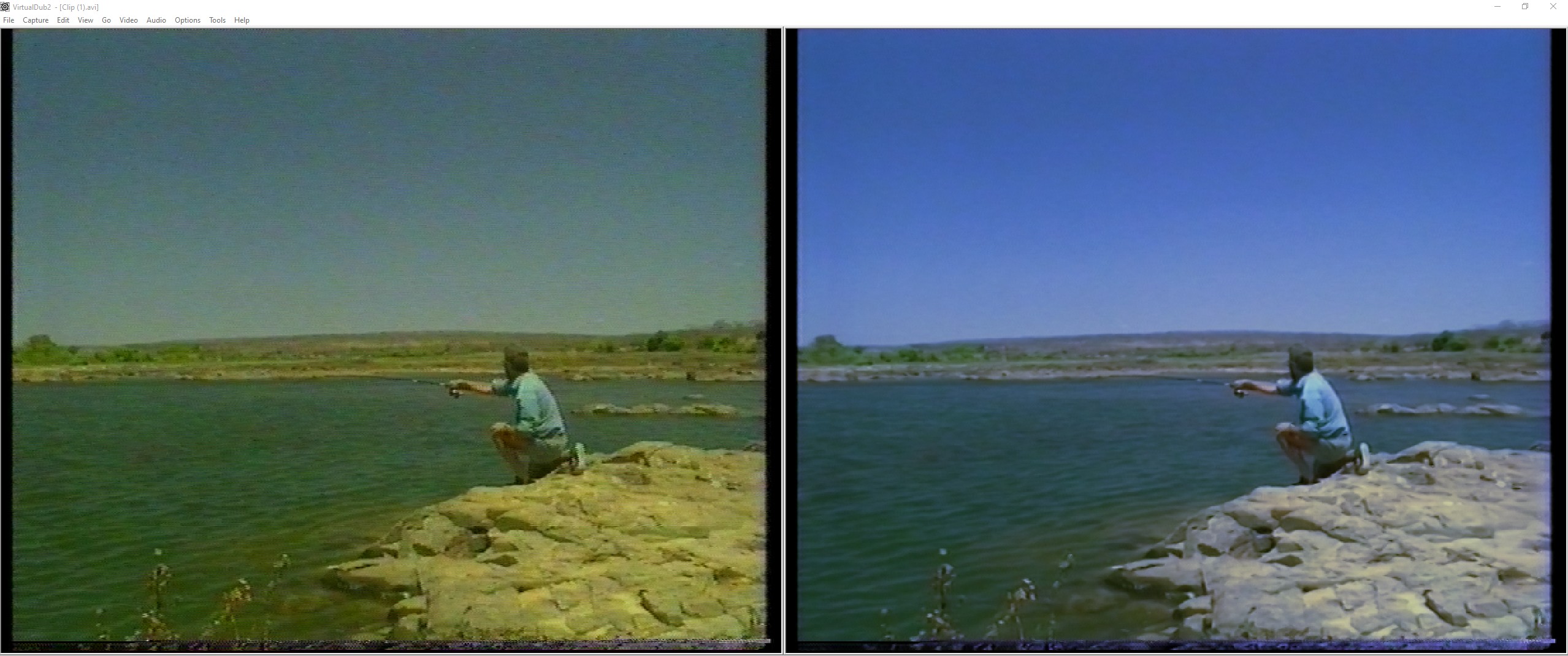

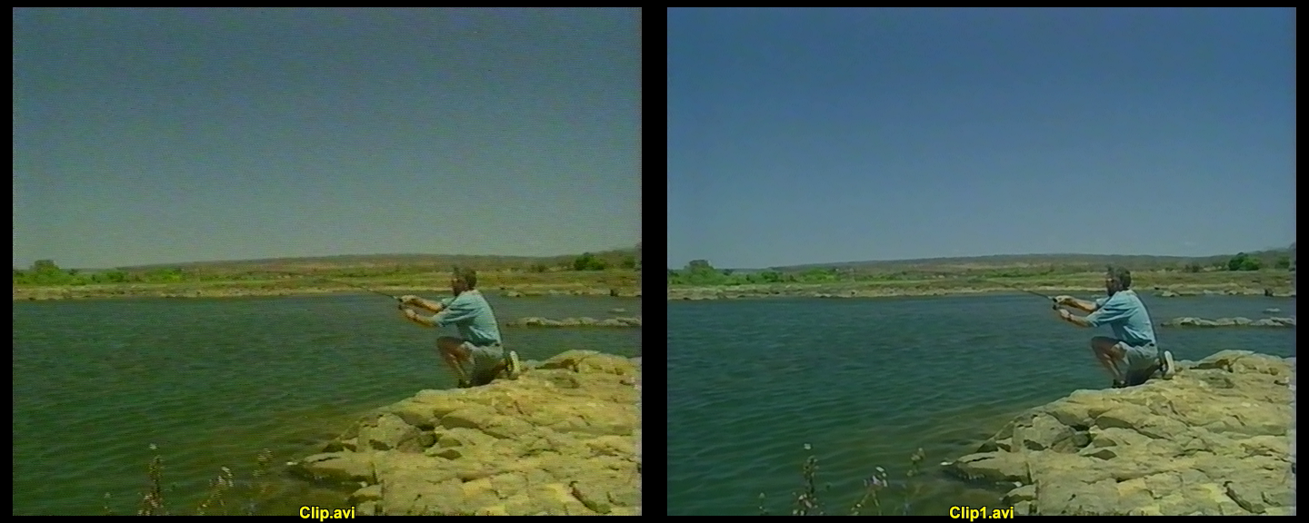

  14. It's hard to say without a wider variety of shots, especially without a reference for black and white levels. I used some of the bright rocks in the foreground as a white reference. That leaves the sky is a little too purple.
    ConvertToRGB(interlaced=true).RGBADjust(r=188.0/182.0, b=188.0/95.0).ConvertToYV16(interlaced=true)
    Tweak(sat=0.70)
    ColorYUV(gain_y=100, off_y=-20)
    [Attachment 69295 - Click to enlarge]
    Toning down the red adjustment would alleviate the purple sky.

    Lollo, no it's not. Look at Bwaak's attempt; the shadow on the back of the man is visibly worse in your AVISynth attempt.
    RGR's attempt is pretty darn good as well, in fact even better. Without a label, it would be very difficult to tell which one is which.
    Since we're into comparison mode, you should fix up your colours.
    In any case, the point is that one can get a pretty good result without the AVISynth effort; some of us just don't have the time or the talent to get on top of it. And when it's actually being viewed as a video instead of poring over a slide-image, I don't think the viewers would actually complain about the non-AVISynth versions.
    Please don't get me wrong; I am not belittling your results; they are great. But for much less effort, there are other, simpler ways of achieving the aim being good quality video.

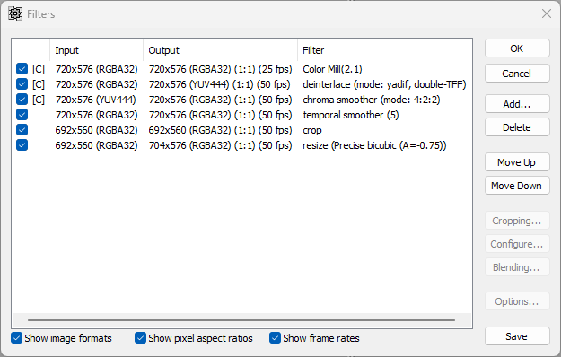

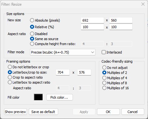

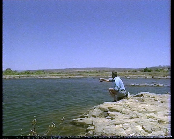

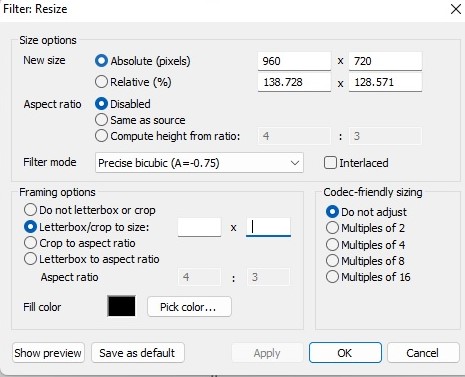

  19. I've just processed a 25 minute episode of the show with these filters and it doesn't look too bad at all. Much less noise, and with the colour correction its significantly better. Ill give the neat video denoiser a try next and see if I can improve it even more.
    [Attachment 69315 - Click to enlarge]

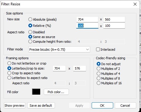

    The thing that always confuses me is the cropping and resizing. Just wondering if I've got this right before I process more episodes?
    [Attachment 69316 - Click to enlarge]
  20. Banned
    Nov 2022
    704x576 (some would say, 703x576 or even 702x576) has 4:3 proportions. Since you are deinterlacing into 50p, I assume this is your target frame rate and scanning type. It is not applicable to DVD-Video. If you want to upload to YouTube and preserve 50p, you need at least 720-line video.
    Therefore, for maximum compatibility with software players as well as YouTube, I would set Aspect ratio to "disabled" and set New size to 960x720, and set sample aspect ratio in the output codec to 1 (for h.264 there are two fields sample width and sample height, set both to the same number, for example, to 1).
  21. Originally Posted by Bwaak View Post
    I’ve got no plans to upload anything youtube. Its just for personal viewing, mainly from a pc. Im deinterlacing the fishing series because im putting them onto a usb stick for my dad to watch and figured it would look better for him to watch that way. I’ll keep everything as avi and probably wont de interlace most of it, I’ve found that vlc doesnt do too bad of a job as Im watching.
    The thing that I do want to do on all of my videos is too add black bars all around to hide the distortion. Would the setting I’ve used be ok for videos that I want to keep as avi, but just want to add black borders to?
  22. Originally Posted by Leanoric View Post
    Yes, provided the player plays the new .avi files as 4:3.
    If you re-encode it with x264 (.mp4) you may resize to square pixels as Bwaak suggested, or you can keep your proposal but encode it with SAR 12:11 (SAR width=12, SAR height=11 in the x264 GUI of VirtualDub2).

  24. Crop by any amount you want. Then set the SAR (sampling aspect ratio) in the compression codec to 12:11. The SAR doesn't change when you crop.
    If your players don't respect SAR flags, resize to 786x576, crop by any amount you want, then encode square pixel.

    Cropping has to be somewhere around the legal ratio of 704:576 (1.22 for reference only), Cropping too much on one direction could affect the final frame aspect ratio, Some tapes have large head switch noise and little horizontal blanking edge or vise versa, so if cropping freely by any amount and end up for example with 702x556 (1.26, compared to 1.22), that's a big difference, the frame geometry is going to change quite a bit, 8 pixels difference between the supposed resolution and the actual cropped one is tolerable, more than that will become visible.
    Also if cropping is intended, don't resize back to the original resolution or anything less than at least 1080, the resizing artifacts will be noticeable, I'm working on an experiment to show how bad when you resize vertically to a resolution very close to the original one, The higher the resolution the less the jagged edges, Some resizing software smooth out the jagged edges at a cost but it is better not to have a lot of them to begin with.

    No. Since these are ITU caps the 4:3 image is in a 704x576 portion of the 720x576 frame. The full 720x576 is wider than 4:3, ~786x576.

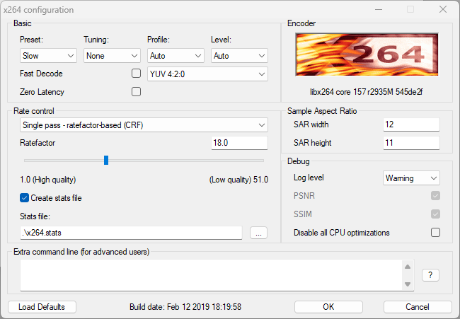

  28. By the way what the OP suggests in his post#229 is technically correct: He crops and pads (he doesn't resize) the frame by adding borders for obtaining a standard frame size of 704x576. If he plays this at an AR of 4:3 it gives an undistorted picture. If he re-encodes with x264 he has to set the SAR 12:11 as advised before.
    @Leanoric: In fact you can crop by any amount (preferably mod2 for 4:2:2 sources as yours, or mod4 for 4:2:0 sources) in order to fully remove any right/left/top/bottom crud and pad back to 704x576, play it as 4:3 (forced by the player or TV), and eventually encode it with SAR 12:11.
    In the case of your post#229 I would crop more on left and right, for example something like below. The 3rd picture in the attachment is for re-encoding with SAR 12:11.
    (In the second picture of the attachment you may want to set the Fill color/Pick color.... to 'green' instead of 'black' for testing, in order to better visualize what's happening.)
    The alternative would be to resize to square pixels.
    A mistake I was making before was encoding to mp4 and leaving SAR at 1:1. Ive now changed it to 12:11 cropping to 692x560 and resizing to 704x576. Strangely VLC now keeps crashing when I play these files. I can watch them ok but then cant shut VLC and it then crashes?
    Maybe it would be better to resize to square pixels for better compatibility with players?
    Is Bwaaks suggestion of "set Aspect ratio to "disabled" and set New size to 960x720" how you resize to square pixels?
    Should I still be cropping to 692x560, and then resizing to 960x720? Im also not sure about what numbers to put into the letterbox/crop to size boxes?
    [Attachment 69325 - Click to enlarge]
    Nothing. Check "Do not letterbox or crop".
