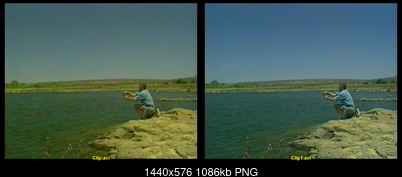

  1. Originally Posted by Sharc View Post
    The video may be progressive (PsF), even on VHS. Nevertheless I re-encoded it as interlaced. That's debatable though.
    Just a quick shot with a bit of denoising, colorsharpening and levels adjustment:
    Nice one Sharc, looks much better than the clip that I posted. Can that all be done in virtualdub?
    Do you have any idea why my captures are progressive? I have progressive turned off in the es10 settings, Is there something that I need to change in virtualdub?

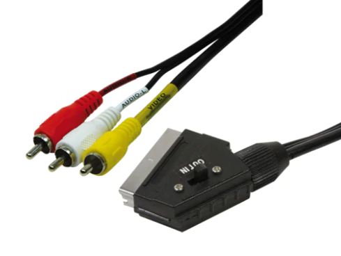

  13. mr. Eric-jan's Avatar
    Apr 2018
    Netherlands
    There are SCART adapters with an in/out switch, these are also in through versions, and have RCA audio/composite s-video DIN, depending the setting of the switch, they are input or output.
    (A cable version should have a switch, or cables both for in and output)
    I'm not a fan of SCART, i use RCA or DIN for better quality connections, where possible. (because of better shielding)

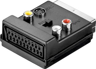

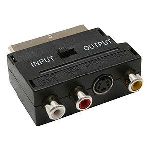

  15. @Leanoric:
    What exactly is your setup? What equipment? You will probably need something like this to connect your VCR to the DVD recorder or capture dongle:
    [Attachment 69257 - Click to enlarge]
    or perhaps this from your ebay link:
    [Attachment 69258 - Click to enlarge]

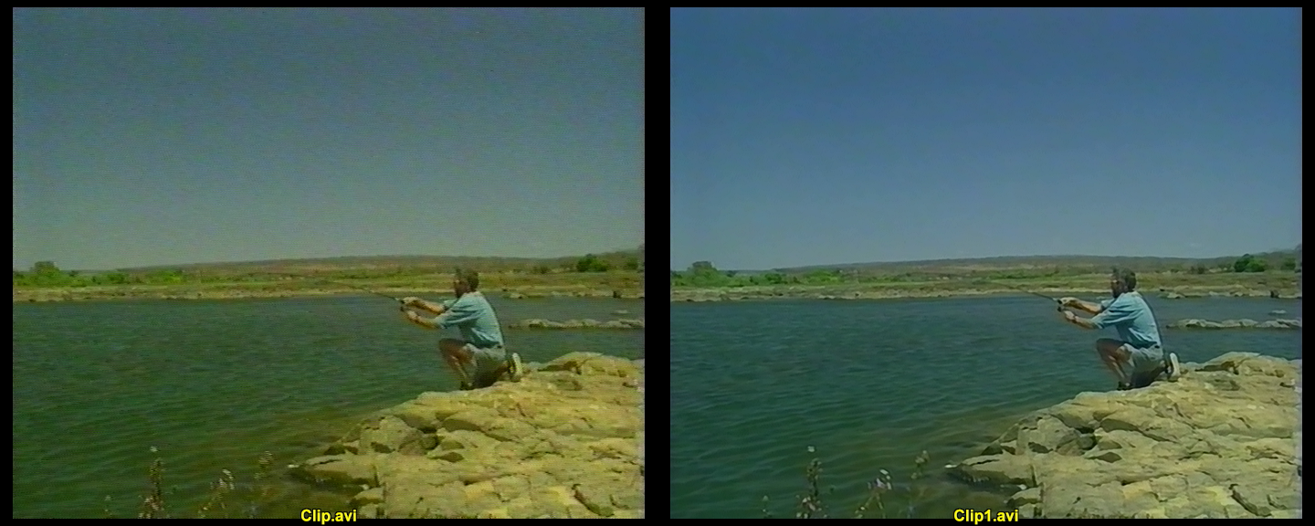

  30. Captures & Restoration lollo's Avatar
    Jul 2018
    Italy
    The samples are very noisy, probably because the tapes and not (completely) fixed the VCR, but not completely unwatchable.
    A simple AviSynth post-processing improves a bit. Just a quick attempt on my side, play with the parameters for better results.
    sli image comparison: https://imgsli.com/MTU2MTI3

    	crop_top=2	# | 720-(12+16)x576-(2+14)=692x560
    	crop_right=16
    	crop_bottom=14
    video_org_crop=video_org.crop(crop_left,crop_top,-crop_right,-crop_bottom)
    video_org_crop_adj=video_org_crop.ColorYUV(off_u=+12, off_v=-6)
    	# QTGMC
    Import(plugins_dir + "QTGMC.avsi")
    	# Zs_RF_Shared
    Import(plugins_dir + "Zs_RF_Shared.avsi")
    	# Nnedi3
    loadPlugin(plugins_dir + "NNEDI3_v0_9_4_55\x86\Release_W7\nnedi3.dll")
    	# TemporalDegrain2
    Import(plugins_dir + "TemporalDegrain-v2.2.1_modGMa.avsi")
    	# RgTools
    loadPlugin(plugins_dir + "RgTools-v1.0\x86\RgTools.dll")
    	# MaskTools2
    loadPlugin(plugins_dir + "masktools2-v2.2.23\x86\masktools2.dll")
    	# MVTools
    loadPlugin(plugins_dir + "mvtools-2.7.41-with-depans20200430\x86\mvtools2.dll")
    	# FFT3DFilter
    loadPlugin(plugins_dir + "FFT3dFilter-v2.6\x86\fft3dfilter.dll")
    	# FFTW
    loadPlugin(plugins_dir + "LoadDll\LoadDll.dll")
    loadDll(plugins_dir + "fftw-3.3.5-dll32\libfftw3f-3.dll")
    	# dfttest
    loadPlugin(plugins_dir + "dfttest-v1.9.6\clang\x86\dfttest.dll")
    	# dither
    loadPlugin(plugins_dir + "dither-1.28.0\win32\dither.dll")
    	# LSFmod
    Import(plugins_dir + "LSFmod.v1.9.avsi")
    ### de-interlacing
    deinterlaced=video_org_crop_adj.AssumeTFF().QTGMC(preset="slow", matchpreset="slow", matchpreset2="slow", sourcematch=3, tr1=2, tr2=1, NoiseTR=2, sharpness=0.1)
    ### convert to YV16
    deinterlaced_yv16=deinterlaced.convertToYV16()
    ### denoising
    denoised_yv16=deinterlaced_yv16.TemporalDegrain2(degrainTR=3)
    ### convert to YUY2
    denoised=denoised_yv16.convertToYUY2()
    ### convert to YV12
    denoised_yv12=denoised.convertToYV12()
    ### sharpening
    sharpened_yv12=denoised_yv12.LSFmod(defaults="slow")
    ### convert to YUY2 with chroma from YUY2 color space
    sharpened=sharpened_yv12.convertToYUY2().MergeChroma(denoised)
    ### add borders
    video_restored=sharpened.addborders((crop_left+crop_right)/2,(crop_top+crop_bottom)/2,(crop_left+crop_right)/2,(crop_top+crop_bottom)/2)
    return(video_restored)
