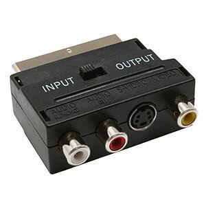

    Don't see whether you mentioned how you're adapting the SCART output, but make sure you use SCART-to-composite (not to S-Video) for this plain VHS VCR.

  4. mr. Eric-jan's Avatar
    Apr 2018
    Netherlands
    Originally Posted by Leanoric View Post
    Ah ok, hopefully its just interference then. The vcr hasnt got s-video unfortunately, just scart. I’ll move the vcr to a different location and try different cables. I have got an es10, so I’ll try using that as a passthrough as well and see if it makes a difference.
    SCART can have s-video in it, did you check your vcr manual ? (you never mentioned which vcr you're using… model name/number?)
    It's worth a try. dot crawl comes mostly from composite video (the internal composing of this vcr could be bad)
    But i doubt it's dot crawl because dot crawl is between solid colors.

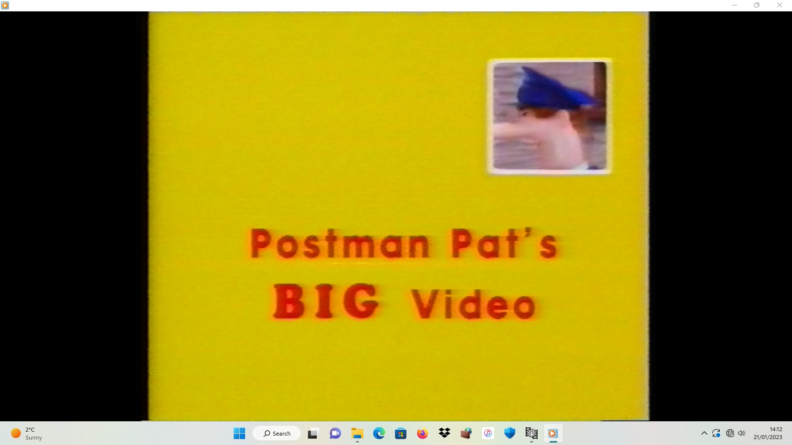

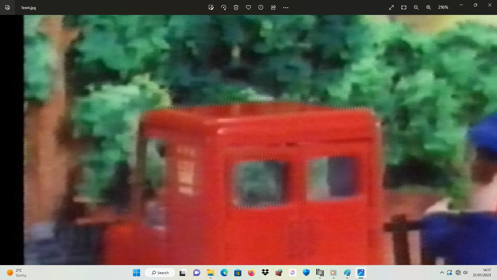

  17. My new cables haven't arrived yet but I've had a play around, this time repositioning the vcr and also using the es10 as a passthrough for the first time.
    I think that the es10 has made a big difference. Picture is nowhere near perfect as to be expected but is definitely much better.
    The first picture is without the es10, the second with.
    There seems to be what almost looks like interlace lines, except they're not, around the edges of things though. Deinterlacing doesn't make any difference to them.
    I've zoomed in on a screenshot for picture 3 to try and show you what I mean, any ideas?

  18. A massive improvement already.
    What you get is probably still some residual dotcrawl which can be difficult to eliminate. I don't know the ES-10 particular settings, but if there is a "comb Filter" or "3D-Y/C separation" or "3D NR" or a similar menu item switch this function ON.
    Looks to me like the captured video is progressive (PsF).
    For better advice upload a few seconds sample of that captured scene.

    The second picture looks much better aside of dot crawl. SVideo should make them disappear.
