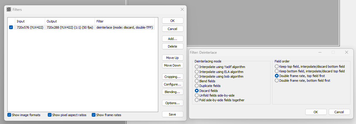

  2. Originally Posted by lollo View Post
    I prefer the AviSynth approach because you examine the true fields without applying any deinterlacing and then conclusion on processed material. I found (rarely) in the past that it can lead to misinterpretations.
    Yeah, but one can examine the true fields in VDub2 as well. I am not defending here anything but rather give the OP a hint because he is not very familiar with Avisynth (yet)
