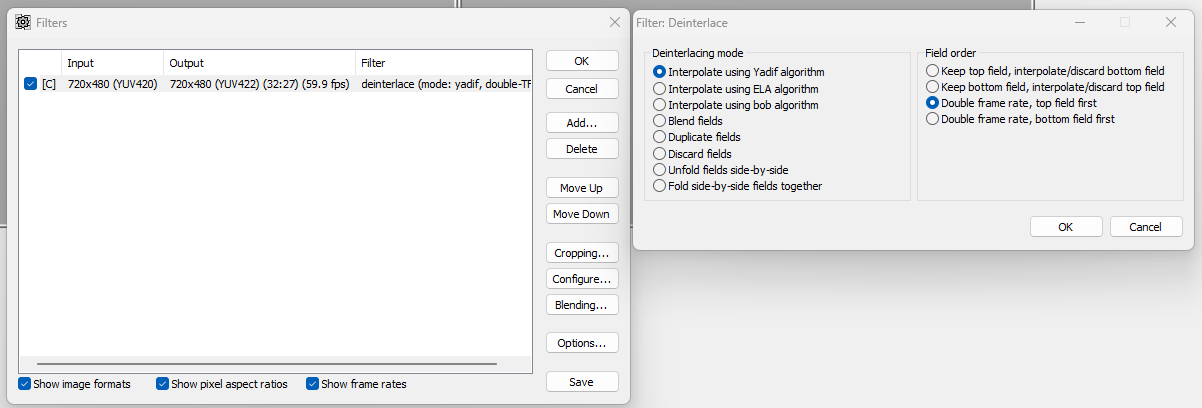

  26. Originally Posted by Leanoric View Post
    Thanks Lollo, I'll give that a try when (if) I manage to understand how to use Avisynth.
    You can basically do the same tests using any of the deinterlacers or bobbers included in VDub2:

  27. Yes I tried yadif tff and then bff, and thought that it was strange that they didnt really make a difference. I didn't realise that there was video from back then without interlacing.
    Ive noticed it now on a few different adverts, the edges where you would normally see interlace lines, seem to be quite blurry instead.

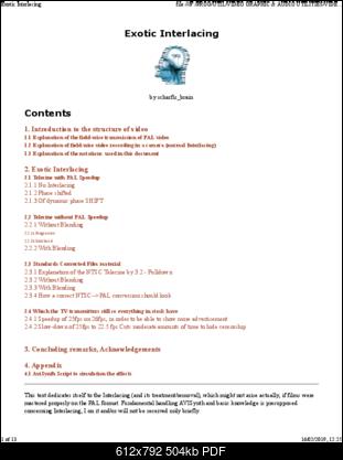

    More complex phase shift requires a field matching solution and are well analyzed in famous Scharif's document:
Name:	Exotic Interlacing(English).pdf
