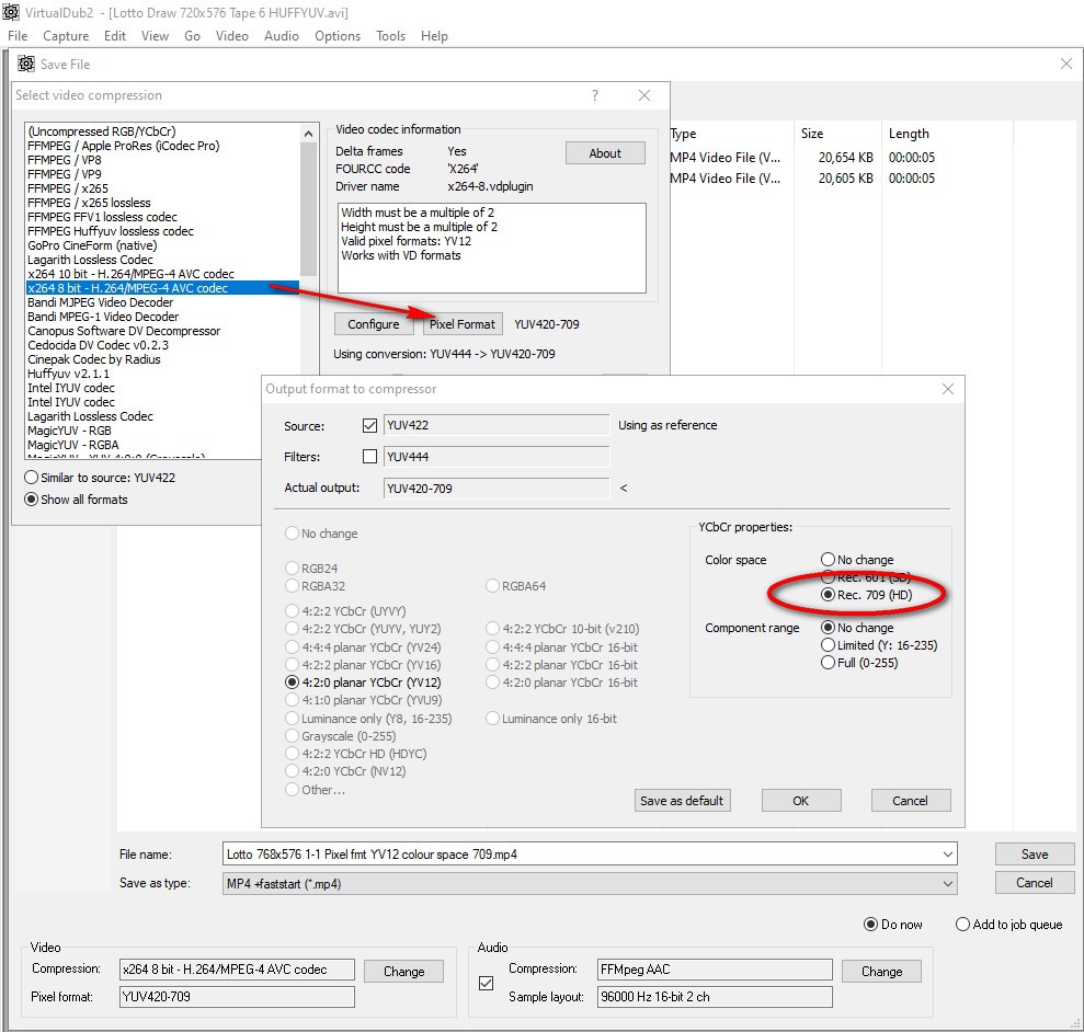

    Back to the colour space change for HD (601 to 709). This is what I used in VDub 2:
    [Attachment 69382 - Click to enlarge]
    Result is attached (same file as before this edit, renamed). Is this a 709-compliant file? Mediainfo indicates so.
  9. Member Cornucopia's Avatar
    709 is not appropriate for SD material. 601 is.
    May 2005
    Australia-PAL Land
    Scott, I miss-named that file, it is obviously HD and I know, as clearly indicated in my comment. I'm simply asking if the file is really a 709.
    Edit: I've renamed the file attached in my previous post.
