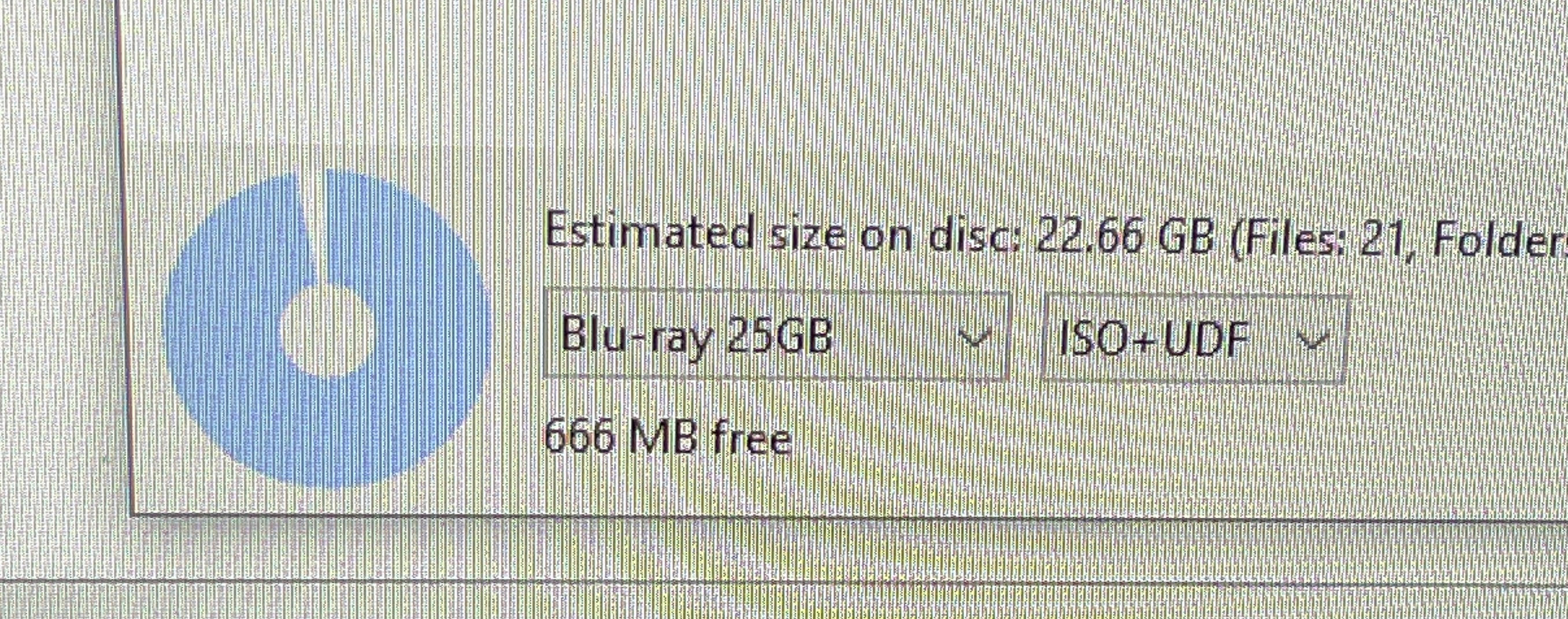

    Using BurnAware software I filled up a 25GB disk with files (see Photo #1).

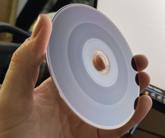

    After burning AND verifying, I look at the disk and to my experience with disk burning (25+ years)....it looks like it only actually filled half the disk (see Photo #2).
    So my first thought was, Ok...this must be a 50GB blank Disk. But I know I didn't buy 50GB disks because they were so much more expensive. So then I thought, well maybe they sent me 50GB disks by mistake, But when I set the disk size in the software to 50GB, it errors out.
    Any thoughts appreciated.
    Photo #1: Image
    [Attachment 67395 - Click to enlarge]
    Photo #2: Image
    [Attachment 67396 - Click to enlarge]

    Inserted a blank disk and used different software to verify....it is, indeed, a 25GB blank disk. I've burned it twice and got the same result (looks half-full).
    Verified this further by looking at some disks from the same batch that I burned some months ago and they look correct (dark/burned area covered entire disk).

    The color may depend on the burning speed. If the speed was set to auto it can use different burning speed for different areas.

    Answer was: The color may depend on the burning speed. If the speed was set to auto it can use different burning speed for different areas.

    Surely you don't really think the issue was just being unhappy with "how it looked", right? The question was seeking info on why it APPEARED to only be half-written. The answer, as it turns out, was that INDEED it only LOOKED half-written. It was fully written across the entire span of the disk, it just had a lighter color due to the software using different write speeds on different parts of the disk.
