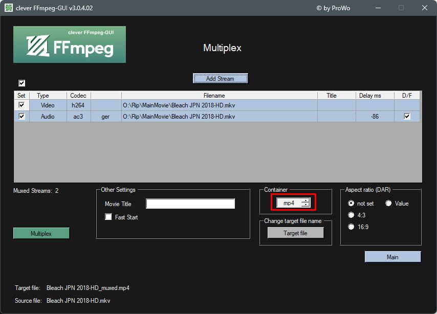

  5. You may be able to convert your mkv to an mp4 without doing any recoding.
    Download clever FFmpeg-GUI.
    Extract the file where you want and run clever FFmpeg GUI.exe. Follow exactly the instructions at the first start.
    Then load your mkv, click main, click multiplex, choose mp4 as container and click multiplex.
    [Attachment 67385 - Click to enlarge]
    If the mp4 container can accept your streams, the result will be your desired mp4 video.
    If one or both streams are not accepted, the program will tell you the faulty codec.
    You can then recode the corresponding stream with clever FFmpeg GUI and mux it with the other streams to mp4.

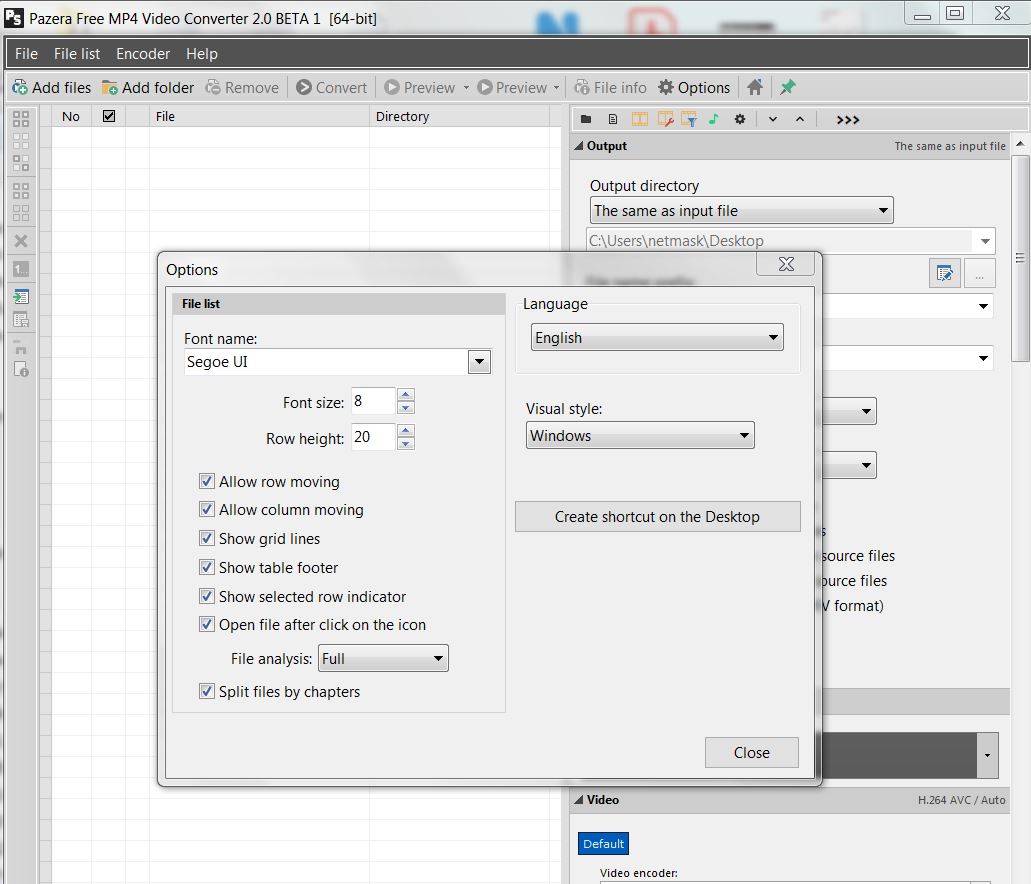

    As I suggested you need to look in options - I download the program and took a cursory look at the options available and one box "split files by chapters" is ticked by default. So anyone installing this program needs to untick that box if you don't want lots of individual files. It's a simple job to fix. Here are a couple of images for you.
    [Attachment 67414 - Click to enlarge]

    Sorry it's been so long. I got so disgusted with everything I tried not working, I gave up for a while. Now I've just come back (11/8) and for the first time I believe the fog is clearing. Just today I went back onto that Pazera thing and I looked over the many different boxes you can check. And I did notice that one box that Netmask56 talked about here. That looked like a definite possibiliy to try out. Then later today I returned to this help forum and I now see Netmask56 talking about the very box I noticed and thought about earlier. Thank you Netmask 56, I'll try this out and hopefully this will be the answer. I read over each of all others suggestions here, and things just got too technical for me. I'm certainly not an expert, the old KISS theory works best, "Keep It Simple Stupid". So I will try out this latest idea about clicking that "split files" box. That did seem like a possiblity when I saw it. Now Netmask56 has confirmed this. So thank you to every one here, I appreciate all you've told me, even if some of it was over my head. I will try out this "split files" suggestion and see if that works.
    Thank you all.
