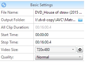

  17. Hey: Doing a 'reformat" of the same DVD's and here's what I came up with. Using AVC , I used these settings MKV to mp4(h265) quality set to "high" video size: 352X240 (best it could do). Well, it didn't turn out as well as it has in the past. Noticed it was really reducing the size of the file from 6+G's down to 350 mb's (or so). Hmm...not sure 'bout that and probably why video is degraded(??). Thinking I'll try .avi and see how that turn out. Post results later.

  19. With a DVD source (720x576 PAL, 720x480 NTSC) your should never set a lower resolution, 352x240 in your case.
    You can't expect quality at this low resolution.

    Alright, I once again, ripped/re-formatted the DVD. MKV rip was 4.2Gb. When formatted to mp4 the file size is 304Mb. The settings of AVC(anyvideoconverter) BASIC settings - - video size 352x240,,,quality-HIGH In video options; video codec: x264 Frame Rate - auto Video Aspect - auto Encode Pass - 1 Didn't adjust any audio settings. IDK...pic quality is low.
    With such settings, the quality must not be high.
    Resolution: 720x480. The other settings are ok.
    Rip looks good.. Oddly, isn't interlaced...
  27. Member
    Mar 2008
    Set it up like this. Program uses 1-pass ABR mode for MKV. I set a custom bitrate of 1500
    Image Attached Images
  28. Member
    Aug 2018
    Wrocław
    Use the crf (19) parameter instead of bitrate. But I don't know if avc has this option. Or increase the bitrate. From my observations, poor mpg compresses poorly to h264 with low bitrate.
  29. Member
    Mar 2008
    I prefer CRF myself, but it wasn't immediately obvious whether it could be set in AVC.
    The 1500 bitrate in the source I used was equivalent to approx CRF 14 (tested in VidCoder)
  30. Hey ALL: This time I changed one thing and the "quality" is better. Maybe not what I'd like, but much better than anything I've gotten previously. I changed to video size from 352x240 to ''original". To davexnet & rgr. I agree the resolution needs to be 720x240 or better, but not an option w/ AVC. UNLESS I can enter that resolution in Video Options>Customized Quality Options(?) I'll try that! Quote: "I prefer CRF myself," ?? What is CRF? You know, I've used AVC (anyvideoconverter) for quite awhile and until recently, never changed anything/settings and always had good quality pix! I'm still open to any other open-source "converter" that can produce good quality. Have been trying many and it's a crap shoot to find a good one. Movavi wouldn't "load"/install (just kept buffering at about 85%), same problem with Handbrake, Wondershare will only rip first 5 mins. of film, and others will only give you a limited time "trial".
    A great deal of thanx to everyone helping out on this thread. I'm learning a little and getting some good help. APPRECIATED!!!
