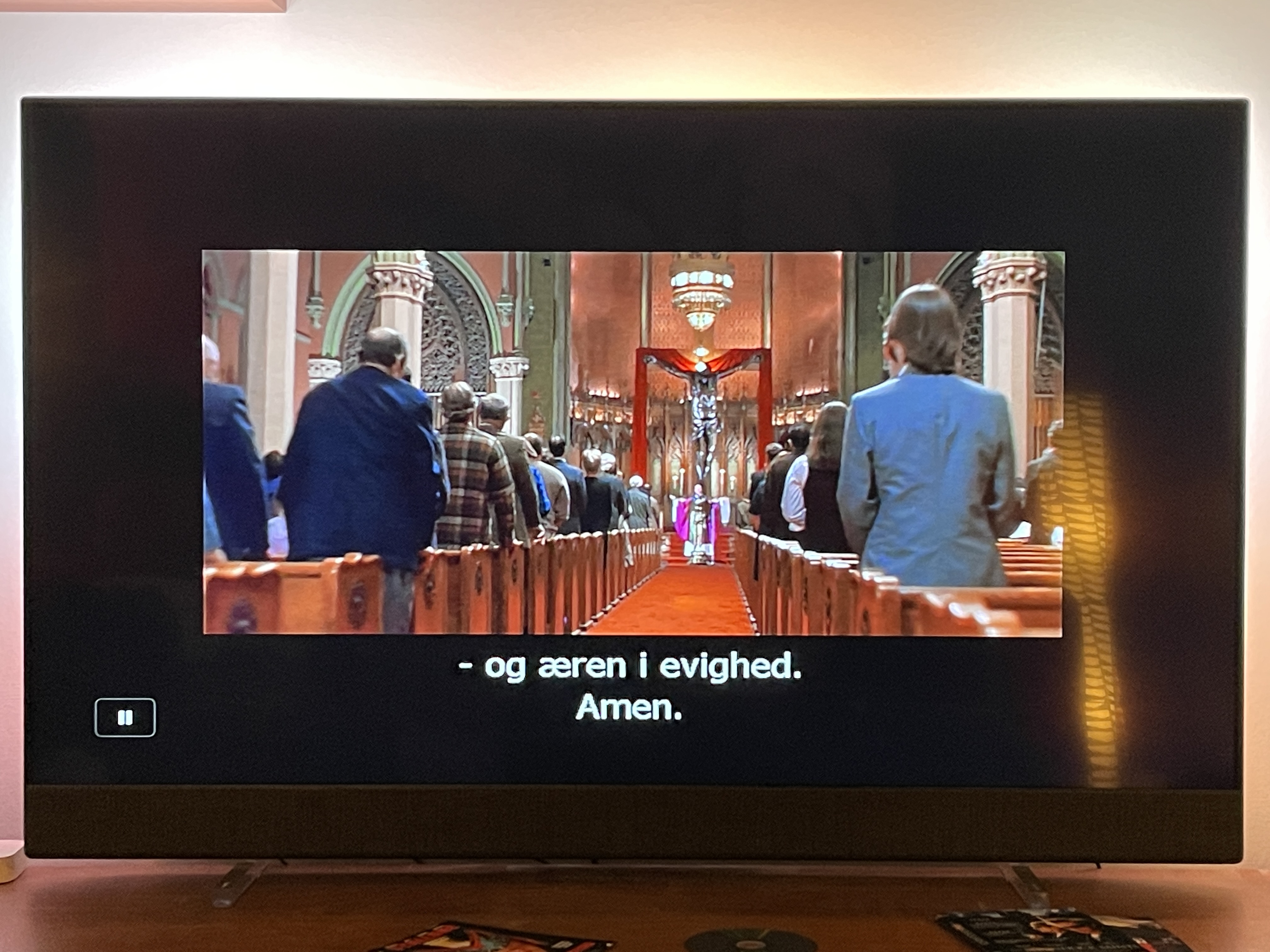

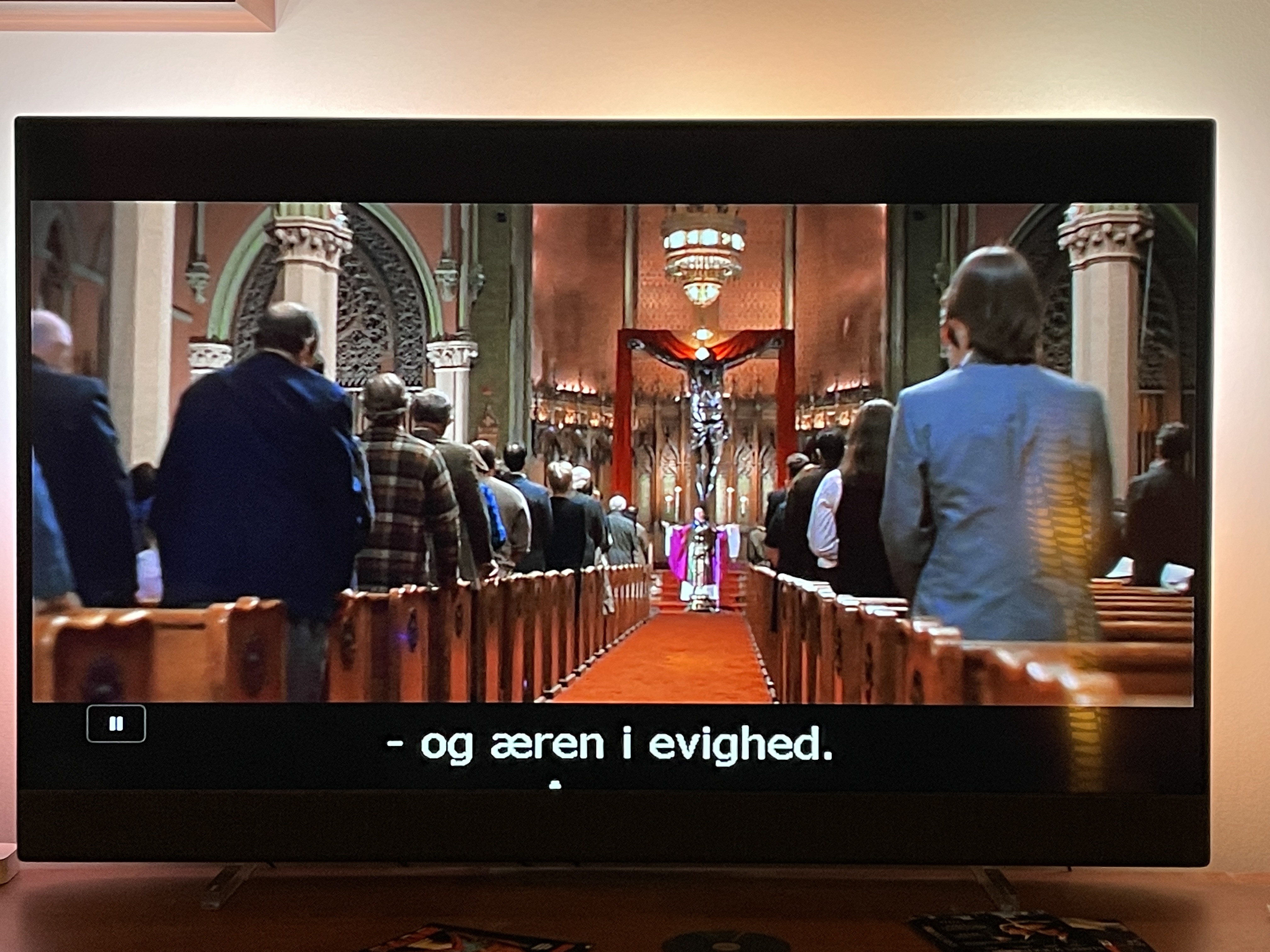

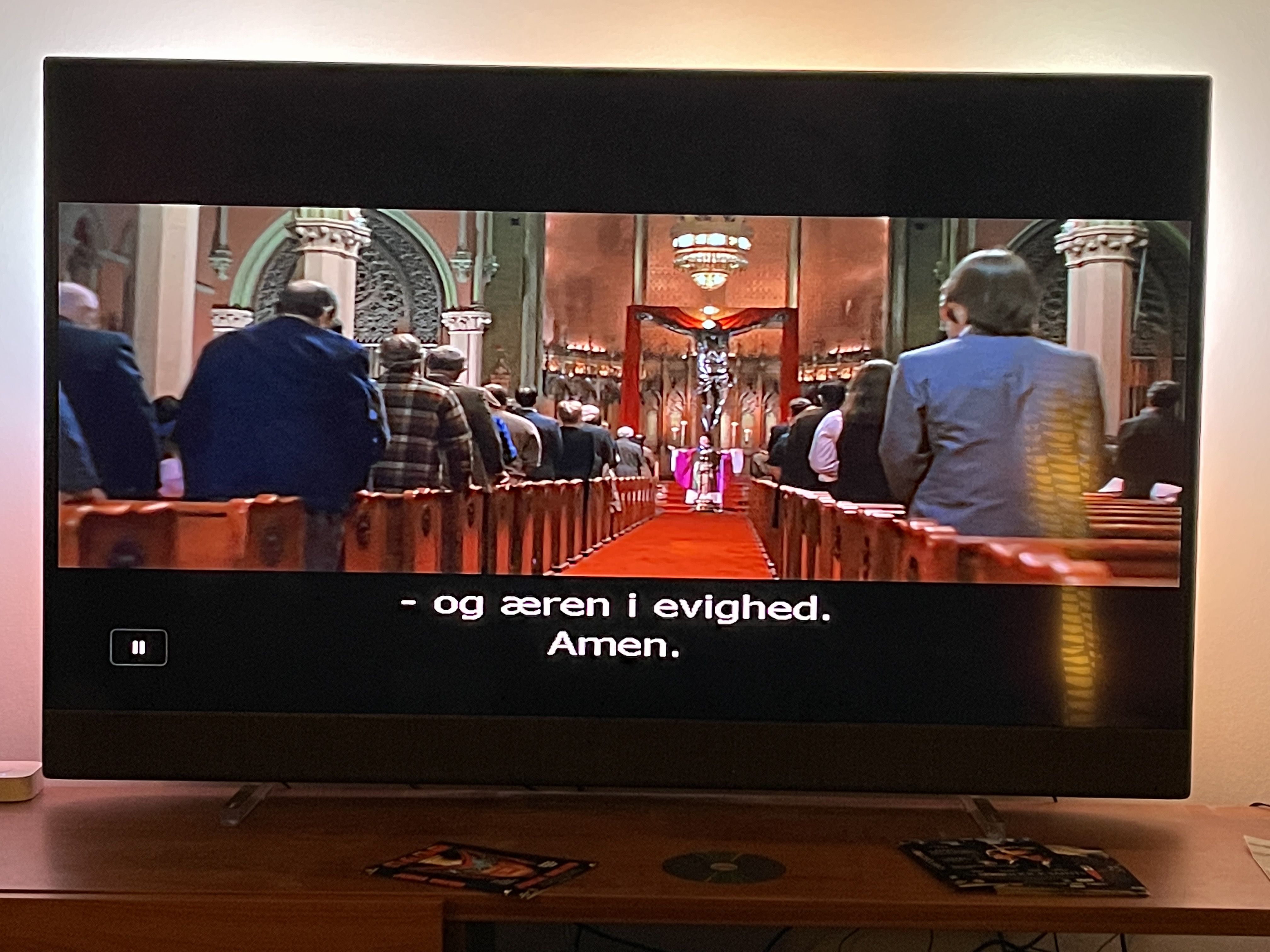

    I just tried to pop in one of the "affected" dvd's, just to see what format I get, and I get the format you see in the top picture.
    That is also the format I see, when viewing the ripped file, either on my computer or via Plex
    But at least on my PS4, I get the option to choose between "Full" and "Zoom" as well, which at least makes it watchable. Though "Zoom" cuts off the bottom part of the subtitles.

  8. You have a ~2.24:1 movie letterboxed in a 4:3 DVD frame. The black bars above and below the picture are part of the DVD frame. When you play that the 4:3 DVD frame, including the black bars at the top and bottom, fills the height of the TV and the rest of the 16:9 TV frame is filled with black pillarbox bars. The top image is exactly what one expects to see. If you don't want the pillarbox bars you have to crop away the letterbox bars from the DVD frame and reencode the video.

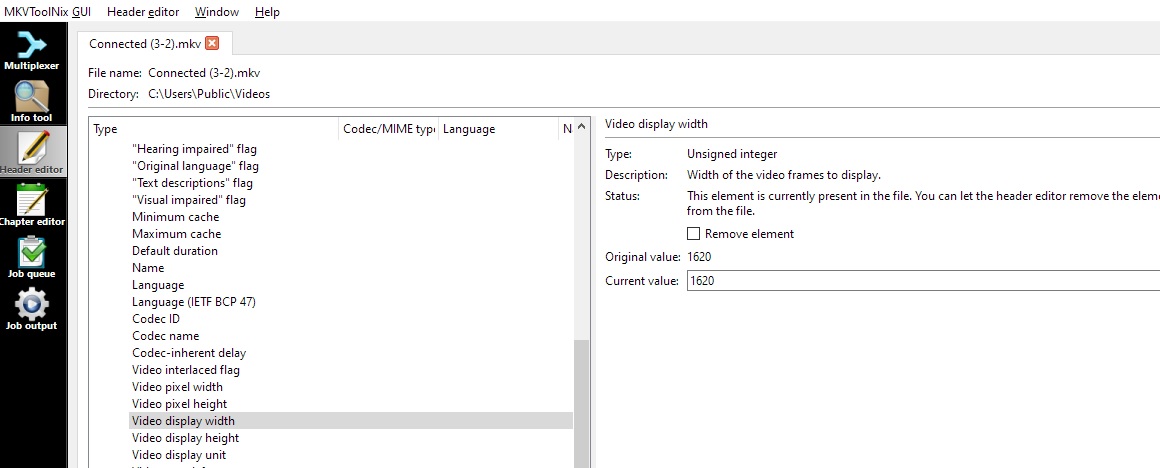

    What header editor? MKVtoolnix? I see the video display width, are you talking about something else?
    Clever FFmpeg GUI is using "-aspect 1.5" in it's command line, I assume this is responsible for the extra info
    in "video display unit", "video display height" and "video display width"
