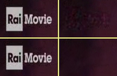

Your delogo (top) vs My delogo (bottom):
Code:LWLibAvVideoSource("D:\Il giocattolo - cut - 20min sample.mkv").AssumeFPS(25) InpaintDelogo(mask="D:\m.bmp", Loc="26,18,-598,-496", Mode="Deblend", dPP=-5, GrainPP=3)Last edited by VoodooFX; 24th Oct 2022 at 15:23.
that's perfect, I want to learn how to do that with the minimum amount of "analyze" and "create ebmp" time.

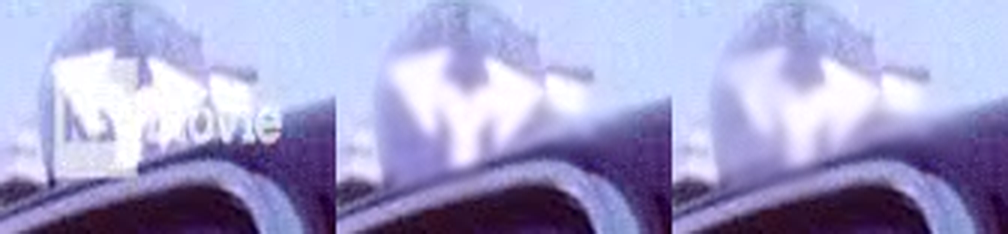

You can use settings with more inpaint artifacts instead of deblend artifacts [b]:
Frame 23781:v=LWLibAvVideoSource("D:\Il giocattolo - cut - 20min sample.mkv").Loop(0,0,10).crop(0,4,-0,-0)
a=v.InpaintDelogo(mask="D:\InpaintDelogo3_18-6-590-488_A2-16.ebmp", Loc="18,6,0,0", dPP=-5, GrainPP=3)
b=v.InpaintDelogo(mask="D:\InpaintDelogo3_18-6-590-488_A2-16.ebmp", Loc="18,6,0,0", dPP=-5, GrainPP=3, Interp=3, IntSpd=4, Optimize=1)
StackHorizontal(v.Crop(18,6,-590,-488), a.Crop(18,6,-590,-488), b.Crop(18,6,-590,-488))
Spline36Resize(last.width*3, last.height*3)
Frame 4201:

I've understood that due the poor quality of the source and the large amount of noise,
I should have to decide a compromise choosing between different parameters combos.
For this video I decided to not remove the logo anymore.
I'll try those settings combinations with the other previous HD movie.
thanks for all. -
