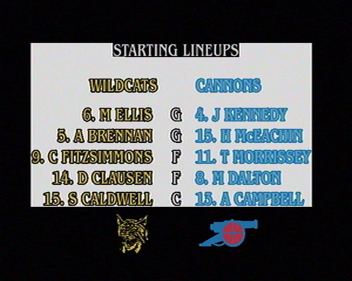

  1. Well that's...very weird, and I don't know enough about AviSynth to figure out why that might be happening.
    Looking at them both side to side, I like that the curves on Retrograde() are smoother, VHS_blur() is a bit too sharp. VHS_blur() is more the brightness I want. In terms of blurriness, the lines on the ball in the Cannons logo really shouldn't be as clear as they are in VHS_blur() but Retrograde() makes it look like a really obvious horizontal blur rather than a lack of detail.

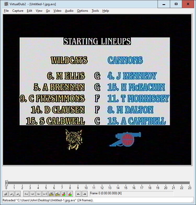

  2. Originally Posted by koberulz View Post
    Since I thought you only wanted the luma I didn't further blur the chroma. Here's a version that blurs the colors much like VHS (which only has about 40 lines of chroma resolution across the full width of the frame) and Retrograde():
    function VHS_blur(clip v)
        luma  = v.LanczosResize(300,v.height).Sharpen(0.2, 0.0).LanczosResize(v.width,v.height) # really RGB but we wil use the luma and alpha later
        chroma = v.ConvertToYV12().BilinearResize(120,v.height).AddGrainC(0.0, 30.0).BilinearResize(v.width,v.height) # convert to YUV, blur a lot
        MergeChroma(luma.ConvertToYV12(), chroma) # merge the lightly blurred luma and the heavily blurred chroma
        AddGrainC(3.0, 3.0) # a little more noise at the native resolution
        ConvertToRGB32() # convert back to ARGB
        MergeARGB(luma.ShowAlpha(), ShowRed(), ShowGreen(), ShowBlue()) # merge in the lightly blurred alpha channel from luma above
    ImageSource("Untitled-1.jpg", start=0, end=23, fps=23.976, pixel_type="RGB32")
    RGBAdjust(r=0.85, g=0.85, b=0.85) # darken a bit so bright halos can be seen
    VHS_blur()
    If you don't like the noise just remove the two calls to AddGrainC(). These are provided as scripts so you can modify them to your liking.
    [Attachment 67661 - Click to enlarge]
  3. Is there an issue with the color space conversions in that? It looks desaturated compared to the original.
    I've attached the original PNG frame, so you can test on that rather than my frame grabs.

  4. Yes, the colors are desaturated. That's what happens to small colored objects when recorded on VHS. The colors in the text bleed out into the white background and the white background bleeds into the colored text.
    <edit>
    Change the two instances of ConvertToYV12() to ConvertToYV24(). That will reduce the chroma blur a bit.

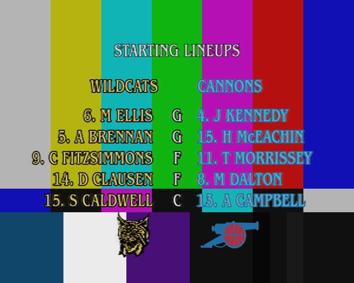

  21. Once again, did you verify that the final overlay is what you want? The internal blurring works well but around the edges the mask isn't expanded and blurred enough to blur the edges and keep the halos. And you text is all edges. So the final overlay looks nothing like the image.
    raw overly image:
    [Attachment 67674 - Click to enlarge]
    overlaid onto a background image (with alpha)
    [Attachment 67675 - Click to enlarge]
