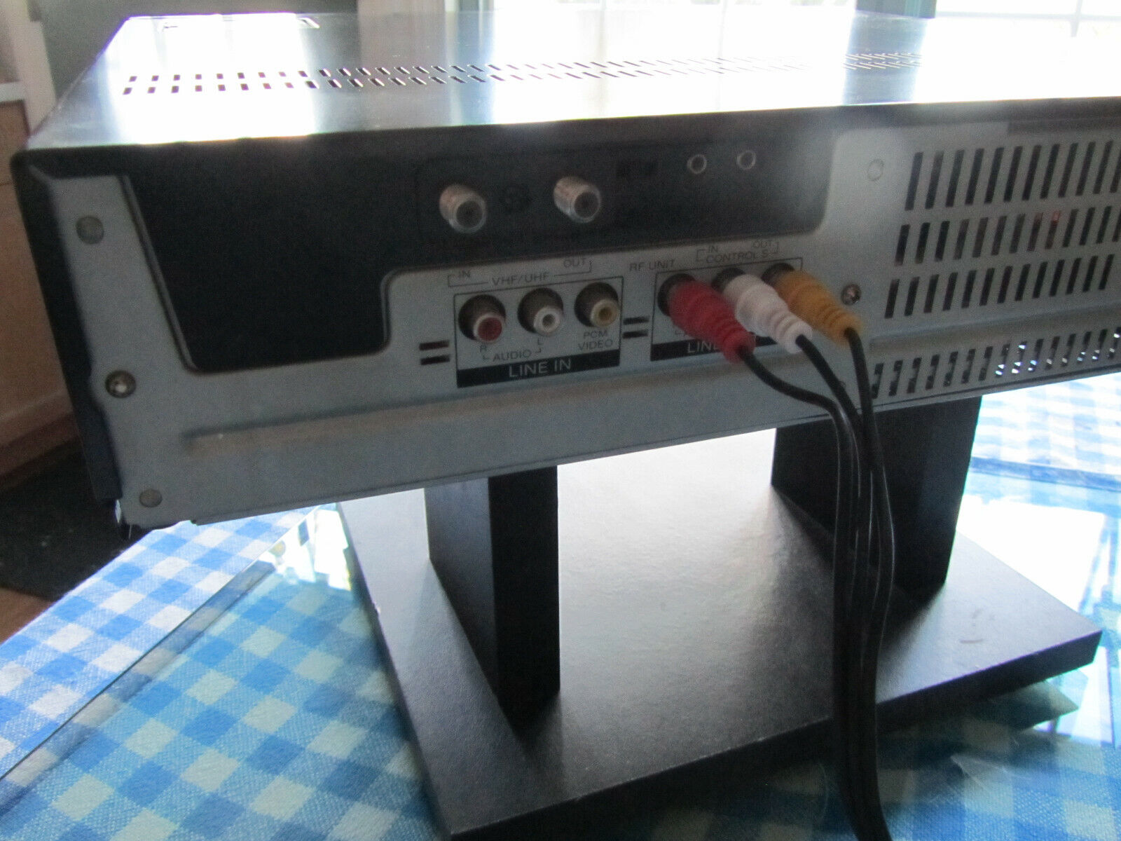

    Hi - We convert VCR tapes, Hi-8 tapes, VHS-C tapes, 8mm film,... but have run into a problem with a new request.
    We normally use Pinnacle 21 with a Dazzle connection to the computer. Not the best way, but it works 90% of the time. We recently had a person bring us 100 betamax tapes, so we purchased a nice Betamax player - Sony Super BETAMAX SL-HF550. I bought it from a man who restores Beta players. It came looks great & plays, but when I try to use the Dazzle connection we use with all of the other video players, nothing is seen when it plays. Normally, I will have the Pinnacle program open and when a camera/VCR is connected, the screen will change and you can play the tape. Nothing changes when the Beta is connected with the Dazzle.
    Am I missing something? What do I need to have my computer see the Betamax player and able to record the tapes? These are the connections in the back.
    Thanks,
    Sean

    Have you connected the player to the TV using that same cable/connection
    to see if it plays?

    on the betamax player, do you have it set on the right channel ?? usually L1 for the rear connections.

    The only reference to 'channel' I can find in the manual is when (I assume) the vcr and tv are connected via the coax/vhf/uhf.
    There is, indeed no specific direction when you connect this vcr to another for editing purposes (and via the rca interface) and one would expect no difference to this from a capture device.
    But just one thought. If input source was connected to 'Line' rather than coax it may over-ride the Line-Output. Whether you can change that at vcr level or require the remote I simply do not know.

    Betamax doesn't use S-video?

    Is there a way to connect it using the VHF/UHF OUT socket?
    Nothing seems to work to get it to the computer.

    No, there is no S-Video socket in the Betamax. Is there a way to connect it using the VHF/UHF OUT socket?
    Jul 2007
    You scare me with your lack of knowledge and poor equipment for someone who does paid transfers.
    RF Out from the Sony to RF In on another vcr, then Video Out to your capture device.

    I had this and numerous others. Nothing special about it. There's only one video out on the back. If there's a jack on the front, it's video in only for temporary connections like a camera.
    RF in the U.S. is channel 3 or 4.

    BTW, using RF is only for testing that your machine is able to output a signal. DO NOT USE IT FOR THE ACTUAL CAPTURE! RF is the lowest quality video signal, made worse by being processed twice, once from the output, once from the input.

    As a business transaction you have to disclose to your customers that you are using basic home equipment, If you are doing this for the money you should have a pro deck or at least a high end consumer deck with S-Video out, Make sure it's properly serviced by a qualified repair person (not many of them are around but there are few), yes it's a lot of money but it's an investment that should paid off in one or two big jobs like this one.
    Having said that, a beta VCR should display a video from its composite out, no setup required, Make sure the tapes are indeed consumer beta (not Betacam or other formats) and the tapes do contain active contents.

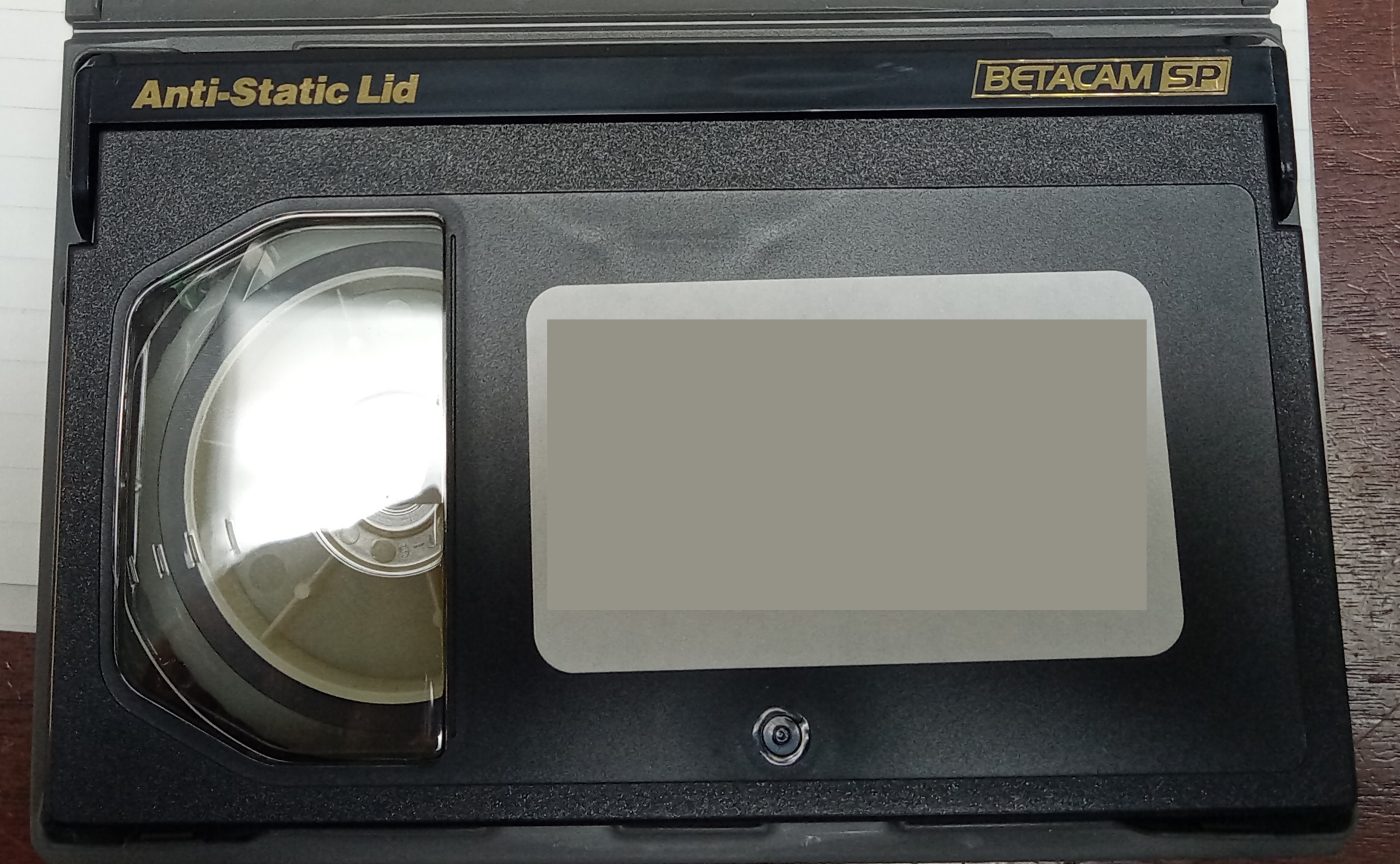

    Maybe a picture of the front of one of these 'Betamax' tapes would clear the suspicion from a fair comment by dellsam34

    Here is one of the tapes - Image
    [Attachment 67295 - Click to enlarge]

    Bingo !!
    Read what is written top right.
    So unless these tapes were recorded in a Betamax vcr, they will NEVER play in one.

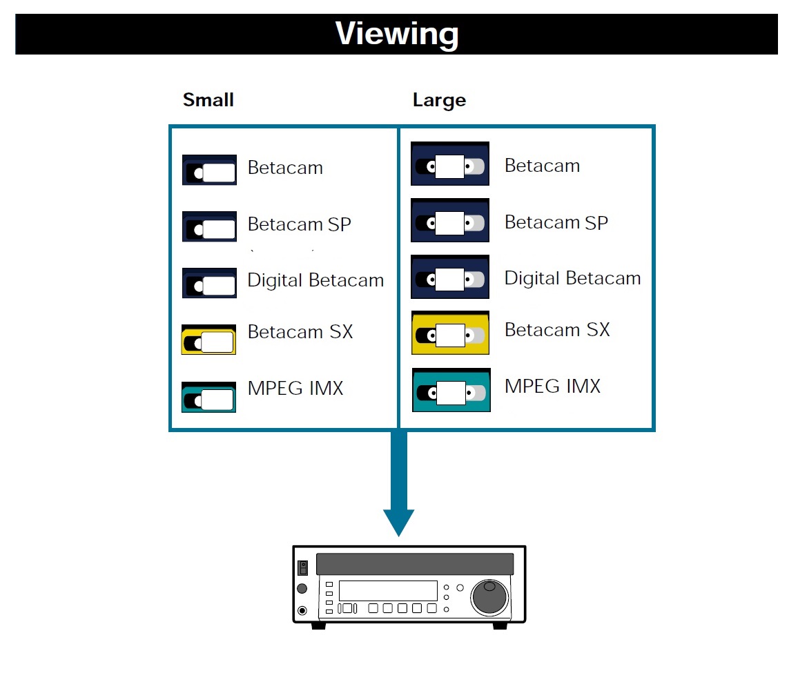

    Just send the poor guy to me, I'll give him a good price, I have a very nice Sony pro deck with SDI out. Unless you want to invest in a Betacam player deck, they are usually around $1,500, The big boys go for $3,000 but those are recorders.

    Even then, are all the tapes Betacam SP since if I read correctly acquiring the origanal Betacam player they still would not play.
    But, I concur. Acquiring a deck just for one project with no guarantee of future business is not really cost-effective. And most of the decks I see for sale on Fleabay are 'Parts only'. And one other thing. Even getting lucky in getting a working 'bargain' would consumer-grade capture equipment work ?
    A sad case of not researching your job before taking it on.

    There are Betacam Players that playback all the Betacam SD formats analog and digital, small and large like the Sony J3-SDI or J30-SDI, But they are no longer cheap. I don't know what happens in the last few years, when I acquired my gear everything was under $300.

    I like the look of that if it can playback all Betacam recordings, but can it playback Betamax tapes, as well.
    Has a player with that capability to play all Beta tapes been made, or can it be made? I just want to know if we go further into this, are we going to be buying multiple players because of the tape differences? I know there are VCR players with DVD recorders. I consider those "cheap", but it's an option.
