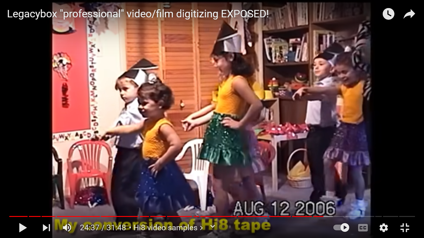

  5. The Legacybox film transfers shown in that YouTube video were awful.
    As for the 8mm video shown later in that clip, here are links to more-or-less the same frame, captured from my screen while watching the video, comparing the Legacybox transfer to the transfer the person did himself:
    Legacybox Transfer
    DIY Transfer
    Since I think I was one frame off in what I captured from each video, and since I have no idea whether there was any difference in processing done by YouTube with each of the uploads, I can't make too many conclusions. The DIY video capture is better, but not massively so (unlike the Legacybox film capture which was truly awful). I don't understand why the frame rate from Legacybox was anything other than 29.97, so that is disturbing.
    My conclusion at this point is that the difference shown in the YouTube video would not be enough for me to do the whole darn project all over again, especially since the next transfer company might have its own set of problems. Other national transfer companies like YesVideo (via Costco, Walmart, etc.) and ScanCafe might not be any better, and finding a local transfer company that is good will have its own set of problems. And, of course, doing a DIY transfer is something most people are not interested in doing, which is why they send their stuff to these companies in the first place.
