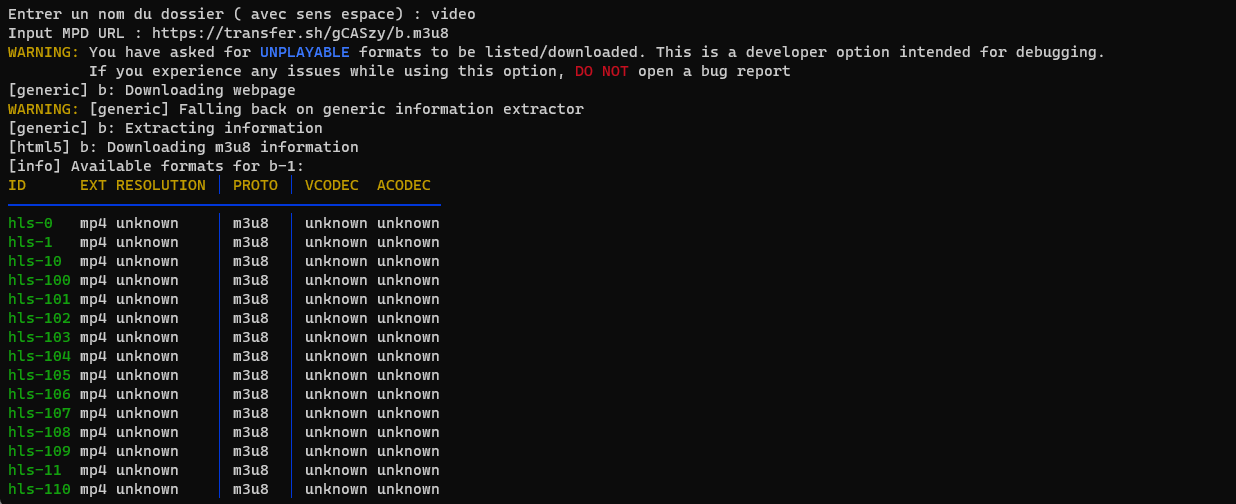

[Attachment 67228 - Click to enlarge] -
you can try this with:
here is a picture:Code:yt-dlp --allow-unplayable-formats -F "https://transfer.sh/gCASzy/b.m3u8"

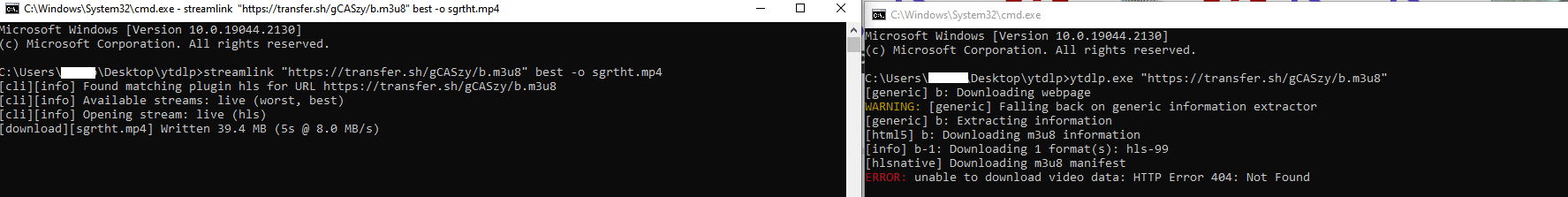

[Attachment 67230 - Click to enlarge] -
(For whatever reason, both streamlink and yt-dlp on my system can't handle transfer.sh's LE certificate. EDIT: Oh, duh, they don't read Windows' certificate store and wouldn't see Fiddler's cert.)Code:
C:\Users\me>yt-dlp --no-check-certificate --add-header "Accept:*/*" "https://transfer.sh/gCASzy/b.m3u8" [generic] b: Downloading webpage [generic] b: Downloading m3u8 information [info] b: Downloading 1 format(s): 0 [hlsnative] Downloading m3u8 manifest [hlsnative] Total fragments: 1202 [download] Destination: b [b].mp4 [download] 0.2% of ~ 1.67GiB at 933.80KiB/s ETA 28:01 (frag 2/1202) ERROR: Interrupted by user
My guess is it's to do with the host you've put the file on. I hooked up Fiddler to both streamlink and yt-dlp and noticed the latter tries a bit harder to pretend to be a browser and sends "Accept: text/html,application/xhtml+xml,application/xml;q=0.9,*/*;q=0.8" and transfer.sh responds by sending it the webpage you would get in a browser if viewing the link. With "Accept:*/*" (or the lack of that header entirely) I assume transfer.sh assumes it's being used by cURL or something and sends the file directly. A perusal of the transfer.sh server code might confirm this or not.Last edited by AbortRetryFail; 15th Oct 2022 at 15:48.

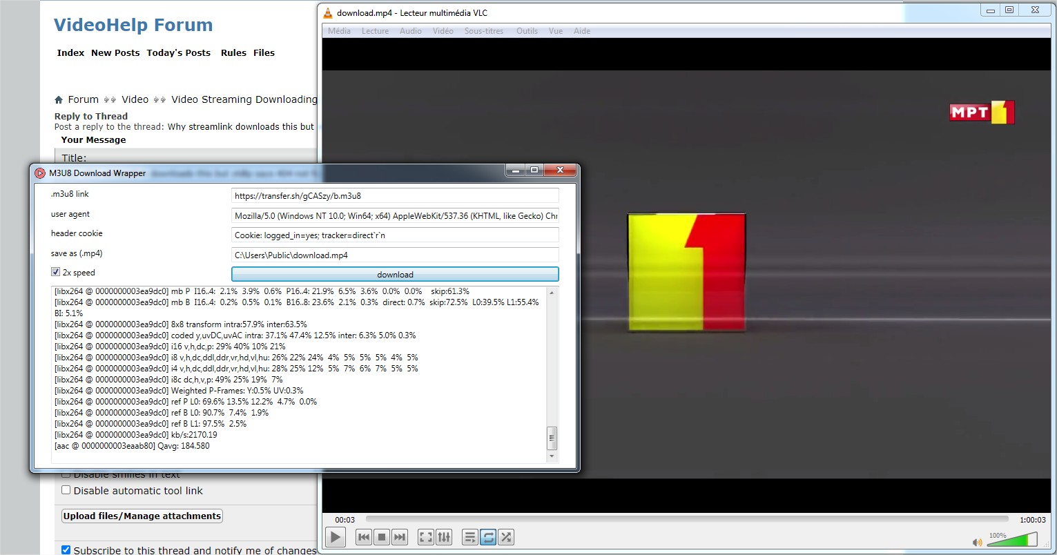

[Attachment 67232 - Click to enlarge]
bro use this tool
