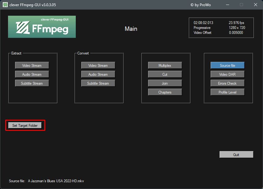

    The first time you launched clever FFmpeg-GUI, you had to specify a destination folder. This is where the edited videos are located.
    If you click on set target folder like in the picture, the target folder will be displayed.
    [Attachment 67219 - Click to enlarge]
    If you follow the instructions from post 2, you will see a picture like this:
    [Attachment 67220 - Click to enlarge]

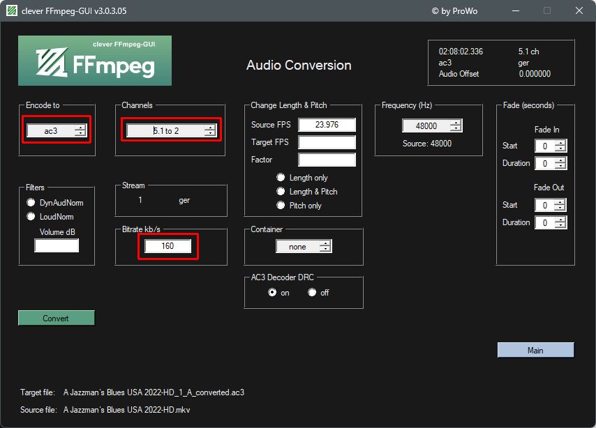

    Audio conversion from DTS to ac3:
    Select here (as in the picture) ac3 as codec.
    If channels
    it says 5.1, then select 5.1 to 2 (as in the picture),
    if it says 2 (stereo), then leave it as it is,
    if it says something else, then select 2 (stereo).
    Bitrate should say 160.
    Leave all other settings as they are and click convert.
    Then continue multiplexing as described in post 2.
    After that you will find a new file with _muxed.mkv extension in the target folder.
    Copy it to your USB stick and test it on your TV.
