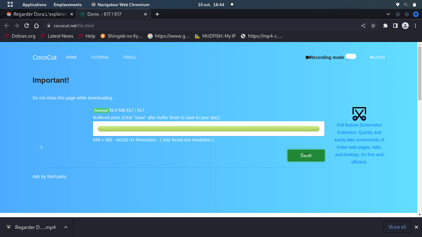

Video Downloader Cococut For Chrome do the job.
[Attachment 67169 - Click to enlarge] -
hello cédric8528, it's limited to 19 times as a download. Is there any other way to download without limit?

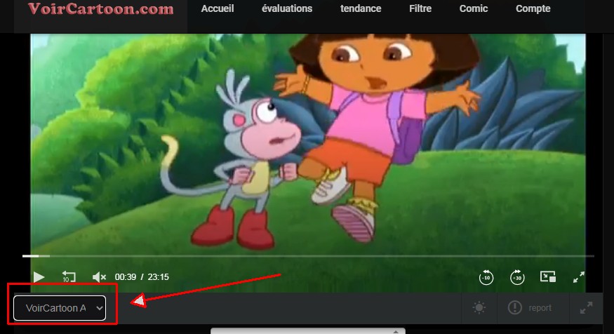

LZAA the link is on first post
https://voircartoon.com/episode/dora-lexploratrice-saison-2-vf-episode-1/?server=openload

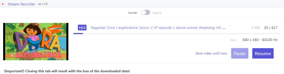

anyway download work with Stream Recorder - download HLS as MP4 ext from VoirCartoon A server
[Attachment 67191 - Click to enlarge]
[Attachment 67192 - Click to enlarge]Last edited by lomero; 11th Oct 2022 at 08:33.
There is only limits on "recording Mode"....If you choose "Force Download" it works.

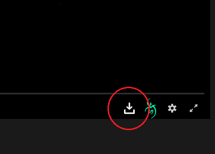

I would like to know how to have script to download on a hydrax server?
see picture:
[Attachment 67237 - Click to enlarge]
hydrax server video url: https://voircartoon.com/episode/go-diego-go-saison-4-vf-episode-3/?server=openload
Can you help me how to upload to Hydrax server. thank you in advance
