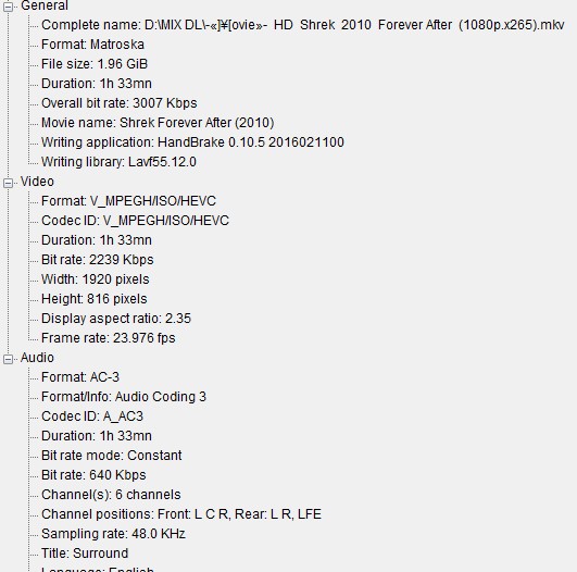

Name:	Screenshot 2022-10-09 090936.jpg

  4. You are mixing up stuff.
    x264 is an encoder for H.264 aka. MPEG-4 AVC
    x265 is an encoder for H.265 aka. MPEG-4 HEVC
    You only get Encoding Settings:
    • for H.264 if x264 was used as video encoder
    • for H.265 if x265 was used as video encoder
    The info of that file shows that it's MPEG-4 HEVC.
    Cu Selur
  5. Either way, h.265 and x265 will not play on the Micca. I need to know if a movie is x264 so I can play it.
  6. Okay, you didn't get that.
    A movie can't be x264, the MPEG-4 AVC aka. H.264 video stream can be encoded with x264.
    If MediaInfo reports the video as MPEG-4 AVC you are probably alright, since your Micca Media Player supports H.264 aka AVC not x264.

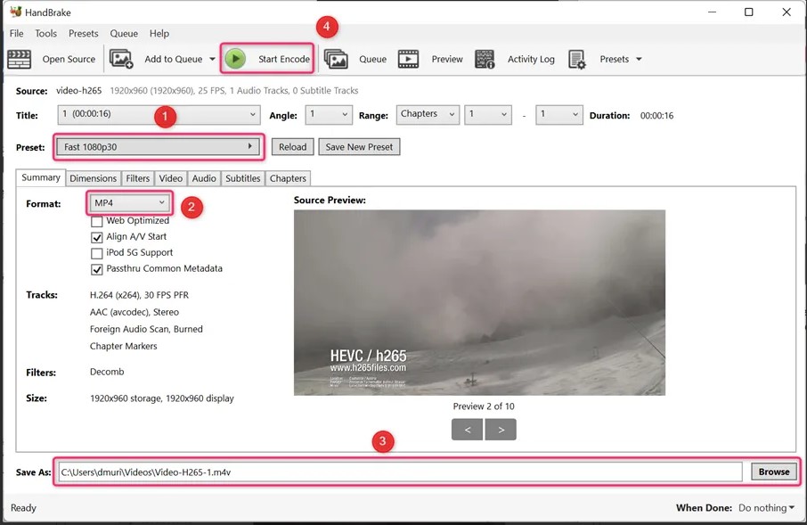

    I get my .mkv movies from other people, I don't rip them myself. They're usually around 2Gb. Some are 720p and others are 1080p when I get them. When only 265 is available and I want to convert to 264, I use Handbrake. This is the example that's on the handbrake instruction page and it's exactly what I do but it enlarges it a lot even though I leave the 720p and 1080p as is. Do you know what setting I'd have to change to get a smaller movie?
