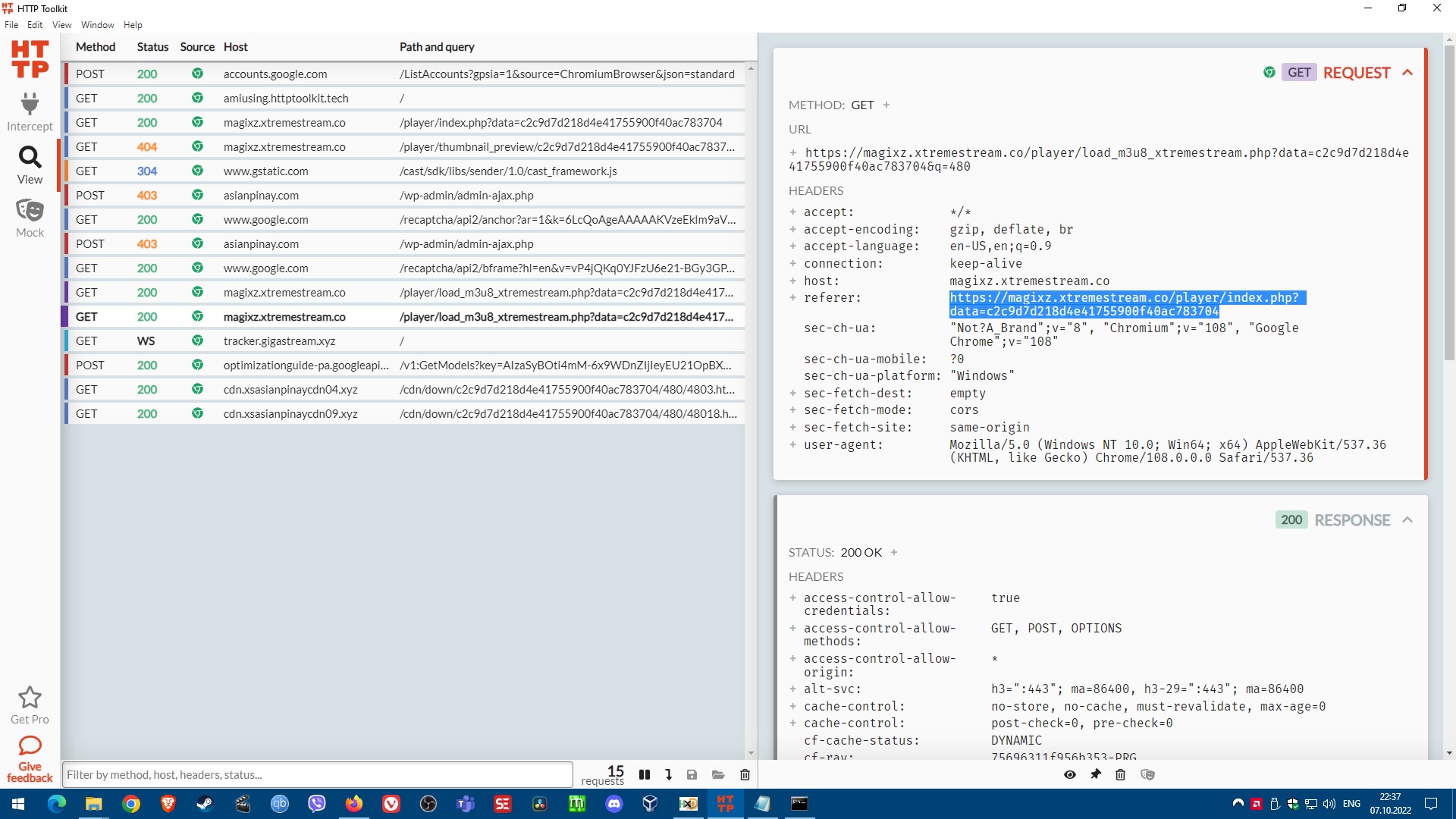

    You need to intercept traffic, for example with HTTP Toolkit.
    By analyzing the traffic, you will stumble upon an m3u8.
    [Attachment 67129 - Click to enlarge]
    You get the referer, you get the link, and feed those to ytdlp
    ytdlp.exe --add-header "referer: https://magixz.xtremestream.co/player/index.php?data=c2c9d7d218d4e41755900f40ac783704" "https://magixz.xtremestream.co/player/load_m3u8_xtremestream.php?data=c2c9d7d218d4e41755900f40ac783704&q=480"

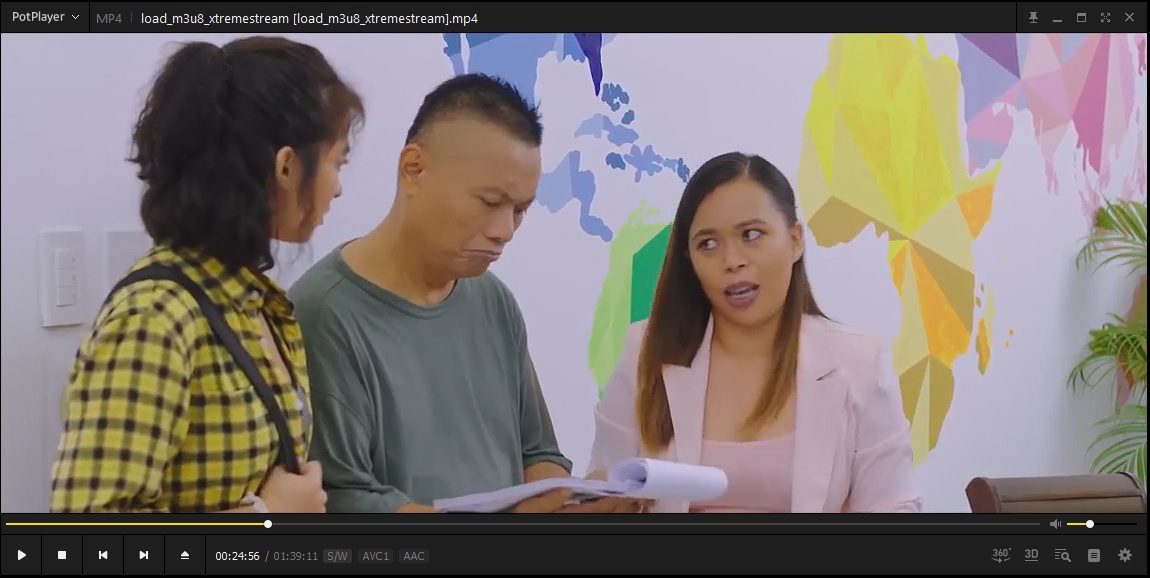

    ...aaand boom!
    [Attachment 67130 - Click to enlarge]
    click click2

  3. Originally Posted by [ss]vegeta View Post
    Originally Posted by Angel_Cyclops View Post
    For future ref, how?
    ...aaand boom!

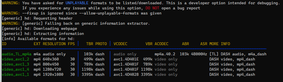

    Just use this mpd instead directly from vivamax:
    https://d1qfpvemzhsbpm.cloudfront.net/video/T97608_FF_LM_SHOOT SHOOT/dash/hd.mpd
    I'll pm you the key. If you don't know how to decrypt manually, just search here for the tutorials
    YDLP Command:
    ydlp --allow-u "https://d1qfpvemzhsbpm.cloudfront.net/video/T97608_FF_LM_SHOOT%20SHOOT/dash/hd.mpd"
    [Attachment 67136 - Click to enlarge]

    MPD will work as shown in the screenshot above without any other required arguments.
