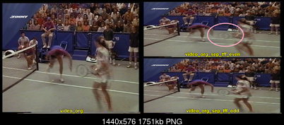

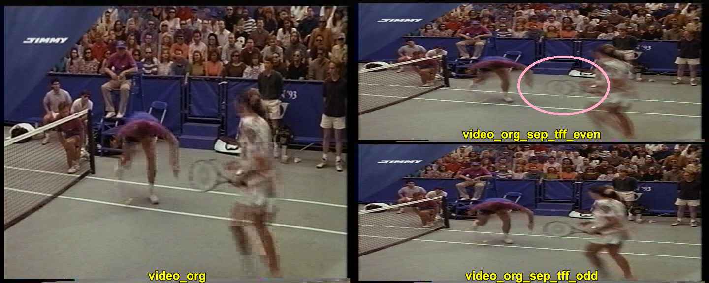

    I have an analog capture where the frame and field patterns is weird: a mixed of interlaced frames and progressive frames that I know how to manage, but then blends at (even) field level.
    Any idea how to deal with the last?

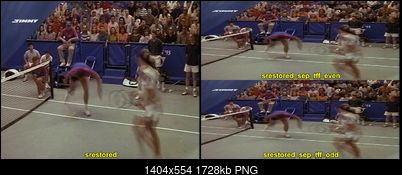

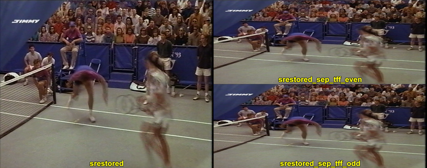

    I get different results than your clip, mine still got ghosting.
    Same for me, using QTGMC v3.364 and srestore v2.797 I still have ghosting.
    Edit: adding images
    my QTGMC+Srestore version, now also odd field has blending

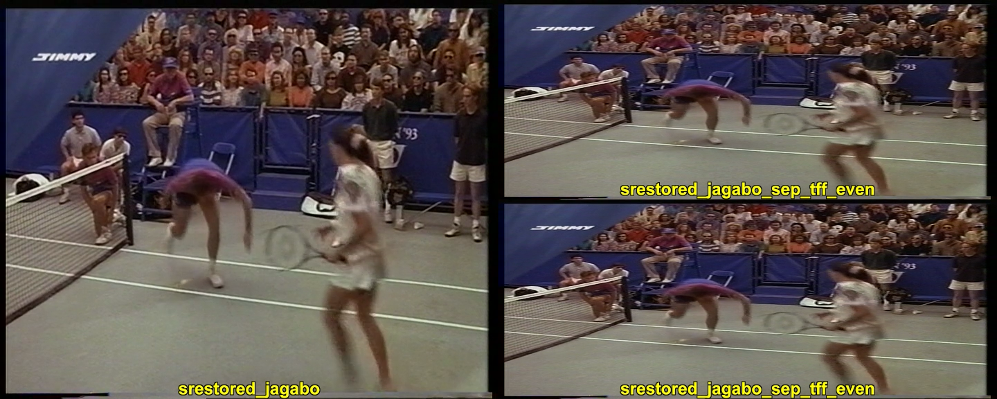

    jagabo QTGMC+Srestore version
  8. I have QTGMC v3.375 and Srestore v2.796. But I tried using the versions Selur uploaded and got the same result as my earlier upload.
    Keep in mind that SRestore may take a while to lock into the clear/blend pattern. If you just seek around in an editor it may not give clean results. Seek about 30 frames back and step forward frame by frame until you get to the frame you want to check.
  9. QTGMC produced 2 or 3 back/forth jerks and few residual ghosts. That's why i suggested yadifmod2 as the bobber, which did solve the issue here. Don't know why yadifmod2 behaved better.
