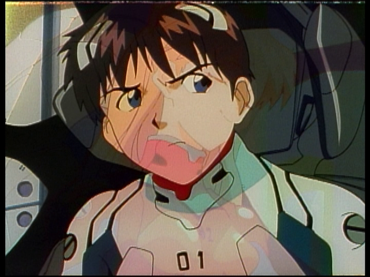

  1. I have an anime source I have been trying to get to come out right. I think it's supposed to be 29.970fps. The Japanese DVD is 29.970fps Progressive, and the Japanese Blu-Ray is also 29.970fps progressive. The DVD's I have in my country appear to be combed or interlaced.
    This appears to have quite a bit of blending in it too.
    I have been using the usual tfm(order=-1, slow=2) that I use for most anime's, but for some reason it comes out kind of jumpy, instead of smooth panning in some places. It looks like it's bouncing along back and forth instead of a single direction glide at certain parts. Most of it appears perfectly fine, but some parts are ruined looking. Playing back the VOB before encoding doesn't have this issue.
    Look at the 5:32 - 5:35 area. It seems to affect that part a lot more than most others. That part comes out terrible for me.
    Does this require some kind of special treatment or pulldown flags? So far I cant figure this source out. I think it may possibly be a hybrid where some is best at 29.970fps and other parts are better at 23.976fps.
    Would someone have a look and share some suggestions please?

  2. This is the results I keep getting with the tfm.
    https://mega.nz/file/IgZHkaDT#EEdQkIkTWbYNs7dCyetZDvzRxILJaXAMOWreUfpbb28
    Look at the 5:32 - 5:35 area. It has a really weird wobble that's not nearly as obvious when the VOB, or disc is played.

  3. QTGMC().SRestore(frate=23.976)
    Though other parts of the video appear to be 29.97p.

  5. You might want to try ExBlend (https://forum.doom9.org/showthread.php?t=175948) for the blend removal,...
    users currently on my ignore list: deadrats, Stears555
  6. If you want 29.97 fps you can SRestore(frate=29.97). Of course, the 23.976 fps segments will be jerky.

  13. Keep in mind that TFM is a field matcher, not a deinterlacer. When there's no matching field it falls back on rather simple deinterlacing. Providing a clip2 helps a bit. So TFM is not appropriate for true interlaced material (camcorder video, live sports, TV news, etc.). My TFMBob functions sometimes work for PAL/NTSC conversions.
    The TFM equivalent of QTGMC's fpsdivisor=2 is simply to call TFM only once with TFM(field=0) or TFM(field=1). The TFMBob filters call TFM twice, once with field=0 and once with field=1, then interleaves the two results.
    For your purposes here you want to use SRestore. It preferentially discards the frames with the most blending. TDecimate preferentially discards duplicate frames (blended frames are not seen as duplicates). And ChangeFPS blindly discards every Nth frame (every other frame when going from 60p to 30p).
