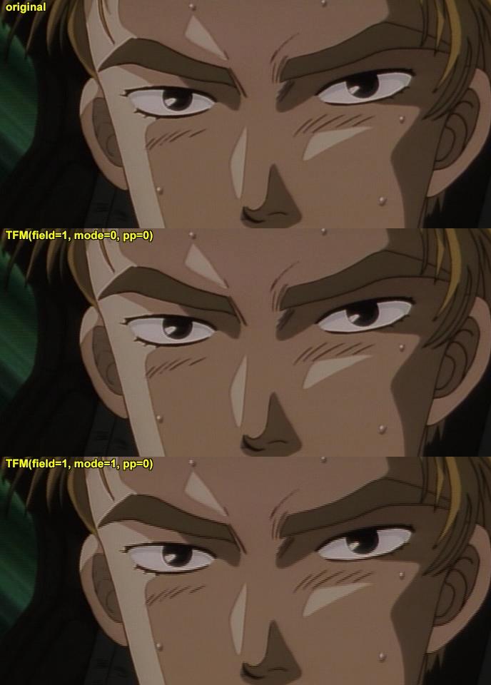

I'm beginning to think that there's a bug in TFM(mode=1, field=1). Consider the following:
Code:Mpeg2Source("VTS_07_1.d2v") Crop(16,16,-16,320) src = last t0 = TFM(field=1, mode=0, pp=0) t1 = TFM(field=1, mode=1, pp=0) StackVertical(src.Subtitle("original"), t0.Subtitle("TFM(field=1, mode=0, pp=0)"), t1.Subtitle("TFM(field=1, mode=1, pp=0)"))
[Attachment 67210 - Click to enlarge]
I used pp=0 so we could see the output of the field matcher without any post processing (deinterlacing).
The original frame has no comb artifacts. Using TFM(field=1, mode=0, pp=0) doesn't change the frame, it doesn't need to. But TFM(field=1, mode=1, pp=0), allowed to look for one more combination, decides that combination is better -- but it's obviously full of comb artifacts. That choice makes no sense. The problem happens several times in that shot. -
