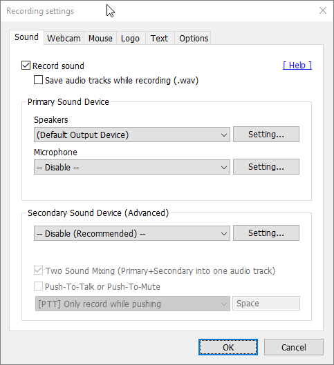

I purchased a Bandicam license and it's a pretty great program if you just want to pull it up and record something without going through the hassle of, for example, setting up an entire OBS session for screen recording.
Bandicam does mouse scrolling, mouse cursor effects, multiple audio inputs, secondary video input e.g. from a webcam, DirectX capture for games, and supports HEVC and NVENC.
EDIT: It also lets you control keyframe interval and supports VFR and VBR (unsure of exactly what type of VBR it uses), and it will let you record to an external codec if you select .AVI recordingLast edited by CursedLemon; 5th Oct 2022 at 10:40.

@CursedLemon
I checked out Bandicam. It did exactly what I needed it to do and it was very easy to use.
The only draw back I saw was the 10 minute limit. It's not a 10 minute limit on each video, but a 10 minutes total before the trial runs out. So you better check out everything you want to check out before that 10 minutes is up. Not knowing that I tested a few function, but didn't test them all before the time was up. I went ahead and rolled the dice though, and picked up the license. Everything works well. I'm happy with software. Glad you suggested it.
