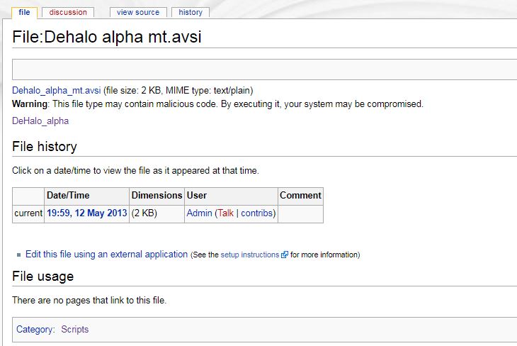

    I was just checking that Dehalo alpha mt.avsi is safe to use as on the Avisynth.nl page it mentioned it may contain malicious code? This was in 2013 but I wasn't sure if it had been corrected? Without the Dehalo alpha the rest of the script run fine. Thanks.
    Mar 2008
    What mentions malicious code? Your anti-virus?

    Thanks davexnet. This is on the Avisynth.nl site. I just was unsure if it's been rectified.

    .avsi is just a plain script. Why don't you download it to your hdd, look at it in notepad and submit it to virustotal?
    Is that pop-up from windows itself? Smartscreen?
    Which web browser, which a/v?

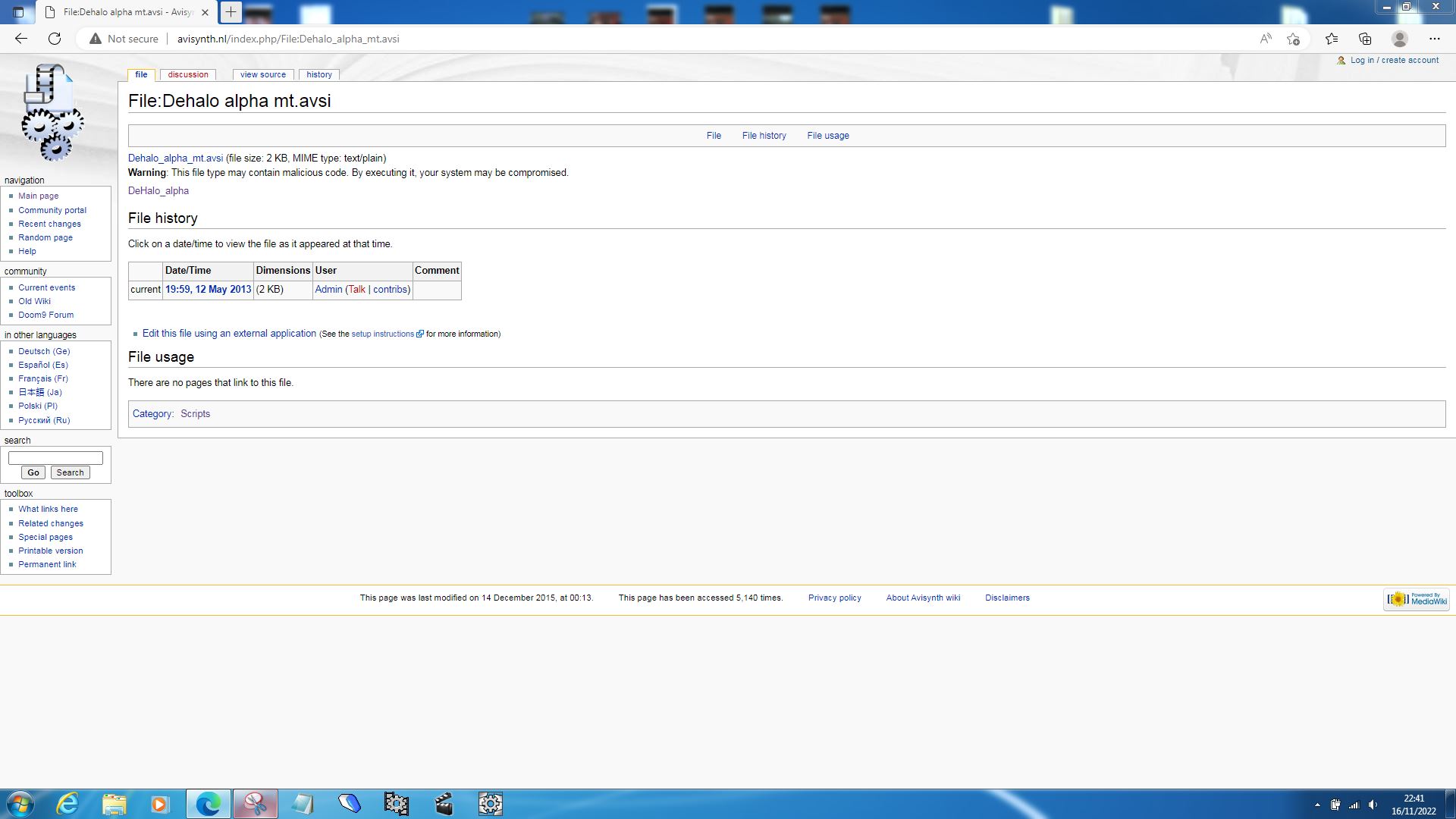

    Thanks davexnet. I just wasn't sure if there was a problem with the script that could cause problems. I've attached the full page.

  6. That's just a CYA message. AVSI files are plain text. That is identical to the file at http://avisynth.nl/index.php/DeHalo_alpha except for the name of the function dehalo_alpha_mt() vs dehalo_alpha(). I have the latter and have been using it for years.
    If you're really paranoid you can check it out at: https://www.virustotal.com/gui/home/upload
    Sep 2021
    Thanks jagabo. I will add it to my plugins. Thank you for the explanation.

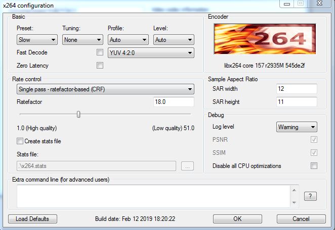

    I'm trying to encode using virtualdub2. If my video is deinterlaced do I have to change any of the settings or the command --tff --weightp=0 as in jagabo's post#22 attachment? As post #22 was intended for interlaced video. Should I then still save mp4 full processing mode.
    I have only used Avidemux when I've previously encoding deinterlaced. Any advice would be grateful. Thanks.
  25. Originally Posted by SkyBlues2021 View Post
    You no longer need those manual adjustments. If your video has been deinterlaced before encoding it is now progressive.

  26. Member
    Sep 2021
    Thanks jagabo. I'm not sure I understand. Do I still keep SAR 12 & 11 and keep CFR at 18.0 but remove the extra command line or do you mean load the defaults and don't configure whatsoever. Probably neither! Sorry for not grasping it.
  27. Originally Posted by SkyBlues2021 View Post
    Yes

    Thanks Sharc. I'm hoping I encoded correctly for deinterlaced video. I used the previous script of jagabo's. Thanks.

  29. The script I gave in post #78 converts back to interlaced video at the end. If you don't need interlaced video remove the last line.
