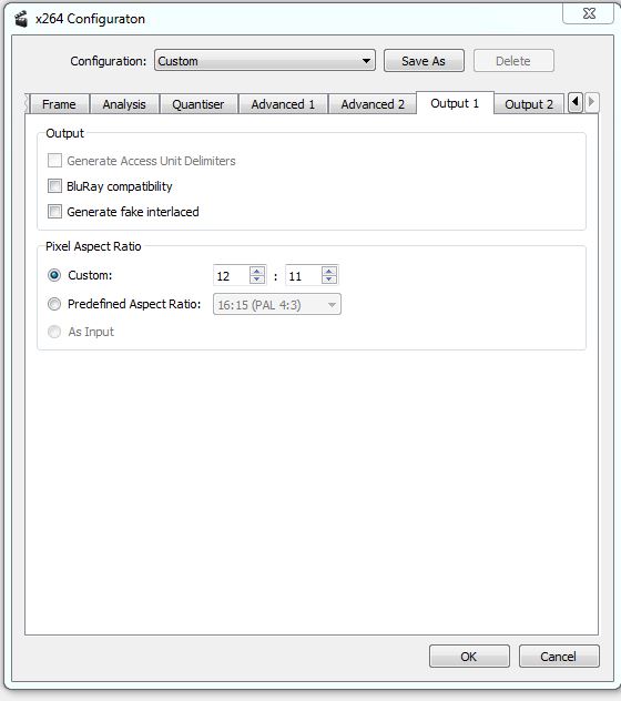

    I only changed the settings Sharc mentioned. Regarding the pixel aspect ratio I selected custom 12:11 as predefined aspect ratio can only do 16:15 (PAL 4:3) I wasn't sure if this was correct? as I couldn't select PAL
    I was able to force aspect ratio 4:3 in MP4 Muxer though
Name:	Avidemux custom output 1.JPG

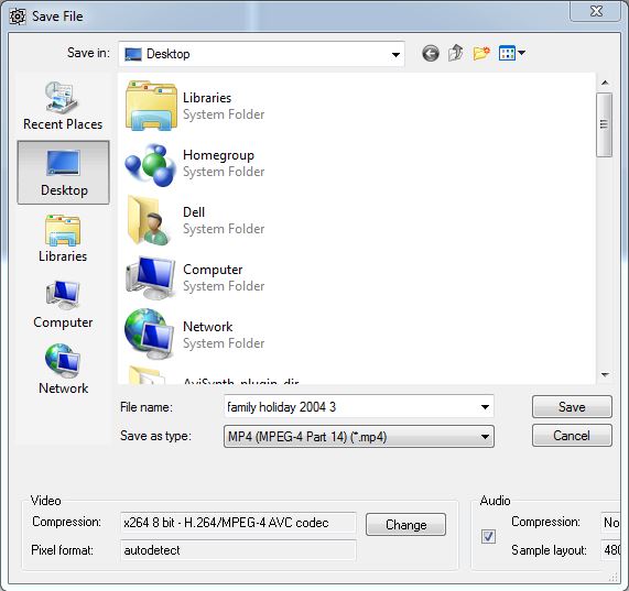

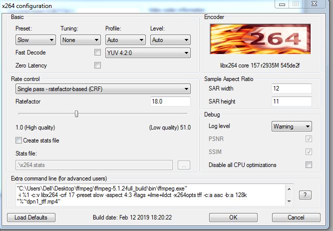

    In the virtualdub2 encoder I copied jagabo's command line into notepad and changed the path to ffmpeg on my system, I then put this into the extra command line box in the x264 configuration page I then selected ok.
    Open video file>family holiday 2004 3
    File> save video> I selected MP4 (mpeg-4 part 14) It only seemed to like full processing mode or normal re-compress. When I went to save it I got this error message. I guessing I've got my ffmpeg path incorrect or selecting MP4 is incorrect? Any advice would be welcome thanks.
Name:	virtualdub2 configure.JPG
Name:	virtualdub2 save as MP4.JPG

  8. Originally Posted by SkyBlues2021 View Post
    Your interlaced encoding is fine. It is correct to set the PixelAspectRatio to 12:11 for your captured 720x576 VHS video. The video stream is then flagged accordingly which means the active picture (excluding the black side bars of your capture) become 4:3 when the player respects this PAR signalling.
    The MP4 muxer in AviDemux however forces the overall frame (including the black side bars) to 4:3 at container level which gives the "infamous" but harmless ~2% difference (plenty of threads discussing this). Nothing to really worry unless one is pedantic....

  10. Originally Posted by SkyBlues2021 View Post
    You misunderstand something here. When using VirtualDub2 the only thing you have to put into the extra command line box is
    --tff --weightp=0
    as per jagabo's instructions in post#22, for interlaced encoding.
    Post#30 is a standalone ffmpeg commandline. You don't need VirtualDub2 for this to run.
    Sep 2021
    Thanks Sharc. Sorry, I'm not sure if I understand. Do you mean to encode with virtdualdub2 all I need to do is put --tff --weightp=0 into the extra command line box then save video>MP4 and it's encoded? or is that just step 1 and step 2 is the ffmpeg command line?
  12. Originally Posted by SkyBlues2021 View Post
    Yes. You don't really even need --weightp=0. If you leave it out x264 will display a warning and automatically set it. Be sure to set the SAR values to get the correct 4:3 display aspect ratio.

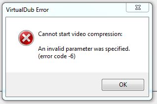

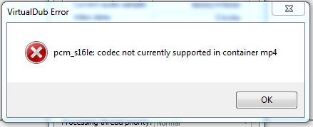

    I've had another go with the virtualdub2 encoder. But I got the following error message. I set both video and audio to full processing mode as a few posts I found said this is an audio error message?
Name:	virtualdub2 error 29-10.JPG
  16. In Vdub2 menu try
    Audio -> Compression ....
    then select FFMpeg AAC
  17. Be sure to enable Audio -> Full Processing Mode or you won't be able to select a codec.
  18. Member
    Sep 2021
    Success! Thanks Sharc & jagabo. I attached the virtualdub2 encoded clip. Do most folk here de-interlace before encoding? or is it better to leave it interlaced.

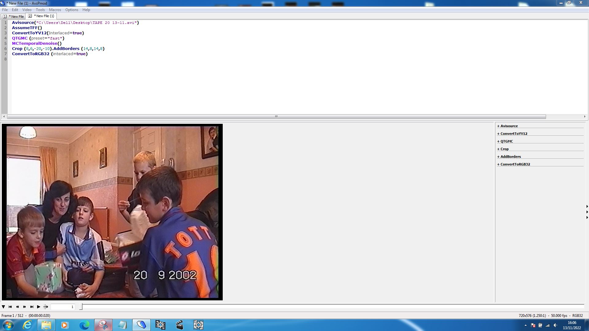

    My tv's deinterlacer isn't the best and still left lines on the football shirts numbers, so I've tried a script but I'm not sure if my QTGMC and MCTemporalDenoise settings are correct? Any advice would be grateful.
    I had to convert the colorspace to YV12 as I get a QTGMC (v 3.32) error message on AvsPmod without the conversion. Is this ok? I thought this version worked with YV12 & YUY2.
Name:	TAPE 20 13-11 Screenshot.JPG
  24. Captures & Restoration lollo's Avatar
    Jul 2018
    Italy
    QTGMC and MCTemporalDenoise have many parameters, you should experiment yourself the best setting for your video, there is not a generic rule
    It's ok, but you can use ConvertToYV16() instead, to avoid chroma subsampling. Even if your TV will not support 4:2:2 color space, but only YV12, better to do it at the end of the whole processing
    ConvertToRGB32(interlaced=true)
    Why do you converto to RGB at the end? And btw, the video before that command is not interlaced anymore
  25. Why are you converting to RGB at the end? And encoding as interlaced? Your video is no longer interlaced after QTGMC, it's progressive at 50 fps.
    Regarding the cropping, I would AddBorders to make the frame 704x576 rather than 720x576. The 4:3 frame is held in a 704x576 portion of an ITU video cap.
    There's no "right" setting for MCTemporalDenoise(). It's a matter of taste.
  26. Member
    Sep 2021
    Thanks lollo & jagabo. Sorry, I don't know why I put in interlaced= true.
    I thought I had to convertToRGB at the end of the script because I had previously done convertToYV12? Am I right in thinking I can leave that line out altogether.
    Also I was sloppy encoding interlaced. I will have another go and take all the advice you have both given me.
    I have tried to ConvertToYV16() but I get an error message. I will post it.
  27. There's no need to convert to RGB at the end. It's a waste of time and a needless loss of precision because you are converting back to YV12 when you encode.
    Try something like:
    AviSource("TAPE 20 13-11.avi")
    AssumeTFF()
    ConvertToYV12(interlaced=true)
    ColorYUV(gain_y=32, off_y=-30, gamma_y=25)
    SeparateFields().vInverse().Weave()
    QTGMC(preset="slow", Sharpness=0.7)#, EZDenoise=1.0, DeNoiseMC=true)
    TurnRight().QTGMC(InputType=2).vInverse().TurnLeft()
    edgemask = mt_edge(mode="prewitt", thy1=150, thy2=150).mt_expand().mt_expand().Blur(1.4).Blur(1.4).Blur(1.4)
    Overlay(last, Dehalo_alpha(rx=4.0, ry=3.0, BrightStr=0.8, DarkStr=0.8), mask=edgemask)
    MergeChroma(last, Spline36Resize(width/2,height).aWarpSharp2(depth=20).Spline36Resize(width,height))
    ChromaShiftSP(x=-2, y=0)
    Crop(8,6,-20,-10).AddBorders(6,8,6,8)
    prefetch(8) # enable multithreading (8 threads) in AviSynth+
    Remove the edgemask and overlay lines if you don't like the halo reduction.
