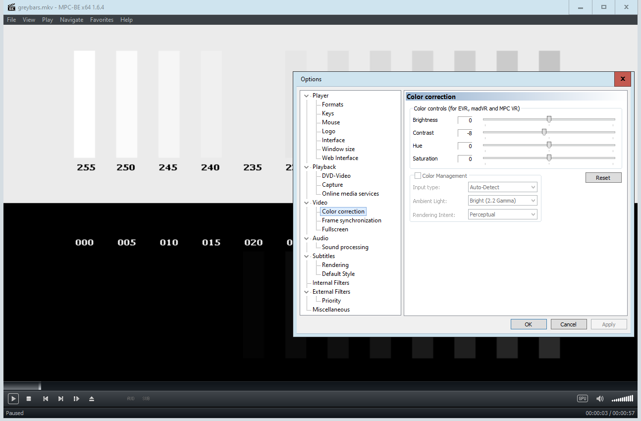

  2. You can turn the proc amp contrast setting down to -8. Keep in mind that everything else you watch will have the white level too low.
    Aug 2018
    Wrocław

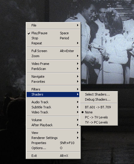

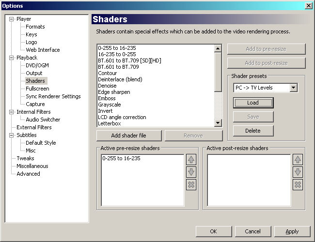

  4. I don't know about MPC-BE, but for MPC-HC those shaders come with the player and you can create presets for them.
    I may have renamed the shaders themselves (I can't remember).
    [Attachment 67233 - Click to enlarge]
    The right click menu.
    [Attachment 67234 - Click to enlarge]

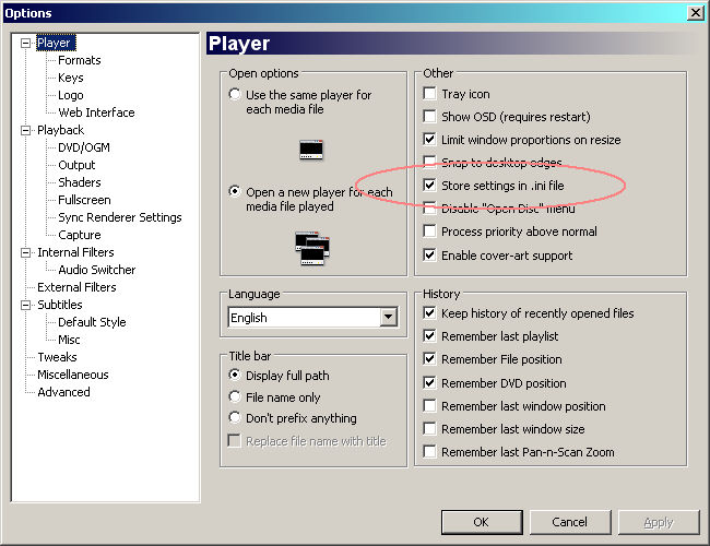

    Don't forget you can use MPC-HC as a portable version in a different folder, or as many times as you like.
    I have it "installed" with the usual file associations and I've put shortcuts to portable versions with different settings in the Windows SendTo folder.
    To make that work you need to make sure MPC-HC is saving it's settings to an ini file and not the the registry (except for one version, if you prefer).
    [Attachment 67235 - Click to enlarge]

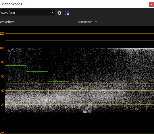

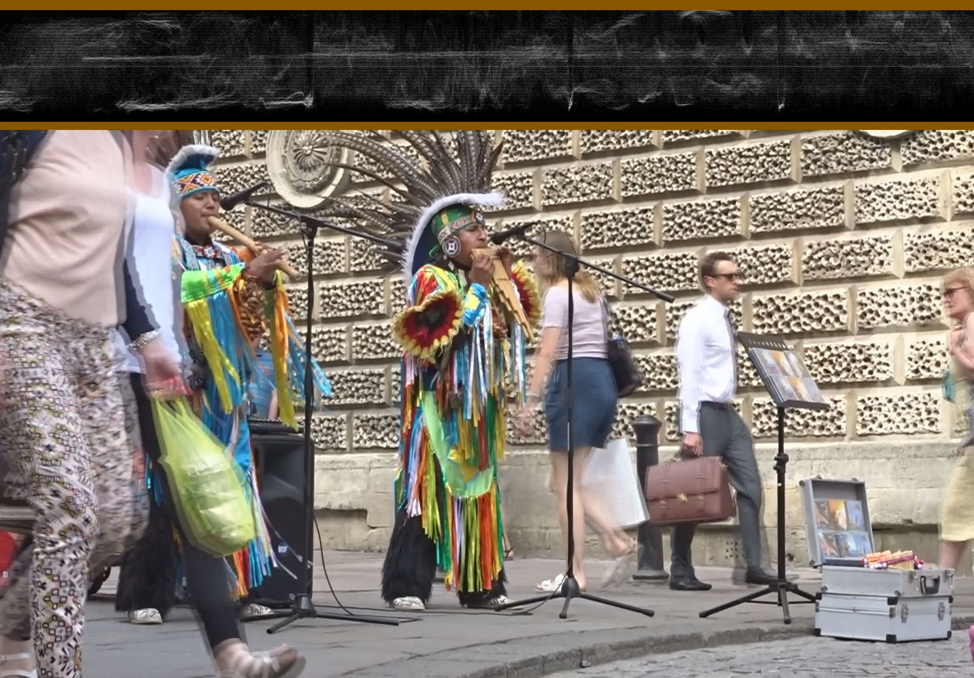

    I downloaded a sample video from a site reviewing the camera, and aside from what appears to be god-awful dynamic contrast, the levels are as you described.
    Original
    [Attachment 67267 - Click to enlarge]
    Reducing the whites to TV range looks better, but there's still clipping. I don't know if this video is typical though.
    Levels(0,1.0,255,0,235, coring=false)
    [Attachment 67268 - Click to enlarge]
    I wonder if a full PC range to TV range conversion should be applied. For this video I think it looks better.
    Levels(0,1.0,255,16,235, coring=false)
    [Attachment 67269 - Click to enlarge]

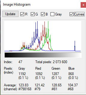

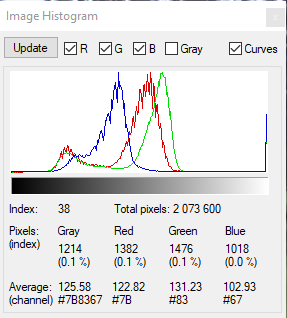

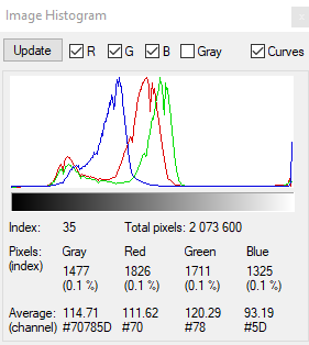

    Unfortunately, it doesn't work as it should.
    File: should-be - This is what it should look like.
    File: filter-on - this is what it looks like after the shader
    File: filter-off - range 16-235 - superbrights (235-255) removed
    Shader installed as DX11 after scaling.
    Image Attached Images
    Aug 2018
    Wrocław
    Histogram:

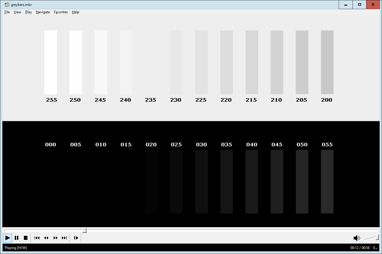

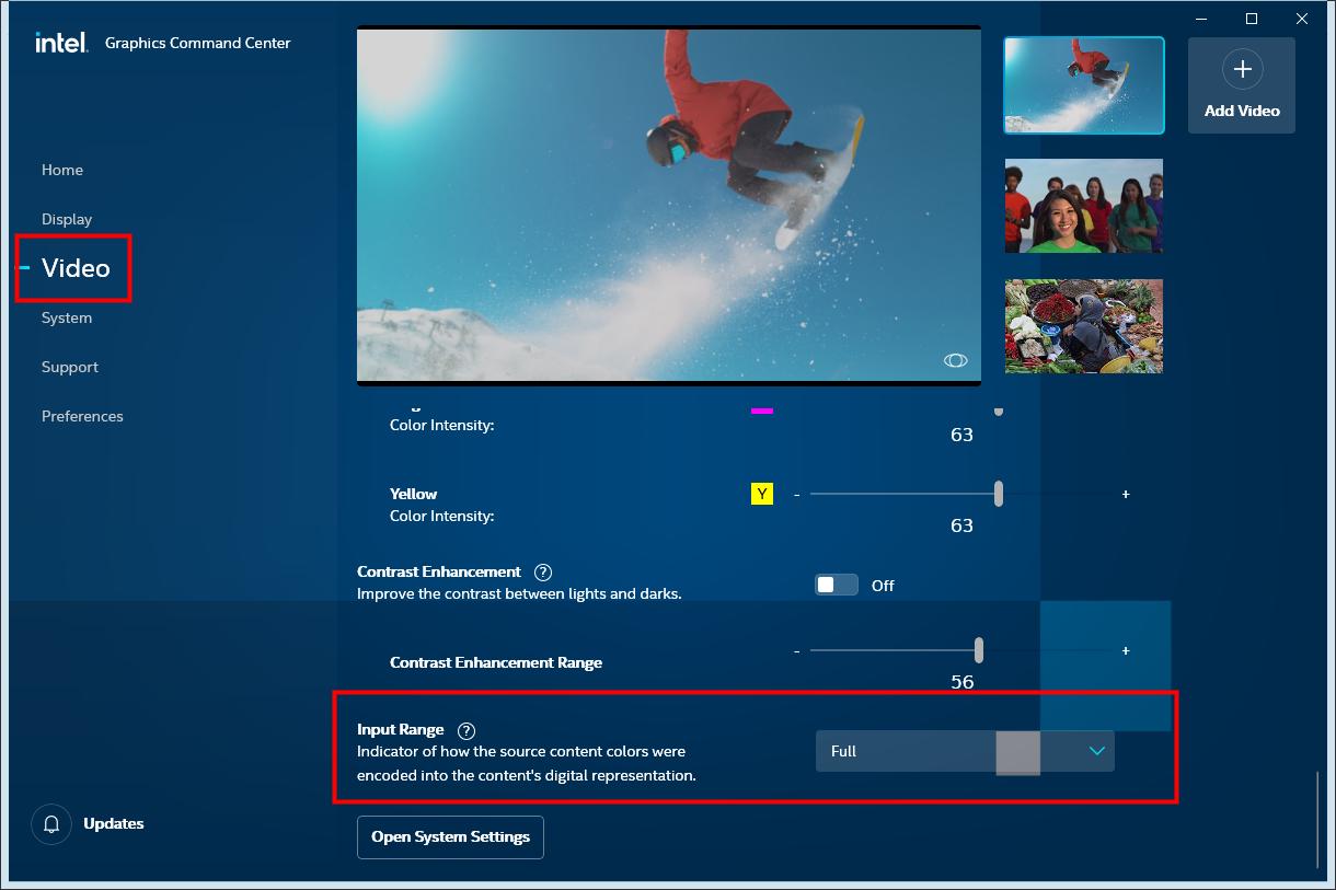

    Unfortunately, not all programs/drivers use the same terminology. Limited, Full, 0-255, 16-235, and they may be referring to the source or the output.
    I'm using the integrated graphics built into my Intel CPU. For its driver he setting is here:
    [Attachment 67572 - Click to enlarge]
    Note there are different controls for the Desktop vs. Video -- I'm changing settings on the video tab here. I normally use the "Limited" setting because virtually all sources are limited range (DVD, BD, streaming services, etc.). I had to change it to the "Full" setting to prevent the levels being changed before the Shader in MPCHC. This may also depend on what output device you are using and whether or not you are using GPU decoding.
    Here's the shader in action:
    [Attachment 67573 - Click to enlarge]
    The numbers in the chart refer to the Y values before being converted to RGB for display. You can see that all values at and below 16 are full black (R=G=B=0). But at the bright end of the scale you can differentiate the bars above Y=235. Actually, the picture at the high end is a little too bright. You may need to adjust the values a bit.

  24. It works for me:
    [Attachment 67627 - Click to enlarge]
    Maybe you need to change some other setting in the program.

    Ah, it works. I was mistakenly changing brightness instead of contrast.
    The image is a bit brighter overall (luma 115* vs 117), but it is enough for viewing.
    Thanks.
    (I changed the contrast to -9 and it's a bit better now - luma 115 vs 114.6).
    * - I made a pattern with the ffmpeg filter curves=master='0.0625/0 1/1'
