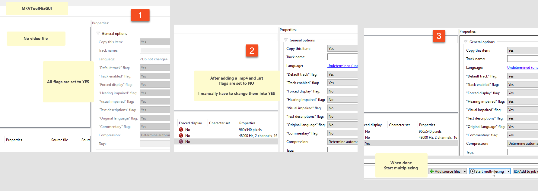

  1. Regularly I am burning in subtitles. This is going fine, but I always need to manually set flags to Yes, each time.
    Now, when I start up MKVToolNix Gui, the flags are set to YES (Greyed out) (1)
    Upon adding a video file, together with the .srt, most flags are set to NO (2)
    I change them to YES and start multiplexing (3)
    Any idea as to how to set them to YES by default when adding a video/srt file?
    Or, maybe this isn't a good idea?
    Thanks !
    [Attachment 67031 - Click to enlarge]

    It's very uncommon to set all flags to yes. May I ask why you'd want to do so?
  3. As said, I want to have the subtitles burned in.
    Normally I would just set "Force Display">Yes only and that works fine. Subtitles show up.
    However, now I have a few video files that do not display the subtitles even with Force Display=Yes.
    Just gave it a try and discovered that the subtitles are indeed displayed when setting all flags to "yes'.
    (I don't know why this is and I am not an expert, the only thing I want is to have them burned in AND displayed)

  8. I am sorry for not responding. The matter was solved and frankly speaking, I forgot about this thread.
    Whilst cleaning up my mailbox I came across an unread email notification.
    I still like to comment.
    This is how I proceed :
    1. launch mkvtoolnix-gui.exe
    2. add source files
    3. select .mkv and .srt files
    4. at pop-up "Add as new source files to the current multiplex settings" [OK]
    4. select the subtitle file, let's say, nl or und
    5. in the right hand panel, default track flag: yes, track enabled: yes, forced display flag: yes
    6. start multiplexing
    a new file is created, "(1)" is added, both source files can be deleted.
    The subtitle is now displayed by default.
    Maybe the term 'burned in' is not entirely correct, but actually this is how I want it.
    As there is no 'separate' .srt anymore, I assumed that the subtitles are burned in then.
    Again, maybe the term isn't correct.
    It works fine.
