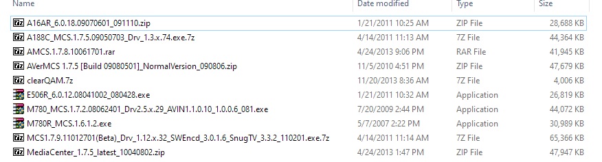

    I used to use the M780. These are the items I still have have, let me know if anything might help.
    Also, take a look in this thread
    https://forum.videohelp.com/threads/341920-Need-Original-Drivers-for-Avermedia-AverTV-HD-DVR-(c027)
