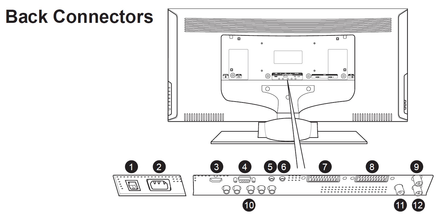

The Nvidia Quadro Fx 5300 card has a DVI port and a VGA port but no HDMI ports. There are 2 ways to connect your computer to your TV for video and one way to connect your PC for sound.
[Attachment 67019 - Click to enlarge]
1, A DVI to HDMI adapter or a DVI to HDMI cable can connect your computer to the TV's HDMI in connection (labeled 3 on the diagram above).
2. A VGA cable can be used to connect your computer's VGA out to the TV's VGA in connection (labeled 4 on the diagram above).
Neither VGA nor DVI can provide audio. You need to use the PC's Audio Line Out to supply audio to the TV. If your PC is already connected to speakers, disconnect them. Connect the green Audio Line Out port on the PC to the TV's Audio In port (labeled 5 on the diagram above). To do that, you need a 3.5MM audio cable with male 3.5 mm connectors on both ends.
Finally, your PC's resolution needs to be set to 1366x768 and its audio out needs to be enabled.Ignore list: hello_hello, tried, TechLord, Snoopy329 -
Did your Axium HD-L32T TV's ever display a good picture when using its HDMI port to connect any other devices that are not PCs (for example, a DVD player with an HDMI port)?
Do you mean that your Sagem Axium HD-L32T TV provides a perfect picture when connected to your PC using VGA? If the answer is yes. then just use VGA to connect the PC to the TV. For audio, use a 3.5MM audio cable with male 3.5 mm connectors on both ends to connect the green Audio Line Out port on the PC to the TV's Audio In port (labeled 5 on the diagram I posted above). VGA is not a terrible choice if you are connecting an older PC to a TV instead of a monitor.Ignore list: hello_hello, tried, TechLord, Snoopy329 -
