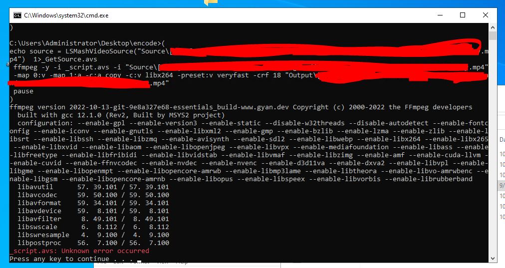

    Hi, finally I'm testing the script but I'm getting this error, do you have any idea why? Please note that I emoved line 5 and 6 because I do not need the logo watermark anymore, I only need to add the intro now
    EDIT: I tried to search online and someone was saying ffmpeg could be the issue. I tried to install an old version (4.0.2) and now I get a different error, don't know if this could help
    [avisynth @ 063e4340] Script error: there is no function named "LSMashVideoSource"
    (_GetSource.avs, line 1)
    (_script.avs, line 1)
    _script.avs: Unknown error occurred
    EDIT 2: used an editor AvsPmod and it tells me the problem is here
    there is no function named LSMASHVideoSource
    . Investigating...

  8. You need to install the LSMASH package for AviSynth: http://avisynth.nl/index.php/LSMASHSource
    Put a copy of LSMASHsource.dll in AviSynth's plugins folder. Be sure to use the right "bitness", the one from the x86 folder for 32 bit AviSynth, and/or the one from the x64 folder for 64 bit for 64 bit AviSynth. And be sure to use put it in the correct plugins folder, plugins for 32 bit AviSynth+, plugins64+ for 64 bit AviSynth+.
  9. I carefully followed your instruction for at least 3 times but with no success, same errors happens
    EDIT: Apparently if I rename _script.avs to _script.avsi it works. I read if it is .avsi the plugins are loaded automatically.
    But now I'm having problem with encoding apparently. A 200 MB file was encoded into 14 MB file. Also I need to press a key to encode the next file, it is not automatic
    EDIT 2: The output files doesn't open
    EDIT 3: I was able to encode the files succesfully by fixing the mmpeg command in the batch. Now I need help to pass to the next file without having to press a key please...
    EDIT 4: I was wrong. The file appears in output folder after the encoding but the intro doesn't appear at the start of the video...

  10. Originally Posted by giggioman00 View Post
    That makes no sense. The batch file uses ffmpeg to open the AVS script. If you rename it to avsi ffmpeg will fail and the batch file will fail to produce any ouput.
    You can specify higher quality for the x264 encoding to get a bigger (higher quality) file (lower crf value). You might also want to specify a higher quality preset like medium, slow, or slower (of course processing will be slower).
    Delete the line that says "pause" from the batch file. I put that in there for debugging purposes (so one could see what was happening for each file).
    My guess is you didn't "fix" the ffmpeg command line properly. With batch processing there tons of little things that can go wrong. The batch and script were meant as general guides, not the final versions you will be using.
    I was just guessing at a lot of things like the size of your videos, the intro, and watermark. If you can't figure it out for yourself, upload a few sample videos, your logo image, and your intro video so I can tune the process.
