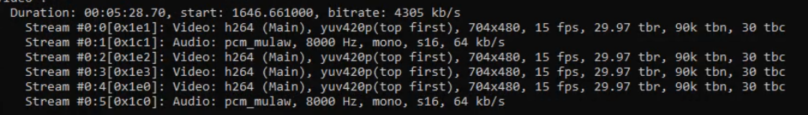

To get the video out, I start with ffmpeg. Here is the data from ffprobe:
[Attachment 66982 - Click to enlarge]
For some reason, ffmpeg/ffprobe do not display the PAR or the DAR as I would like to see.

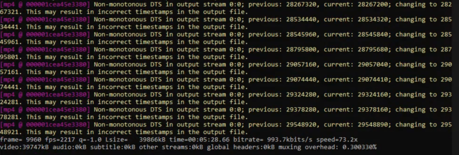

Upon export I get the following warnings:
[Attachment 66983 - Click to enlarge]
What do they mean? Is there any way to access the original timestamps?
Looking at the details of the video, it was exported at 30.30 frames/second. Why not 29.97 fps tbr or 30 fps tbc? When I load the video into Camtasia, the behavior is extremely odd. It will pause and then play, pause and then play, etc. How can I fix this?

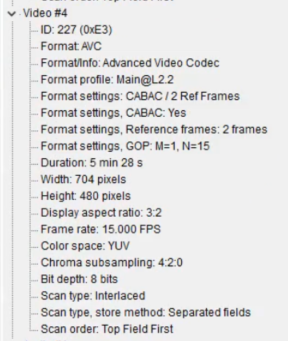

When I look at MediaInfo, it says the display aspect ratio is 3:2. Shouldn't it be 4:3 for standard definition? Further, it says 15 fps. What happened to my 29.97 fps and/or 30 fps of data?

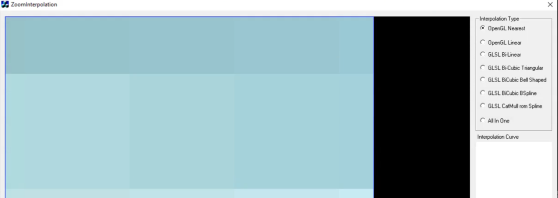

When rendered in a video player, the aspect ratio is 704/480 and things look a little squat. Does this mean it is displaying square pixels? When I capture a still using MPC-HC and open it in Zoominterpolation, I see rectangular pixels with an aspect ratio that appears more geometrically correct. Does Zoominterpolation know that the PAR is 0.909090...? If so, how come I can't see this in any of the data from MediaInfo or ffmpeg? Or is it simply assuming that since I have 704x480 it must have a PAR of 0.9090?
