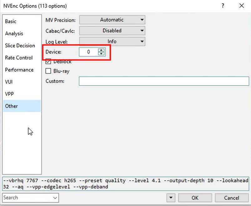

  4. If you're using NVENC I believe the GPU number is Device on the Other tab:
    [Attachment 66977 - Click to enlarge]

  8. The option should take the same form as the others. My guess is the command is "--device N" where N is the number of the GPU.
    These aren't StaxRip options, they are VCEEnc options.
    So i have an idea. Would it be too much trouble for you to go to the settings in your screenshot and select device "1" (instead of 0) and tell me the code that appears for it at the bottom? I could then manually input that in my end and see if it works. Like i said i don't have those setting here so i cant find it my self!

    I don't have Staxrip or a nVidia graphics card so I can't do that. I just found that screen grab somewhere on the internet. In any case, those options are specific to the encoder so the same exact text may not work.
  12. Since there was a portable version of Staxrip I went ahead and downloaded it. On the NVEnc dialog when you select a Device number greater than zero it adds "--device N" to the command line options (where N is the number you selected).
