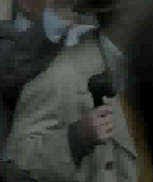

    No matter which Profile & Level option I set in Xmedia Recode the resulting video is coarsely tessellated. The original video resolution is completely destroyed.

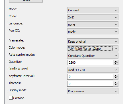

    Attached are images of the setting I used and the results
    Pretty clearly I am doing something wrong.

    Change the Quantizer setting to 2 instead of 2500.
    I'm surprised that it looks that good with those settings.

    Set it up like this. The fourCC can be Divx or xvid, whatever works on your device
    EDIT most of the DVD/mpeg-4 (xvid/divx) players from 15 years ago could only play files with a maximum width
    of 720 (with height adjusted to maintain the aspect ratio)
