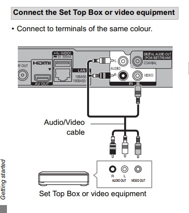

    The device you are looking for, does not exist, even when, it would not have any analog video input (so...you will not find "any" standalone BluRay recorder)
    The Panasonic DMR-BWT460GN Bluray recorder has Composite In:
    [Attachment 67299 - Click to enlarge]
    How it works, I don't know.

    Do you own one ? Is it still for sale ? you know where you can buy one ? would be expensive if available, overkill for VHS, you should look into the manual of the website, it has some limitations … only recording to bluRay from HDD… is one of them.
    You can do better with other options than with this Dinosaur…

    I was simply answering the OP's question, EJ. And yes, they are still on sale.
