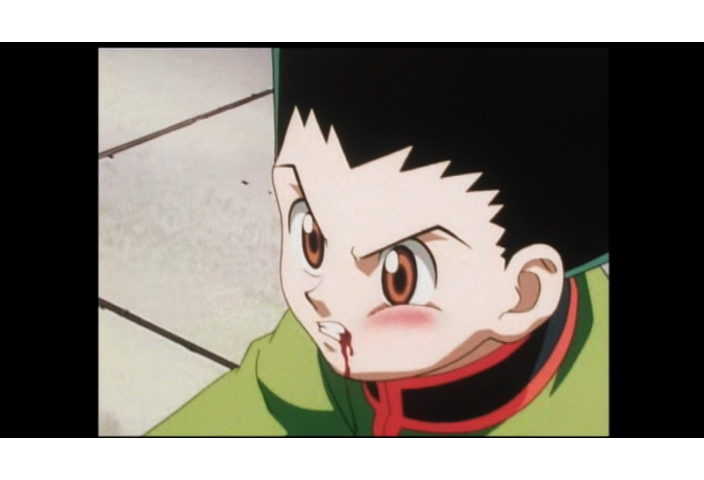

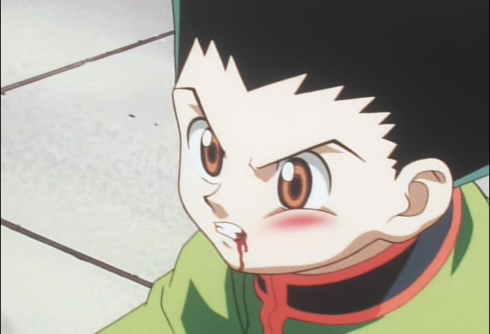

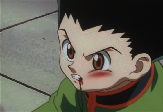

    When I say "washed out" and "bleached" I'm referring to the quality of the Japanese DVD causing the entire thing to be incredibly bright, and for his skin to share nearly the same sat, lum and hue values as the eyes and ring behind him, and it looks especially bad after white balance. This makes any adjustments to his skin cause intense issues to the rest of the image. Here are a couple mockups I did in a few seconds using a similar method for both, the French DVD in particularly bright scenes like this is much more workable than the Japanese DVD. If the blending is unfixable that's a shame, though this DVD is only needed for a few scenes. If necessary we do have the manpower to go frame by frame through these scenes.

  6. Is "French 2.png" the desired end "look" , from starting point "oh no.png" ?
    As long as "bright" mean no clipping in a given channel, it's 10x easier to adjust the colors than to fix the blends. You could do this in Resolve, or get 95% of the way there with just various automatic color matching plugins then fine tuning
