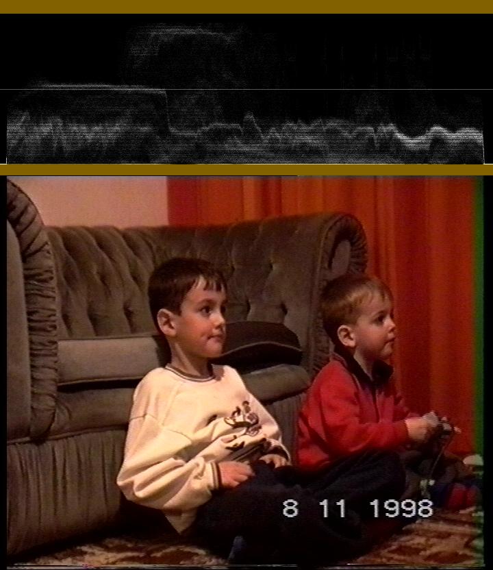

    Thanks jagabo. I've adjusted the levels on my proc amp today. I've tried to add contrast and lower the brightness. I've checked the clips on the waveform, some are closer to the brown bar so they still might need tweaking somewhat. But overall I thought they are an improvement. Any feedback would be welcome.
  2. That's a little too low:
    [Attachment 66925 - Click to enlarge]
    There are some darks crushed at Y=16. Raising the black level a little should restore a little detail in the dark areas.
    Sep 2021
    Thanks jagabo. I thought that one had the worse waveform.
    Clip 22-9 30 & Clip 22-9 31 an indoor & outdoor clip have the same setting so I'm hoping for this tape this would be an acceptable capture level?
  4. 22-09 31 looks pretty good to me.

  6. Some of the darkest shades are being crushed in 22-09 31. Although that particular shot looks ok there may be other shots where the loss of the darkest shades may be a problem. I'd consider moving the black level up a bit for capture. Or at least check to be sure.

    Here is indoor and outdoor clip after adjusting the levels to suit both clips. Hopefully these are better. Thanks.
  9. That looks like good compromise settings to get the most out of the source.
