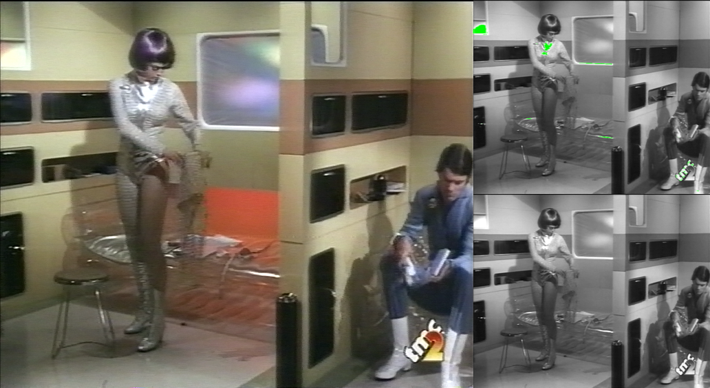

    Thanks Sharc. Sorry I didn't see your added improved clip. It looks like you've removed a mist from the video. Very impressive. What filters did you use to get that improvement?
  2. The main problem with your "mist" is a black level that's too high.
  3. Originally Posted by SkyBlues2021 View Post
    Yes, as jagabo wrote, the milky look of your capture is due to a too high black level. All your clips seem to suffer from this, probably because you capture over-cautiously, ensuring that everything is within the 16....235 luma range, i.e. including under- and overshooting artefacts and noise.
    Anyway, it can be easily fixed in post processing:
    Avisynth:
    SmoothLevels(input_low=36, gamma=1.0, input_high=215, output_low=16, output_high=235, HQ=true, TVrange=True, Limiter=0) #decrease the dark levels and increase the brights somewhat
    SMDegrain(interlaced=true) #for denoising (or use some other interlace-aware denoiser of your choice)

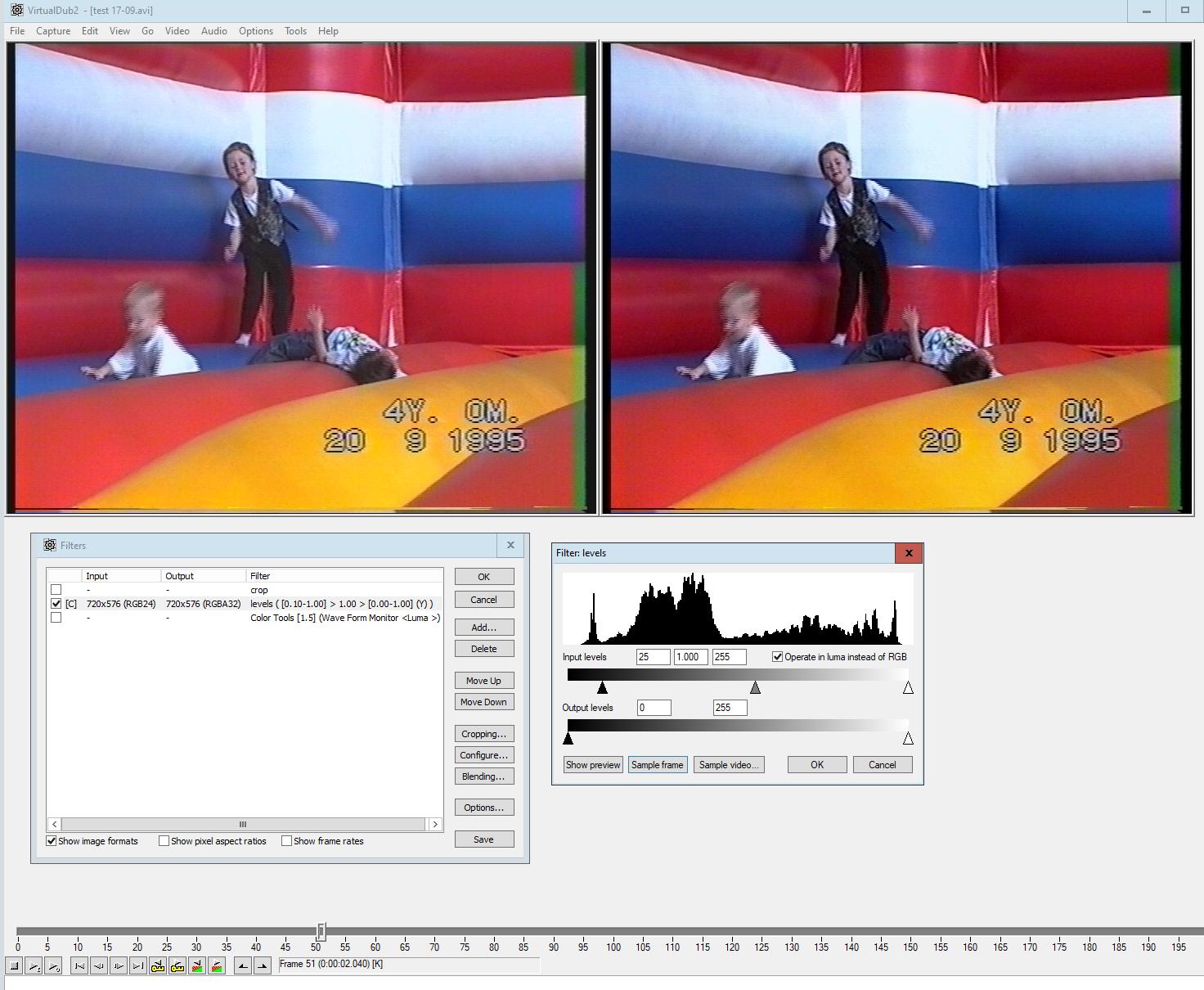

    VirtualDub:
    Video->Filters-> Levels .... pick the levels filter. Settings see attachment.
    You may then want to denoise it as well using one of the VirtualDub's denoisers
    (You can also use filters for brightness/contrast/saturation and achieve the same/similar result as with the levels filters).

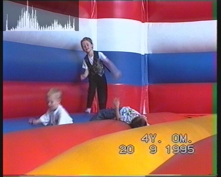

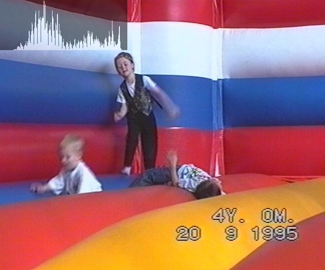

  4. Histograms often aren't very good for setting levels. The problem is that you don't know what parts of the picture correspond to the levels:
    [Attachment 66872 - Click to enlarge]
    You can see that big peak near the left of the histogram. But if you crop away the black borders before getting the histogram:
    [Attachment 66873 - Click to enlarge]
    You can now see that it was those black borders that caused that peak. There's nothing very dark in the part of the picture you care about.

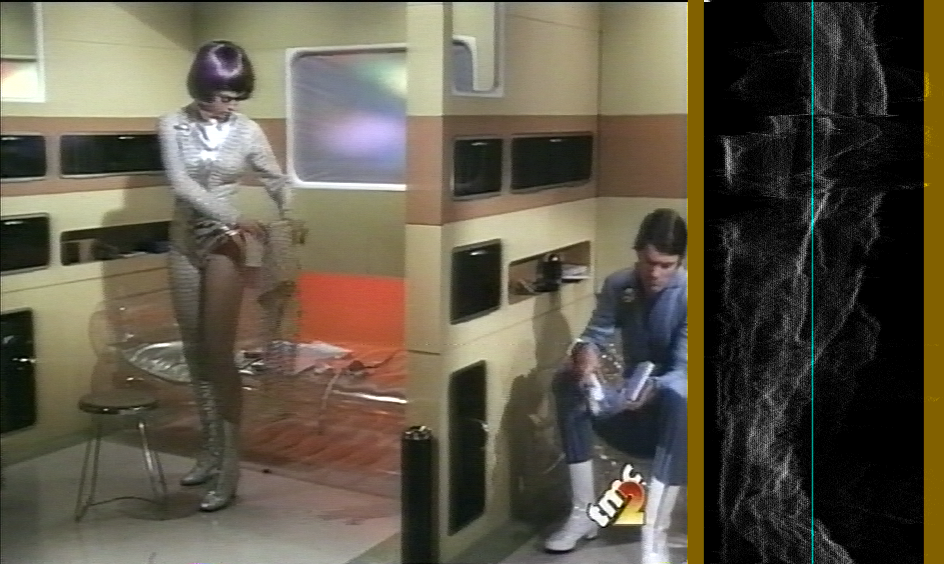

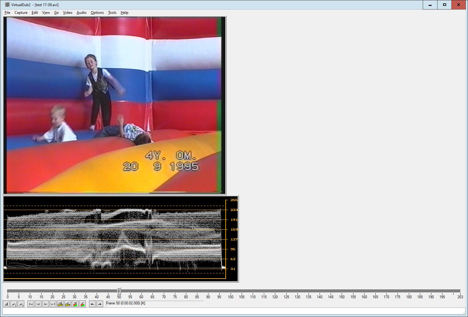

    A Waveform monitor is better for this type of analysis:
    [Attachment 66874 - Click to enlarge]
    That's the luma waveform from the Color Tools filter in VirtualDub. If you don't know how to read a waveform this might help:
    https://forum.videohelp.com/threads/340804-colorspace-conversation-elaboration#post2121568
    Basically, the waveform graph transforms the brightness of the pixels to a height on the graph. With a horizontal graph like this the graph is an overlay of the brightness of all the pixels above that part of the graph. You can see that the darkest parts of the picture are, for the most part, at the left and right edges. Closer to the middle are the boy's black pants. But the are nowhere near the desired black level. That could be because they aren't fully black under the lighting conditions, or because the black level is too high. It's up to you to decide where you want the black level to be. Here I've moved the black level down to just above that dark peak at the left is crushed (all 0).
    [Attachment 66875 - Click to enlarge]

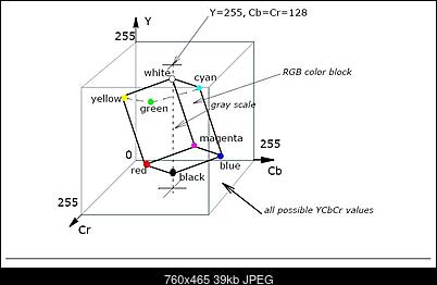

    I hesitate to mention this but even within those limits (Y = 16 to 235, U and V = 16 to 240) most YUV combinations lead to illegal RGB values. YUV is a rotation and scaling of the RGB value:
    https://www.intel.com/content/www/us/en/develop/documentation/ipp-dev-reference/top/vo...-models_FIG6-5
    The inner cube is all 16 million 8-bit per channel RGB triads. The outer cube is all 16 million 8-bit YUV triads. Only about 1/6 of all YUV combinations lead to valid RGB values. Even within the limited range only about 1/4 of the YUV combinations lead to valid RGB values.
    If you're a real stickler for valid values you need to do a lot more than check for Y=16 to 235, and UV=16-240. One quick dirty method is to convert the YUV image to RGB then back to YUV. Any YUV triads outside the RGB cube will have their RGB values clamped within the valid RGB range. Then on conversion back to YUV the values will be different than the original YUV image. I created a filter long ago that highlights bad YUV values using only built in AviSynth filters:
    https://forum.videohelp.com/threads/360935-Capturing-Correct-Chroma-and-Hue-Levels-Fro...e2#post2289672
    Also in that thread are some other methods. Notable are some that use Gavino's more accurate (but much slower) method.

  18. I brought up the YUV/RGB details just for a little more completeness. I didn't mean one should worry too much about it while capturing.
    I only looked a a couple of the latest caps but the black level is still to high, and the white level too low.
    Sep 2021
    Thanks jagabo. I do think these captures look better and less washed out than my previous captures. How would I combat the high black level and low white level with the internal proc amp? I'm guessing less brightness and less contrast?

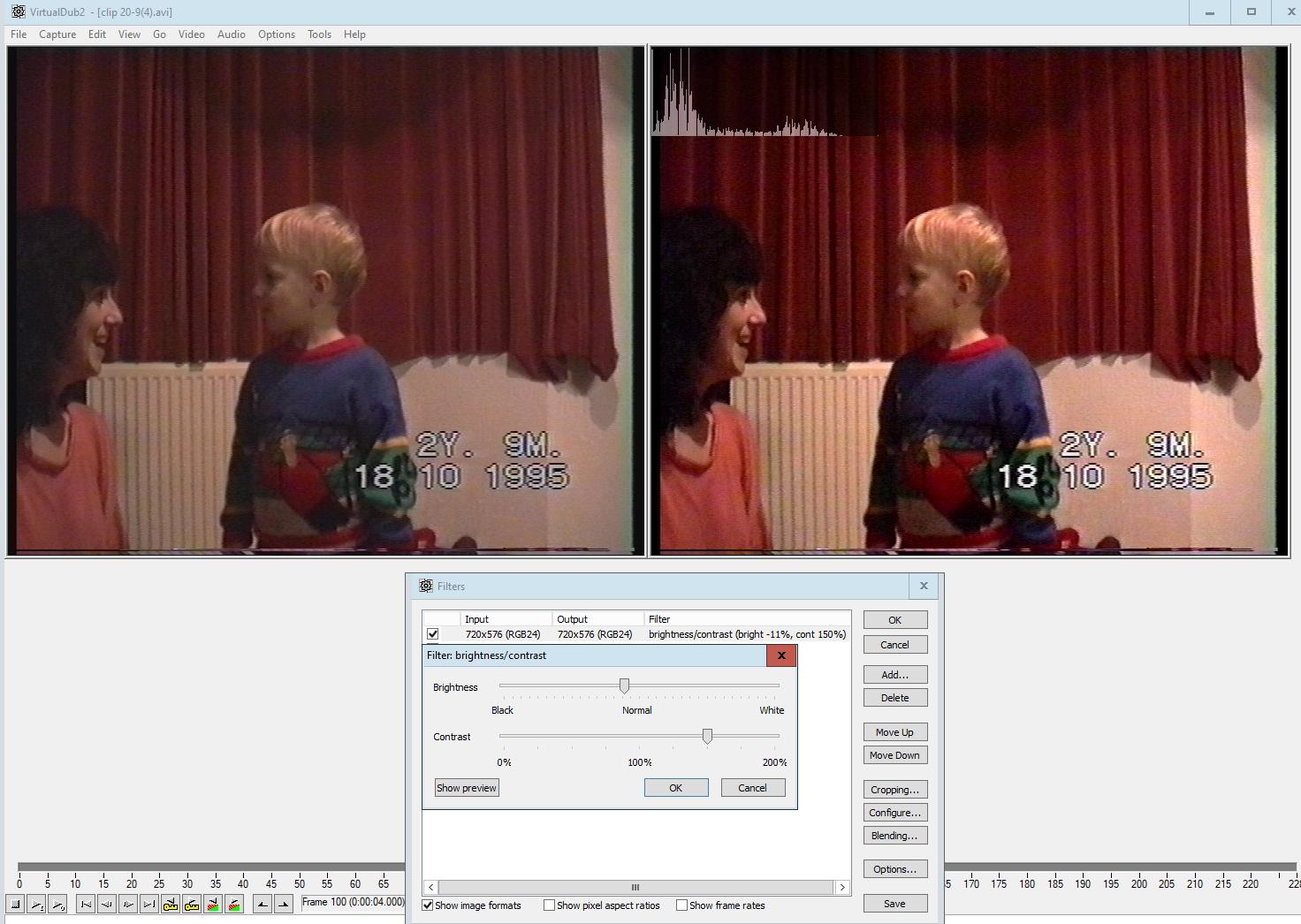

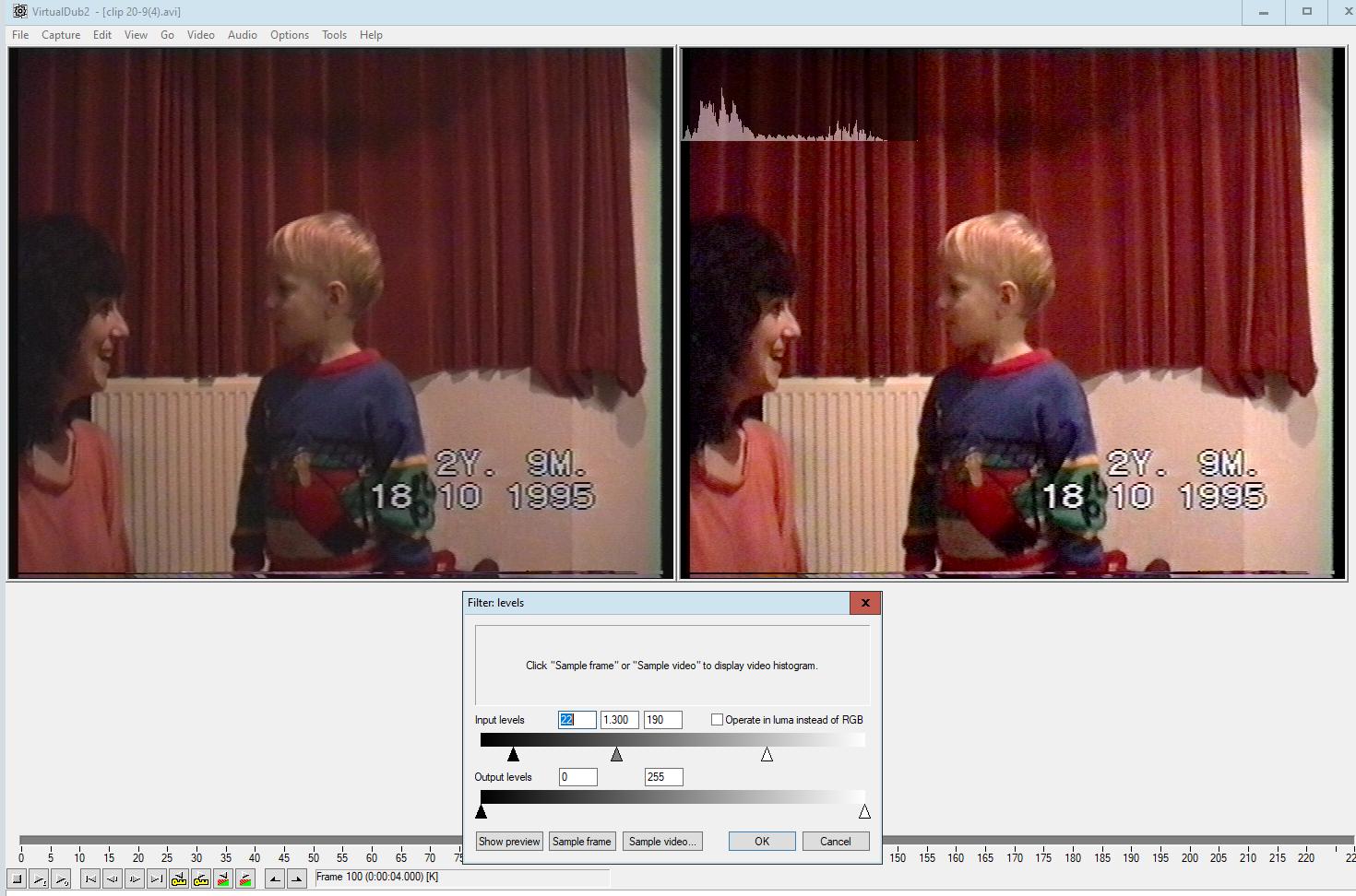

  20. Less brightness and more contrast.
    In most programs "brightness" adds or subtracts a value to the luma. For example, if a pixel has a luma value of 1 and you add 1 it becomes 2. If a pixel has a luma value of 100 and you add 1 it becomes 101. "contrast" is a multiplier. With a contrast value of 2.0 a pixel with a value of 1 becomes 2. A pixel with 100 becomes 200. In some programs these are called offset and gain (because that's what they really are at the analog hardware level).
    Using the Brightness/Contrast filter in VirtualDub:
    [Attachment 66909 - Click to enlarge]
    Here I used Levels to adjust the video. Because Levels also has a gamma adjustment that brings out shadow detail. I let the black bars get crushed. And the white text a bit too.
    [Attachment 66905 - Click to enlarge]

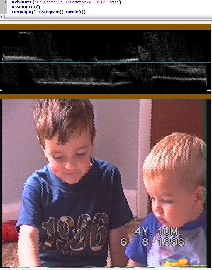

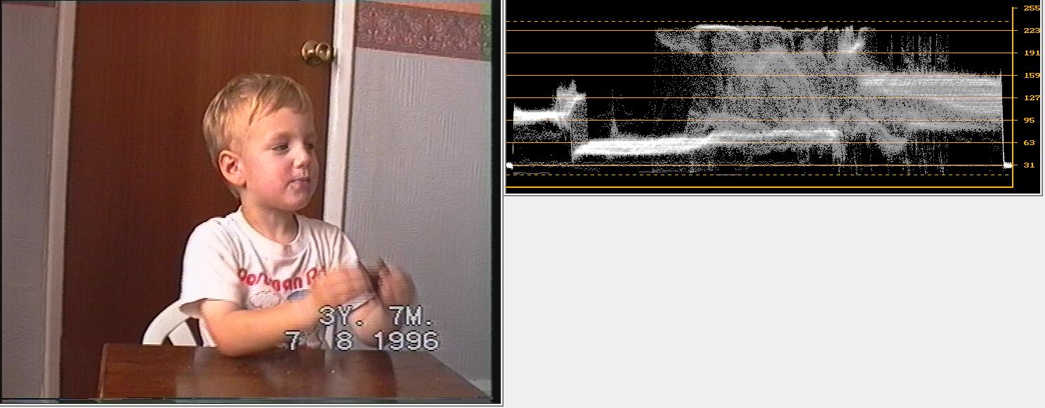

    Thanks jagabo. I did look at the waveform but maybe wrongly I thought it was post capture? I know Sharc's earlier post mentioned the black bars fooling me and I thought that he didn't think I was cropping the borders & swishing out before looking at the histogram. However now you're saying the same thing maybe I misunderstood.
    If I don't use the histogram how should I come at this and stay within the 16-235 range?
  25. Member
    Sep 2021
    I've just been looking at the waveform. I noticed on the avipmod waveform that there is void between the bottom brown bar and the white wave. The top appears to be closer. I'm assuming the wave should be much closer?
    The virtualdub waveform seemed fairly good, so I imagine I'm probably not reading it correctly. I also uploaded my virtualdub settings for this.
    Is this a method of checking the 16-235 range as well as the histogram.
    Looking at the Avipmod waveform I must get my capture closer to the bottom bar? Thanks.

  26. The black bars in your Color Tools waveform is very similar to those inthe AviSynth waveform. The dashed line is Y=16 in Color Tools.
