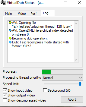

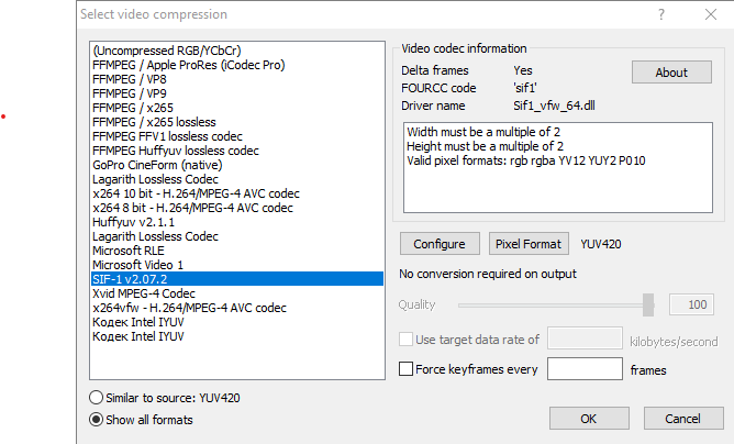

  28. Originally Posted by El Heggunte View Post
    VfW encoder doesn't like VirtualDub's Fast Recompress feature.
    No that supports.
    YUV12, I420, I420p10(10bit), I420p16(16 bit),P010_16( 10 bit)
    What you need to support fast recompress?
    [Attachment 66876 - Click to enlarge]
