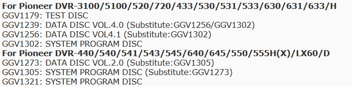

    Possibly, but unknown for sure.
    The Service Manual for the UK/Euro models
    DVR-LX61D
    DVR-560HX-S
    DVR-560HX-K
    Says;
    The x60 series all came out in 2008, both in UK/Euro and Canada.

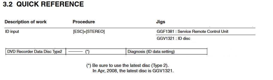

    The last comprehensive ID data disc listing show the GGV1305 was a preceeding disc that covered earlier models.
    The "list" is from an "English" adjacent language speaker.. so the use of the term "Substitute" is open to interpretation.. it might mean its a Substitute "for" a previous disc.. or an indirect reference to when Pioneer and Onkyo stereo systems were being serviced by the same shops.
    The System Programming discs appeared to be released in "Epochs" over time to cover a "Tools / Jigs" release schedule.. which was not exactly linear. Some might be released in parallel, so there was some over lap.
    Someone, a long time ago, started referring to the DVRs in groups, called "Type1" or "Type2" and referring to the ID Discs as members of the "Type1" or "Type2" discs.
    The last ID disc I'm aware of is the GGV1321

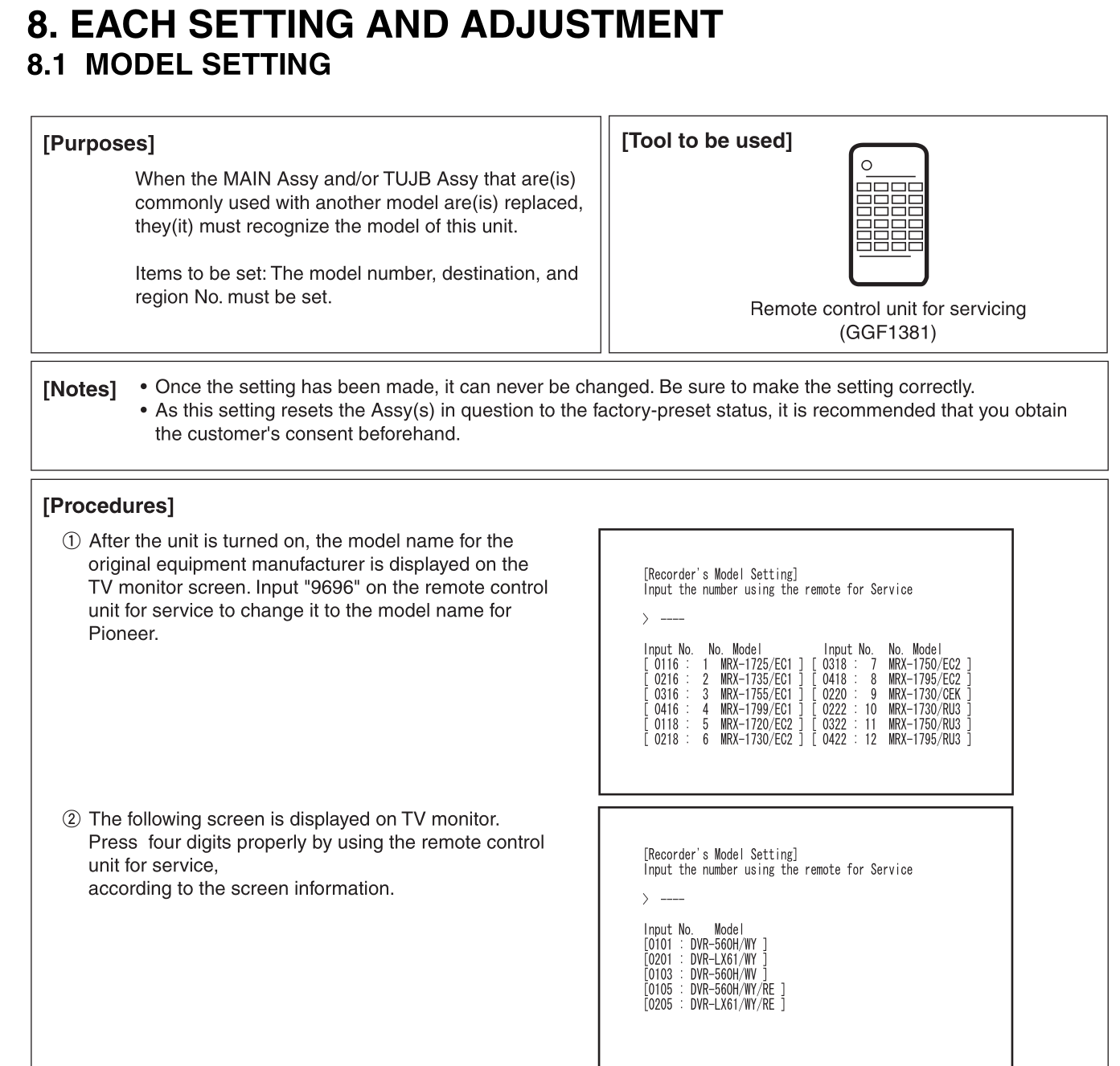

    But another trick what I know is change model to LX61 using service remote and we can use 250GB data space.
    [Attachment 67121 - Click to enlarge]

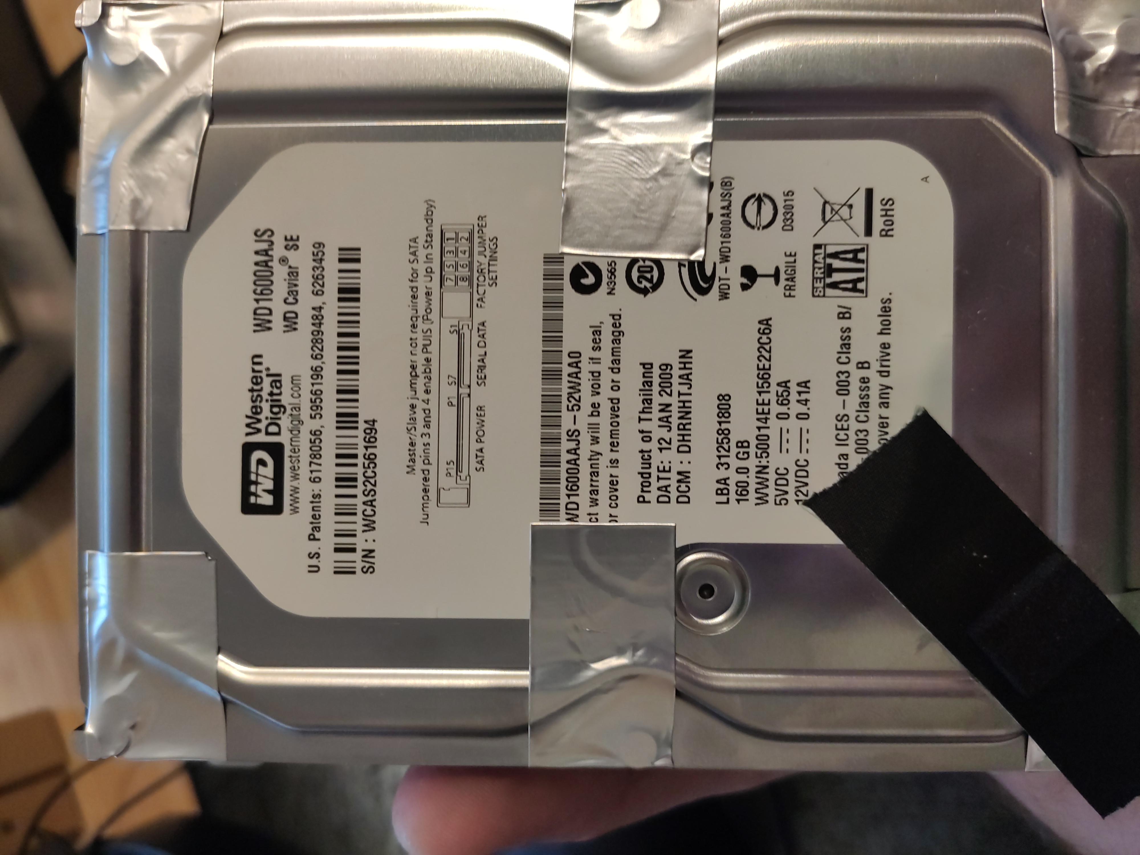

    this is hdd from pioneer 560.
    [Attachment 67123 - Click to enlarge]
    [Attachment 67124 - Click to enlarge]

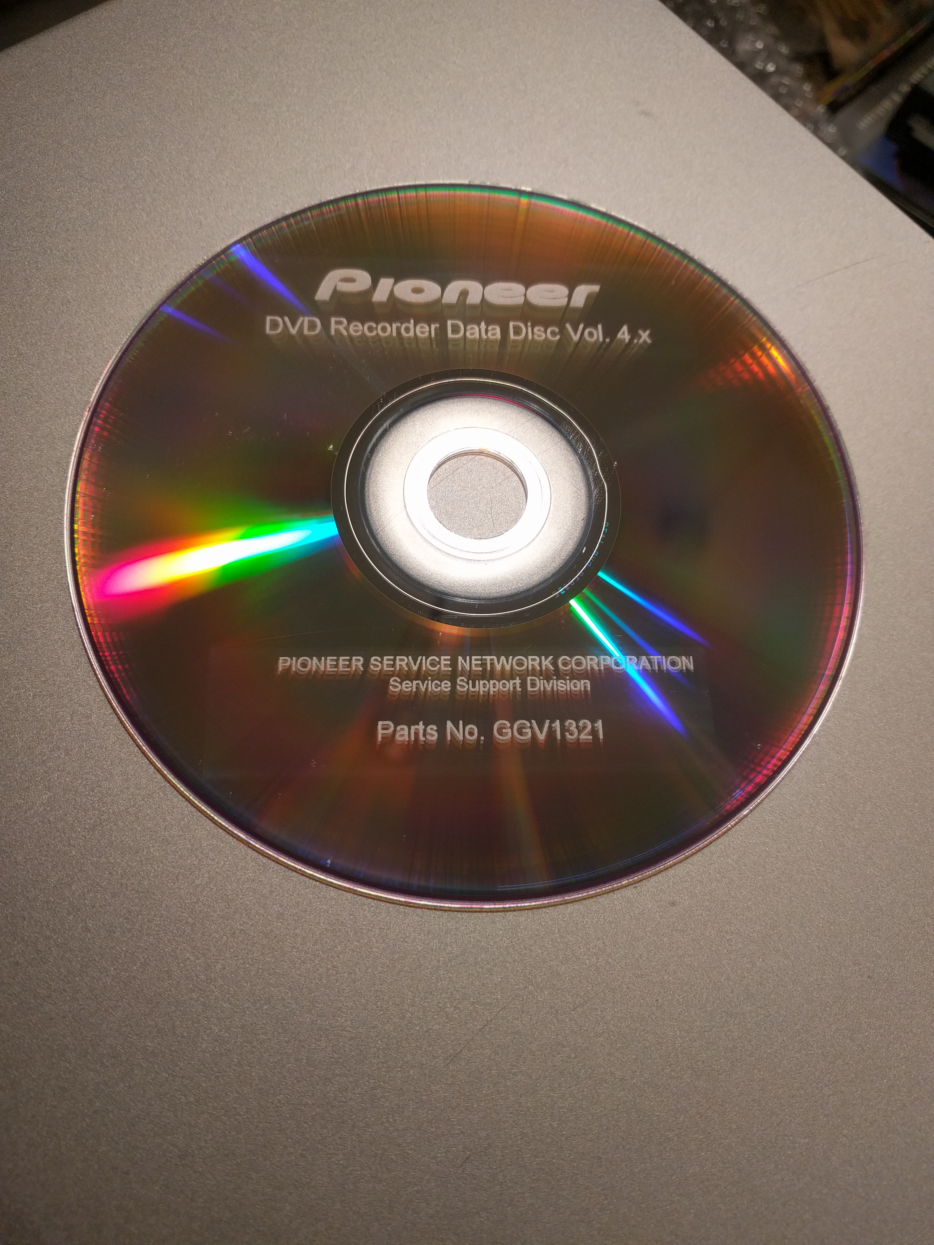

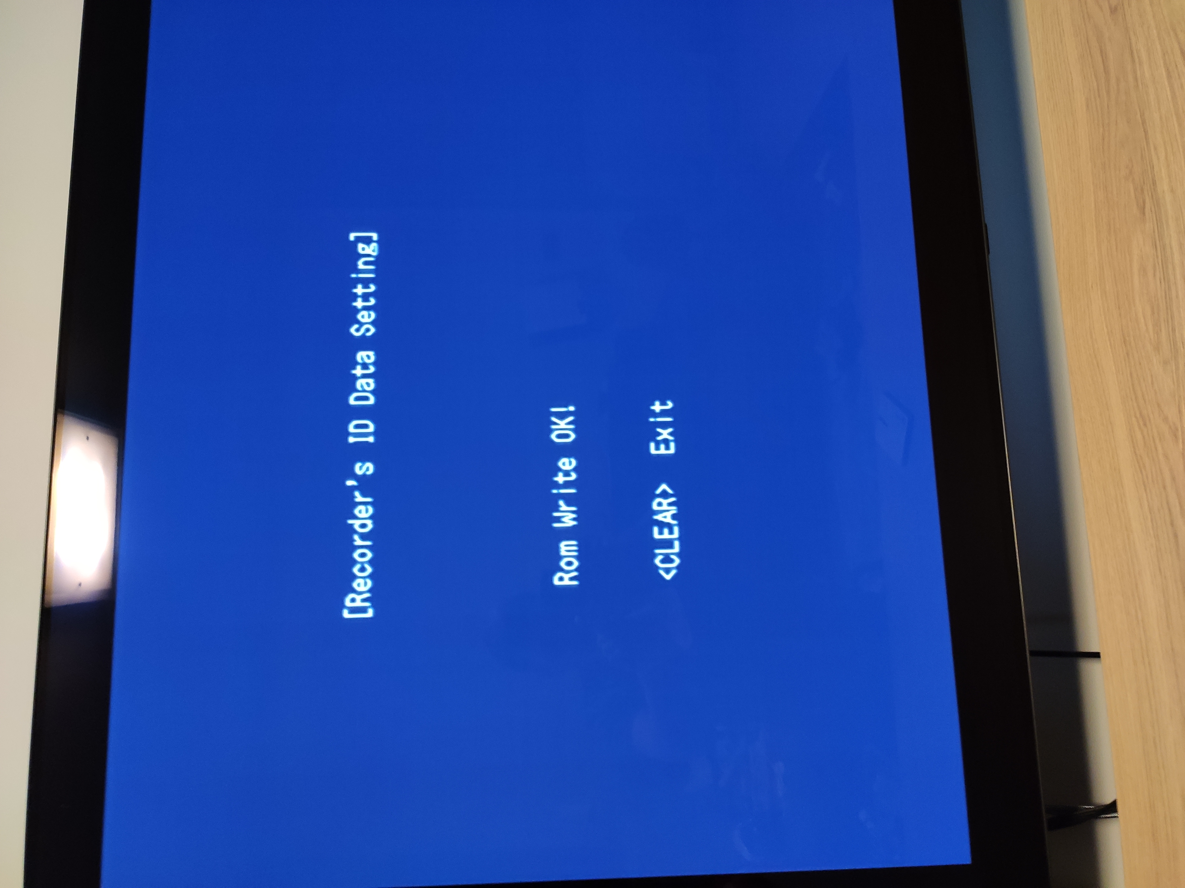

  17. Ok I can confirm GGV 1321 works, I tried 2.5 hdd 1000gb but not ssd because I have only 128GB models.
    [Attachment 67125 - Click to enlarge]
    I used logitech harmony hub to pioneer service remote and DVD-RW disc.

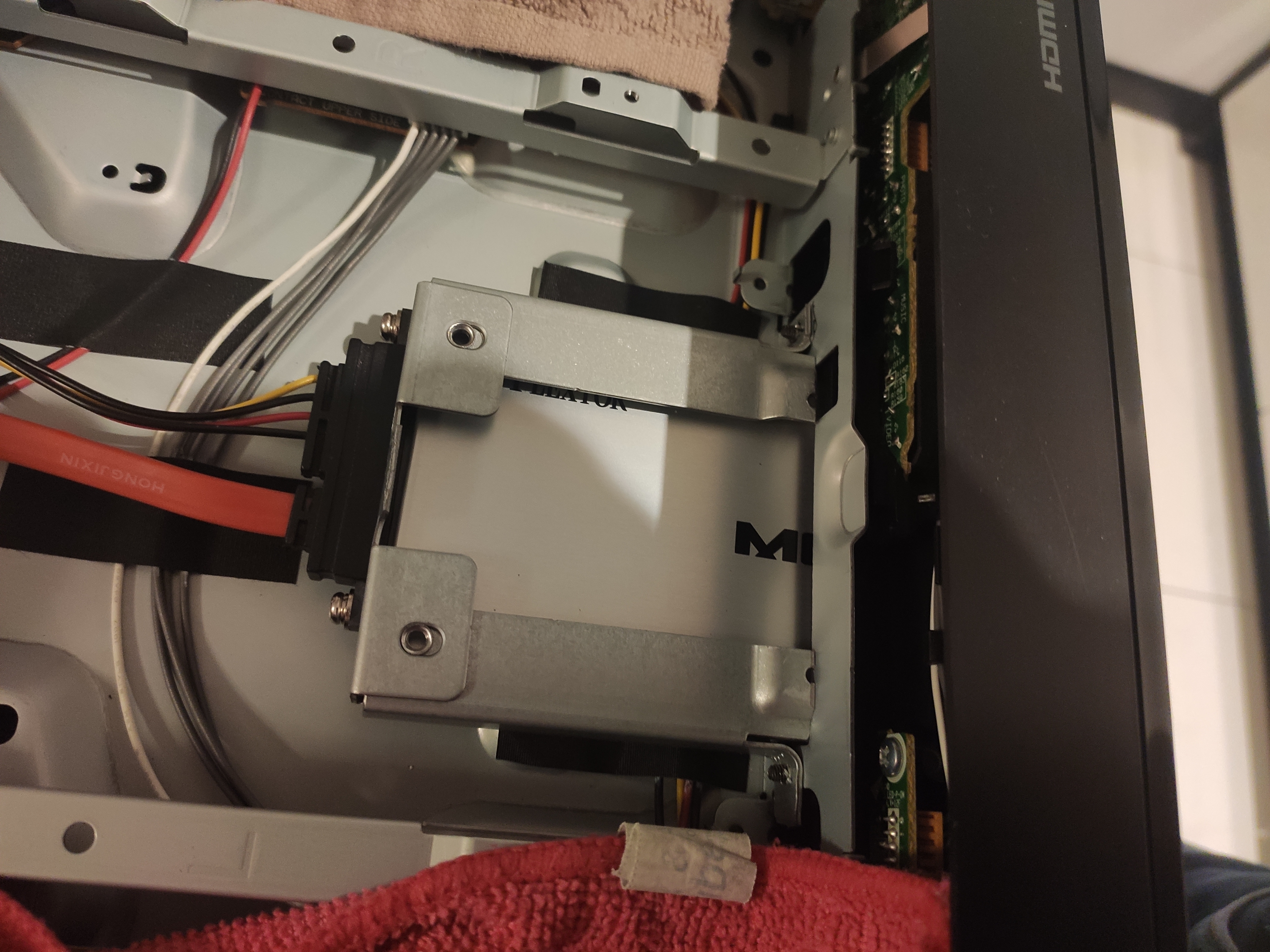

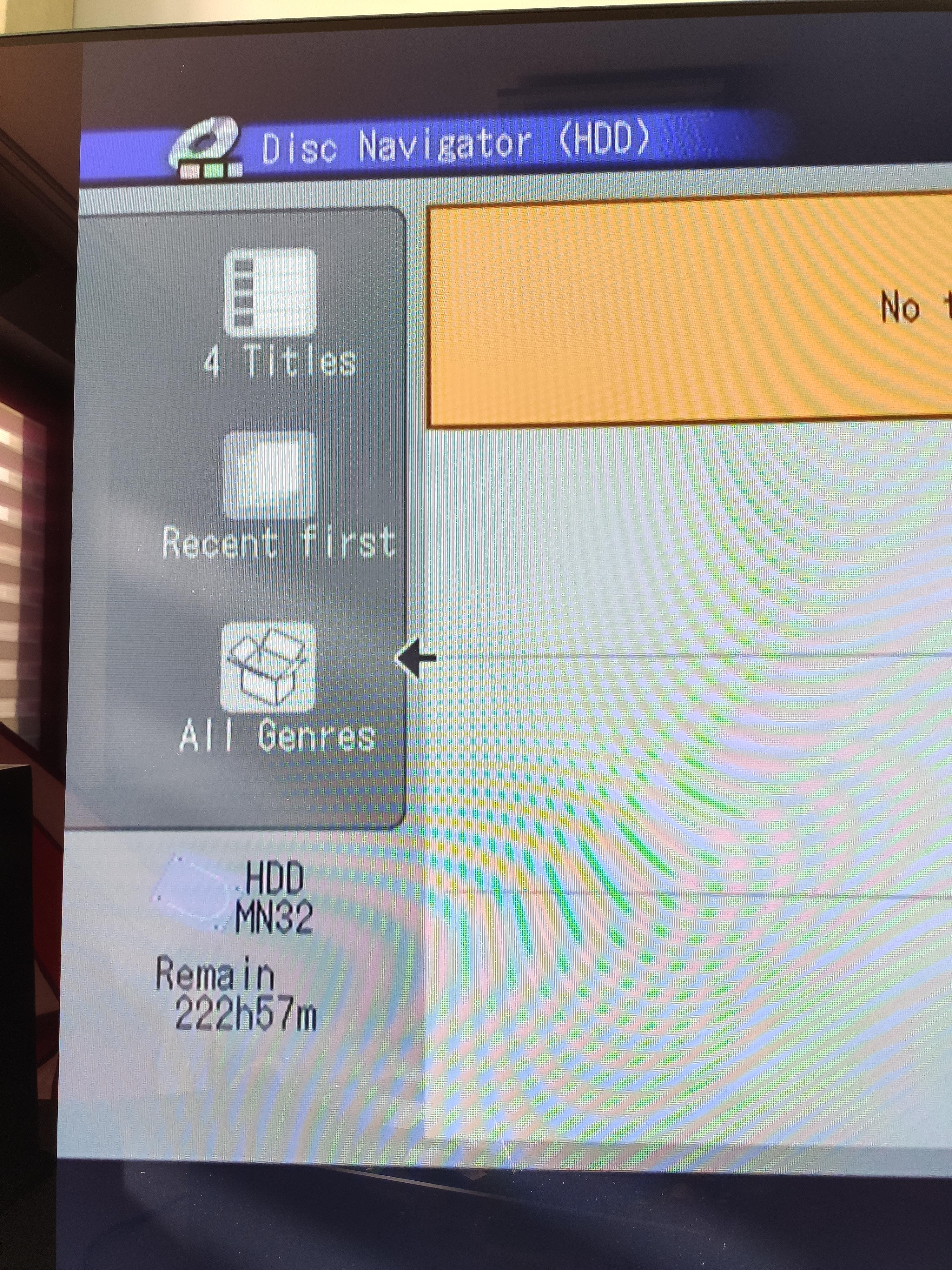

  20. I tried 120GB SSD and working and I must say... recorder now working like rocket haha awesome.

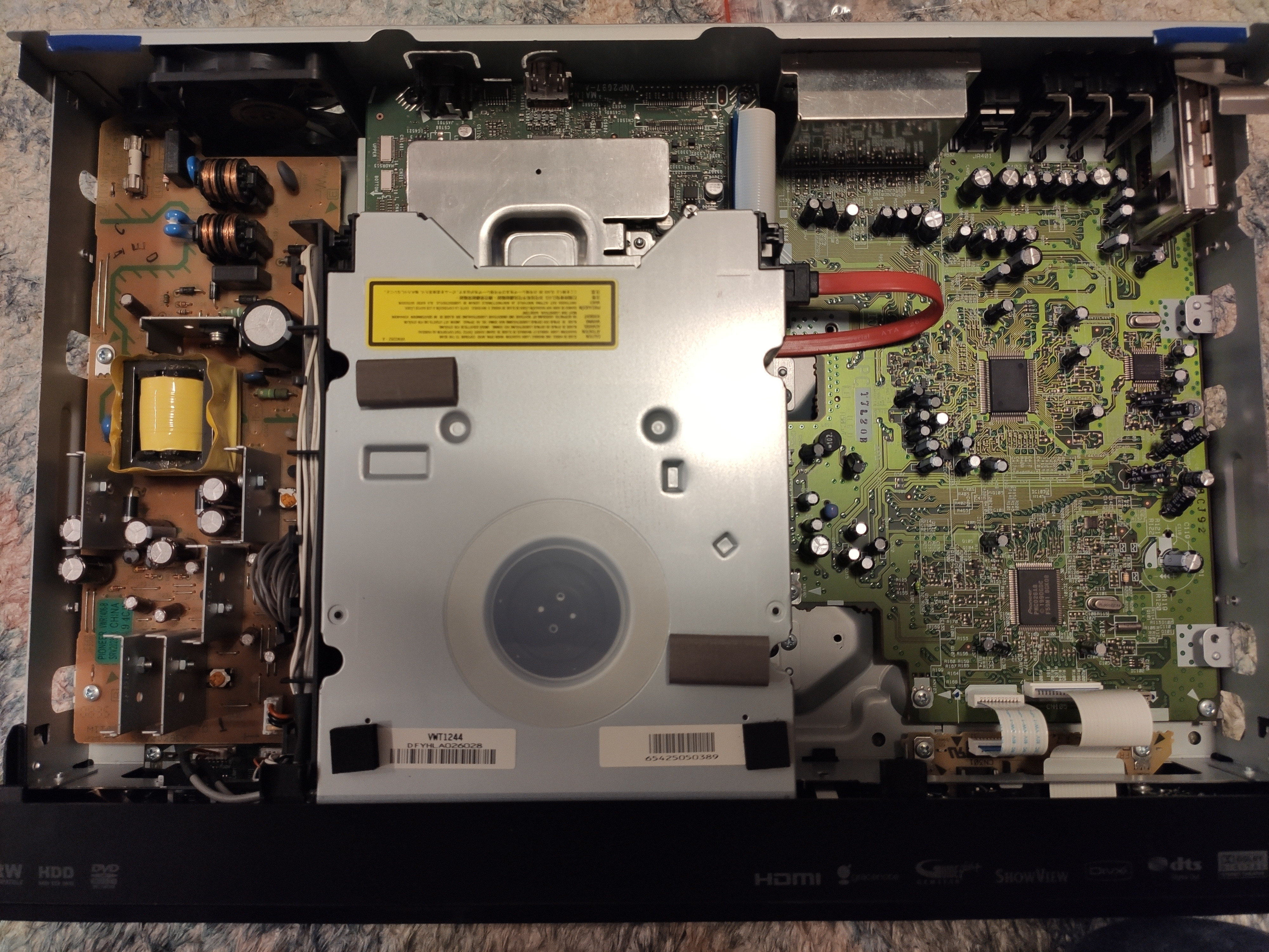

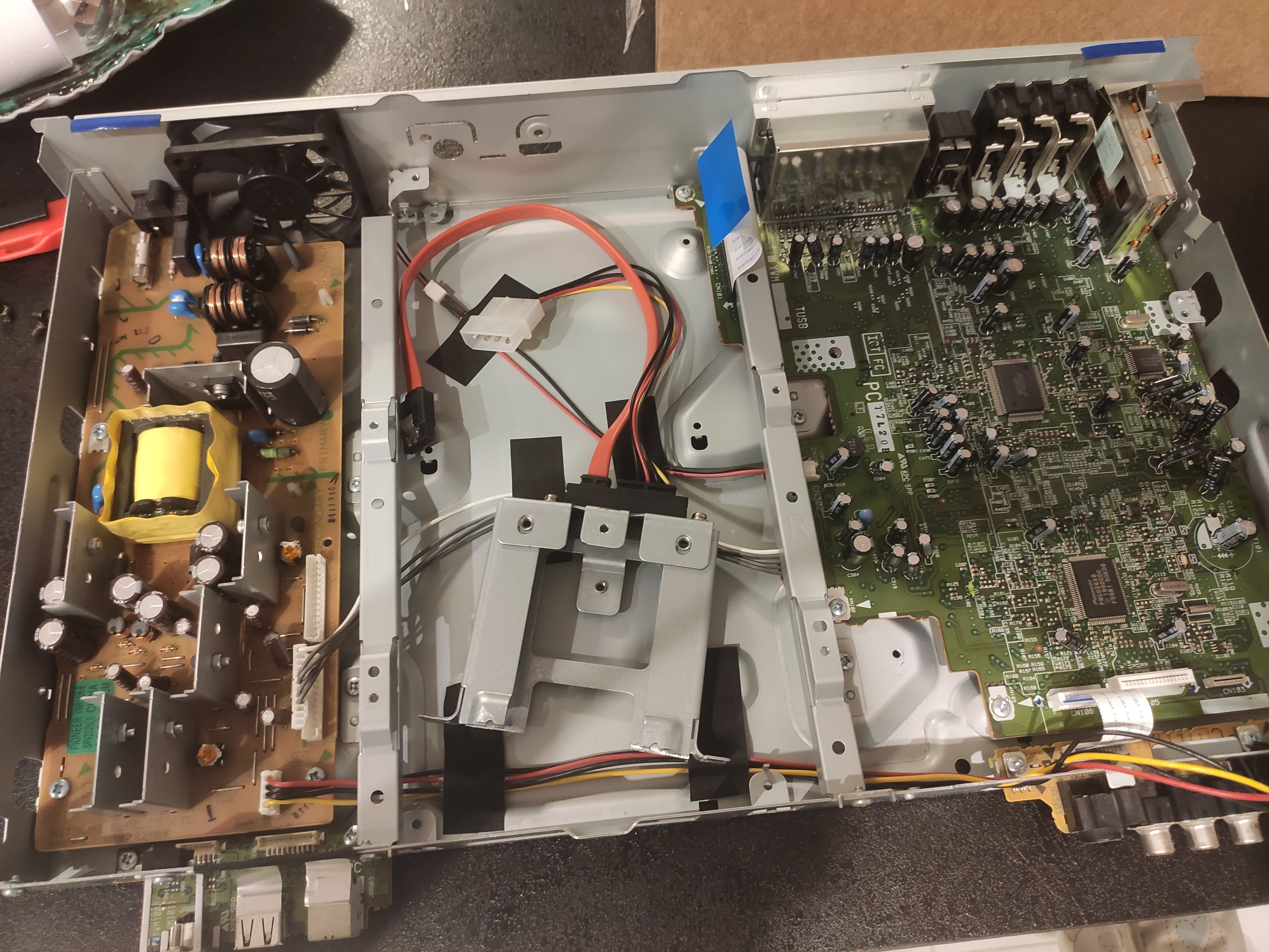

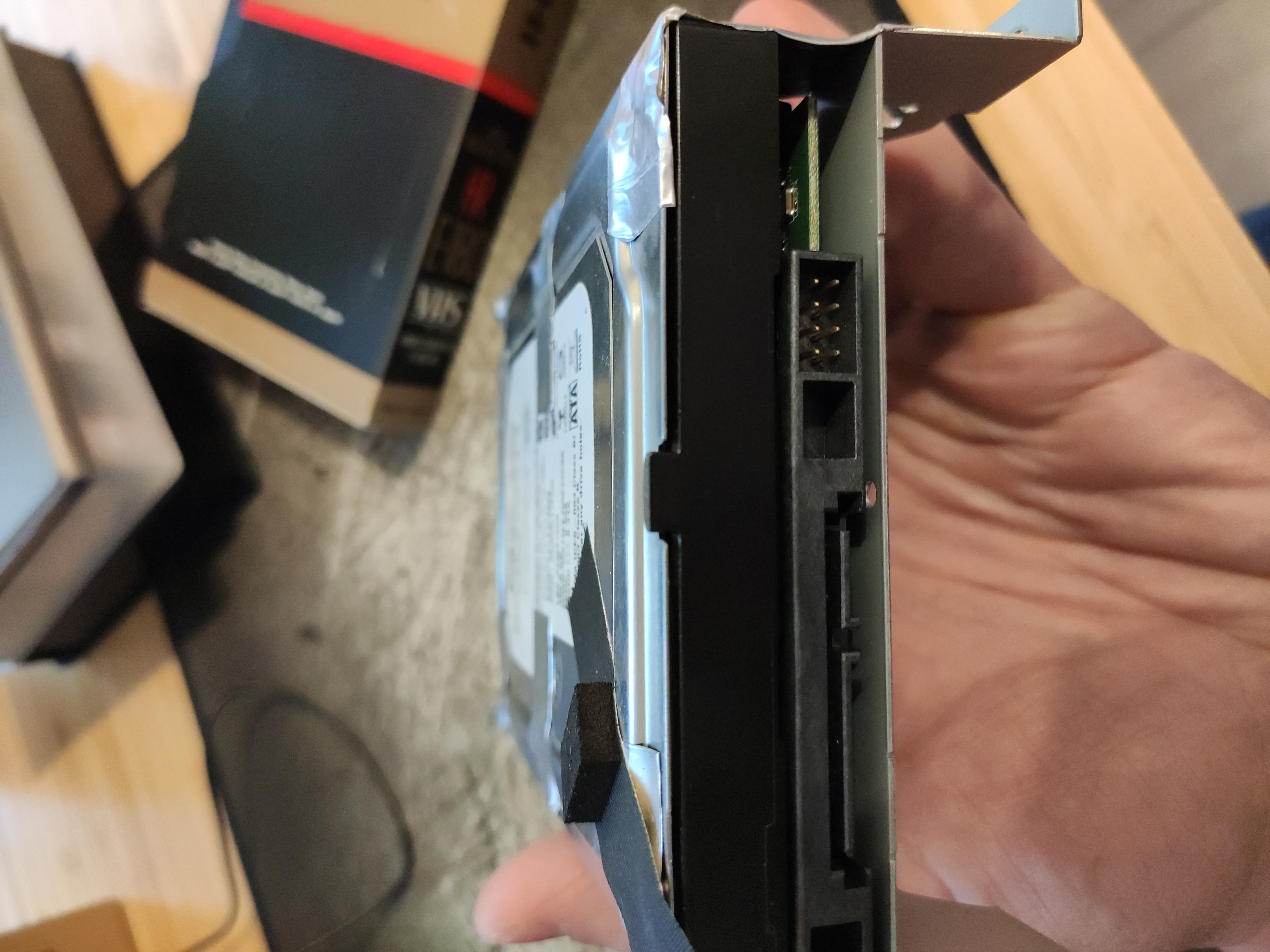

  23. My new generation pioneer dvr 560h with SSD , yee I know I know ... just I had to much time.

    Really Nice Modification! - had a Hole on top of my LX60 for disk swapping and running the Disk On insted of IN the Recorder...

  29. As you can see the HDD has been changed so I already have GGV1321
