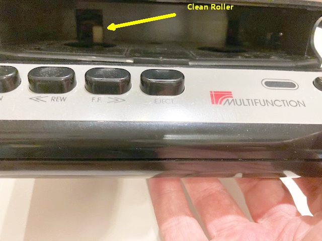

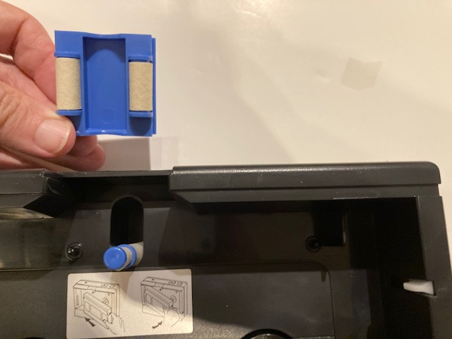

    This is one we had like when my Grandmother was still alive
    It has separate buttons for Eject, FF, RR and Clean - expensive compared to the later models when up/down decided a direction and clean was the last expensive button to be removed.

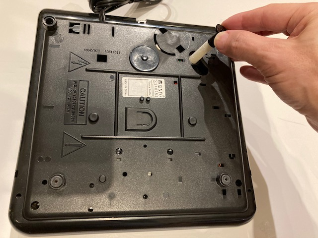

    This is the bottom, the roller is kind of batten of soft cotton barely stiff enough to hold its shape pressed against the tape. Its only engaged when the [clean] button is pressed. If its engaged, when the [eject] button is pressed the roller is moved back out of the way before the cassette basket rises up to release the tape.

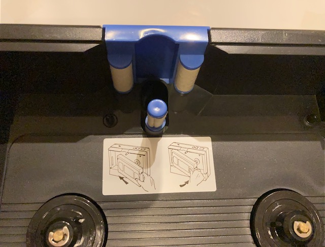

    You can see the clean roller hiding back in the corner of the cassette holder, it stays out of the way and the winder runs full speed when its not [engaged].
    But as soon as it swings into place the whole assembly downshifts and the tape winds much slower.. probably to prevent friction or static electricity from building up.
    What I remember when I was a kid, was being fascinated by the cleaner function.. but all folks cared about back then was how fast you could make it rewind.. all the other features just made it more expensive and no one saw a good reason for them.

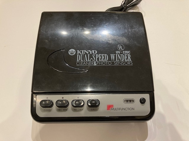

    This is a Kinyo UV-220c for VHS tape.
    They made others, for both Beta and VHS.
    Dad used Beta.. that was his baby.. but the rest of the household used mostly VHS.. when Beta died.. he kept everything and just silently put it away.. and years later I have them.
    Kinyo came out of China.. old China.. so they were trying to make things extra special to appeal to new markets.
    But they kind of got things wrong with the winders.. until they stripped them down and took out a lot of features.
    Eventually nearly "all" 2-Way winders were Kinyo.. but they let companies like Best Buy, Builders Square and Home Depot put their names on them.. but they were the expensive luxury edition Kinyo's.
    China wised up and started taking things out.. Solodex was eating their lunch with simple winders with no cleaners.. but even they were "overkill" they kept putting in 1980's electric lights and "sensors".. things that don't work today.. but they were cheap.. but had "wow" factor.. just not much functionality. Kinyo started making "wow" products that looked cool but didn't do anything and were cheap.. and then Blockbuster revolutionized the market with "be kind rewind" and all people cared about was "how fast does it rewind".
    The "autowinder" was born.. and they started making them in the shape of sports cars.. they looked like toys in the living room.. it was ridiculous.
    Kinyo outlived Blockbuster.. they eventually ended up making I think the last 2-Way winder back under their own name for BH Photo until about 2006? maybe 2008 until they pulled the plug on that.

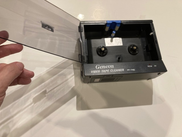

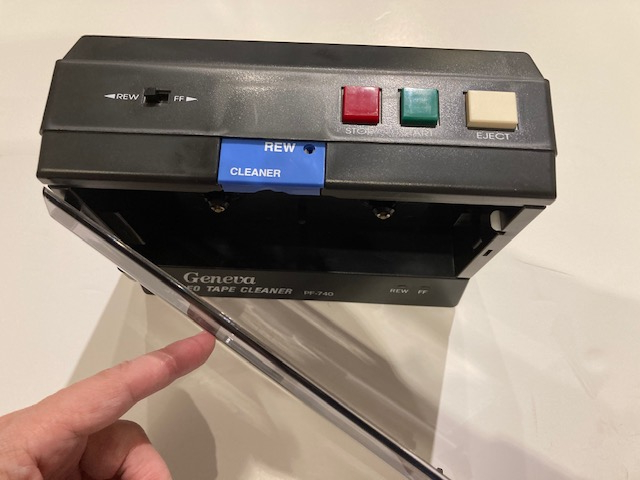

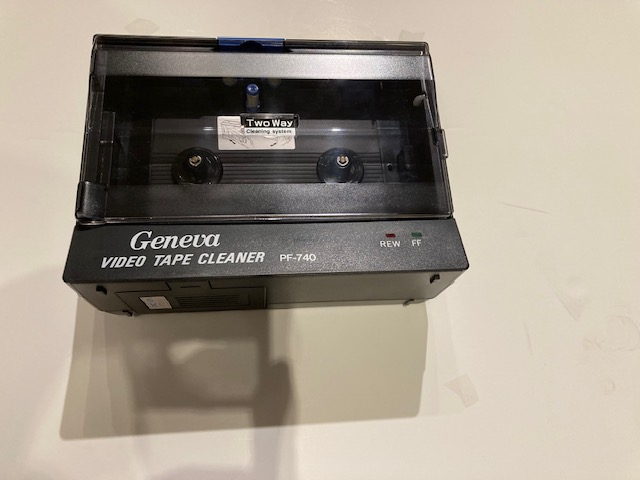

    Ok.. I "think" this is what you were talking about.. I got the model number wrong.
    Its been sold over the years under different names like "Videomate" and others.. Geneva did the best job on the user manual that is included though.
    Typesetting with a computer wasn't a thing back then so most of it would look cringe today.
    Its a plastic box, and rattles quite a bit when its running. This model at least has both a wall adapter and/or battery compartment power supplies.. so its kind of portable. I don't recall they were always that way though.. but I think this was an "end of the line" model.
    I have seem them on eBay.. they have a mythical quality about them.. cures all woes.. ect..
    You either lay the box on its back and insert the tape, or with the box standing up; insert the tape on its spine with its trapdoor flap facing upwards and then wrap the teeth of the thing around the tape path before closing the door.

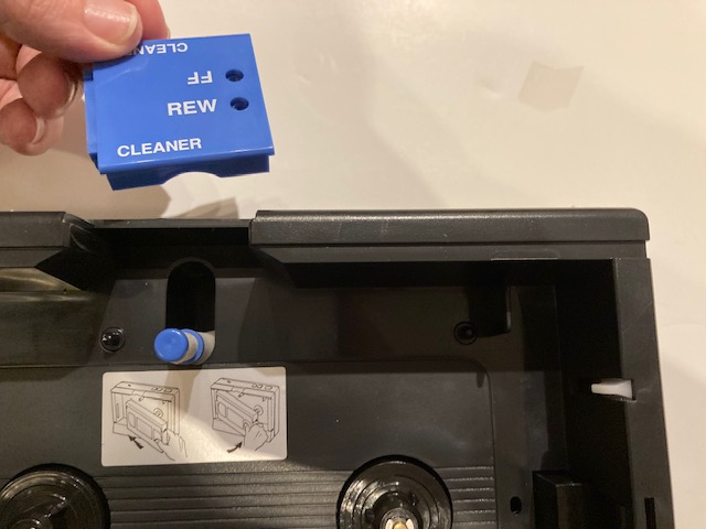

    It has three "teeth"
    The two on top, and one on bottom.
    The Right hand "tooth" roller has a reservoir on top where you can squirt liquid and that roller is the "wet-wiper".
    The Left hand "tooth" roller has no reservoir on top and is the dry wiper to dry the tape as it passes.
    The Bottom "tooth" is mobile.. I guess its a Capstan ? I'm not an audio deck nerd.. so I'm not sure what the proper term is.. anyway.. it applies gentle pressure against the tape once engaged to make sure it comes into contact with both of the upper "teeth".
    Notice it only "wet-wipes" one side, and the capstan only dry wipes it.. so it might not be the best for disinfecting a tape that had mold.
    Both sides of the tape will come back into contact with each other when wound on a reel in the cassette.
    I am confused "a little" though about the separate FF and REW "holes" for fluid.
    The Capstan "tooth?" is articulate and could in theory move back and forth when the tape winding process switches direction.. I've never watched it.
    The buttons are earnest.. but not quite as well laid out as for a Kinyo winder.
    Its a pretty clever idea.. and for its time.. innovative.. but it obviously depends on you knowing what your doing and monitoring the humidity.. and being desperate enough to try using one.
    That plastic front swing door.. is obviously to protect you in case something goes hideously wrong.
    I won't lie.. its an appealing "idea"
    And I've seen youtube videos from South America where they have used one for mold.
    I think I saw one from Alabama where a guy had similar problems with mold.
    Its just awfully dependent on that "magic fluid" and it evaporating just the right way. But if your in a moldy environment to start with.. I'd guess your humidity is already pretty high.. so your bailing water out of a sinking ship.
    And you don't always know how that mold is going to react.. it might shrink away and go sit in a corner.. or fight back.. and strew tape all over your room.. should it escape the cassette and the safety of that plastic "blast" door.
    When it runs.. it sounds like a prop from a Weird Al Yakovich .. movie.. or Electric Dreams.
    To me.. being a kid from the 80's myself.. it "feels" like it should have cost about $200 usd back in 1984 or so.. with inflation and collectors pricing.. I'd guess $500 or $600 might be fair? If its in good condition.. but as a tool?
    Its not a Milwaukee specialty tool.
    It is/was a noble effort.. but I kind of think.. if it were successful there would have been competitors.. and Kinyo probably would have made one, or something like it.
    True the "Vinegar Syndrome" of Mold didn't set in for a while.. but I just don't know.
