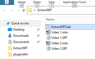

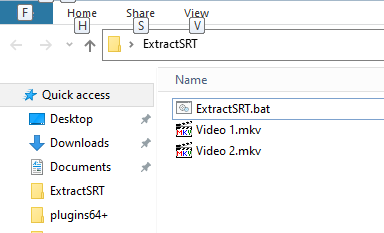

folder contents before running batch file:
[Attachment 66683 - Click to enlarge]
folder content after running batch file:
[Attachment 66684 - Click to enlarge] -
