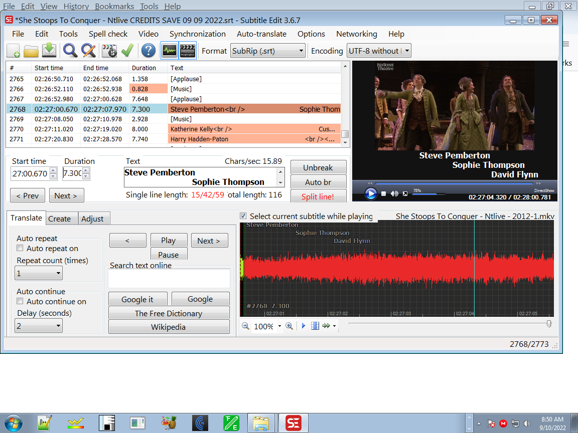

  1. I am doing some end credits and would use three lines one for each actor in the video as they
    take a curtain call in a group. Subtitle Edit forces centering on short lines since I can't seem to manually space the text.
    The goal is to have three steps across the screen for actor one, actor two, actor three for clarity stepped on the three lines in the default format.
    Is there a line command for manual spacing?

  3. Yes I didn't think centering would be a default on it. In the Edit box I was trying to make one entry, then CR to the next line make the secondentry then CR to the third line with a single name entered on each. Then force some spacing to position the names in step fashion:
    First
    Second
    third.
    But the screen shows that any spacing is ignored and the three names stay at center.
    It's a small thing. I just couldn't see why normal text spacing -- hitting the space bar-- gave no new result.
    >>>> Progress. I may have it now. Today on reload I saw the desired positioning. I think the answer is: Use one continuous line entry
    rather than the line brakes or CR's .
    Here is a screen shot of what it looks like but may need adjusting....
Name:	credits spacing.png

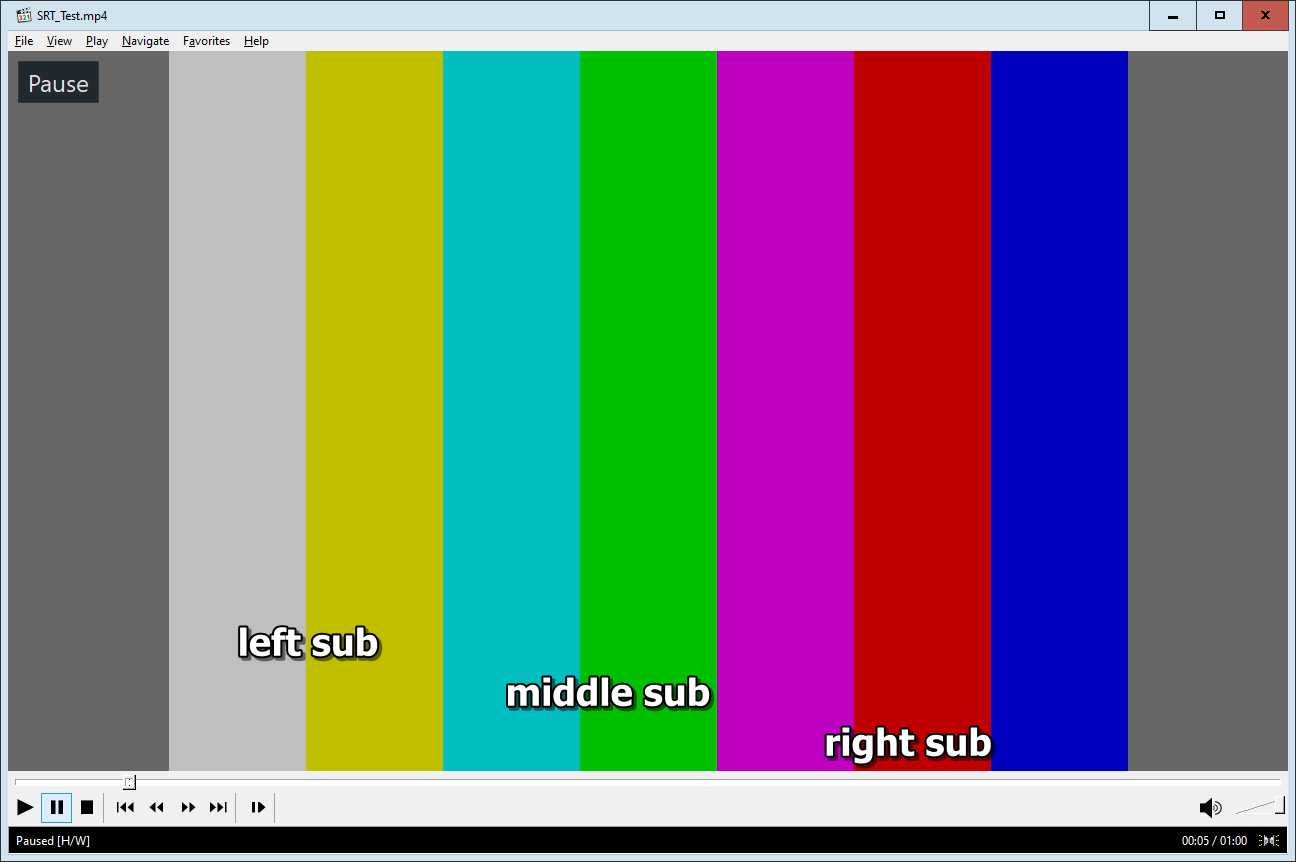

  4. Centering is normal for SRT subs. And most renderers will remove spaces and other non-printable characters before centering. So you can't easily position subs like you want with SRT. There are some tricks you can use but they are not standardized so they don't work with all players. One is to use ssa position tags and overlapping times:
    3
    00:00:05,000 --> 00:00:6,900
    {\pos(90,245)}left sub
    4
    {\pos(180,265)}middle sub
    5
    {\pos(270,285)}right sub
    Unfortunately, those position aren't consistent. Different players put them in different locations (if they respond to them at all).
    [Attachment 66677 - Click to enlarge]
    If you want more reliable positioning you need to use another sub format. Like SSA or IDX/Sub.

    But it does raise another thing. How is the grid of the screen determined? Where jagabo described the screen
    positions, what is the start and end point of the grid horizontal and vertical?
  14. Originally Posted by loninappleton View Post
    Experimentally, the first number is the horizontal position, the second the vertical position. 0,0 is at the top left, 385,290 is the bottom right. The specified position is the bottom center of the line of text. If there are multiple lines it's the bottom center of the bottom line. It appears to be independent of the size of the video frame. These position tags work with MPCHC and PotPlayer. Other players ignore the tags and display the subs at the bottom center of the frame (ie, as if there were no position tags). Oh, they work with VSFilter in AviSynth too.
    I highly recommend you don't use these tags unless you are doing so for your own use.
