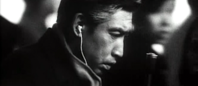

    And this is what got my the best results yet (I've tested many different things):
    TFM().TDecimate()
    vinverse(sstr=2.7, amnt=255, uv=3, scl=0.25)
    Deblock_QED(quant1=24, quant2=26, aOff1=1, aOff2=1, bOff1=2, bOff2=2, uv=3)
    Grayscale()
    (I could not find a suitable denoiser yet)

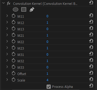

    And then, on Premiere Pro
    [Attachment 66663 - Click to enlarge]

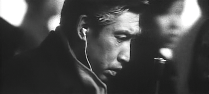

    That was recomended for dotcrawl in Doom9's forum, (that also has, more noticeably, in other parts), and got an overall better result than before. Needs sharpening, but this is the current result:
    [Attachment 66664 - Click to enlarge]

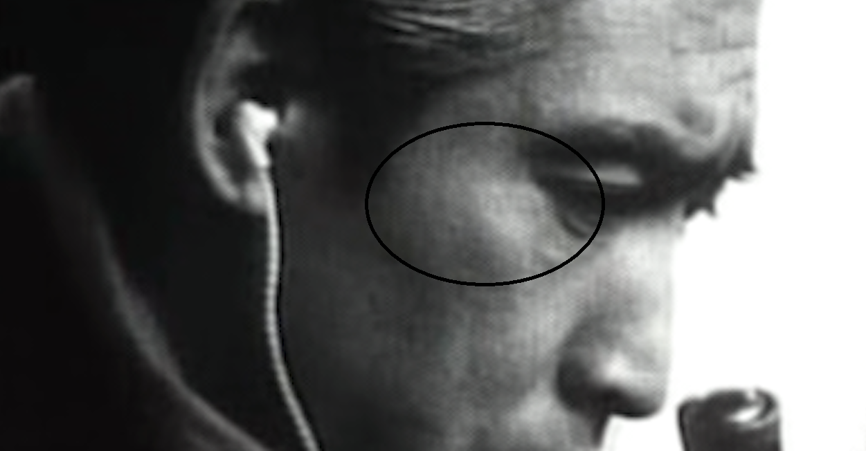

    But in exchange got this dot pattern now:
    [Attachment 66665 - Click to enlarge]
    I'd love to get rid of those without causing too much more destruction.
