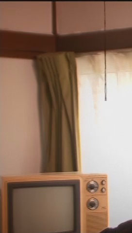

    I have a professionally produced NTSC DVD from 2008 that visually appears to be in perfect condition. No matter how I view it there are numerous black lines that appear only from the top of a frame and extend down, but not all the way down. It reminds me of an old film. My guess is it might have been shot on film and then transferred to DVD (badly), or perhaps the manufacturer added the noise to make it seem old. It just seems odd.
    I've tried different players and the lines are always in the same spot so I doubt it's the player. Other than the black lines the DVD plays perfectly. If I extract the VOB files the lines remain.

    I see a pull cord for a ceiling fan switch.
    Is that "line" moving when camera moves or is it static and not moving?
    Cut and post a short video sample of that artifact.

  4. The lines only exist on single frames and occur randomly...sometime a minute apart and then a whole bunch separated by just a few frames or a few seconds. The artifacts are not static; they jump around but only last a single frame.
    I'm beginning to feel that these were intentionally added to simulate something "old."
    I appreciate the tutorial, Delogo VD, but as I said these are not static.
    I think there is nothing to be done about the thousands of these lines but I appreciate the feedback.
  5. The artifacts are not static; they jump around but only last a single frame.
    DeSpot, KillerSpots, SpotLess, might be able to help then.
  6. If you post a sample, you'll get a LOT more help. The motion compensated version of RemoveDirt might do the trick. I second Selur's suggestion of Spotless.
