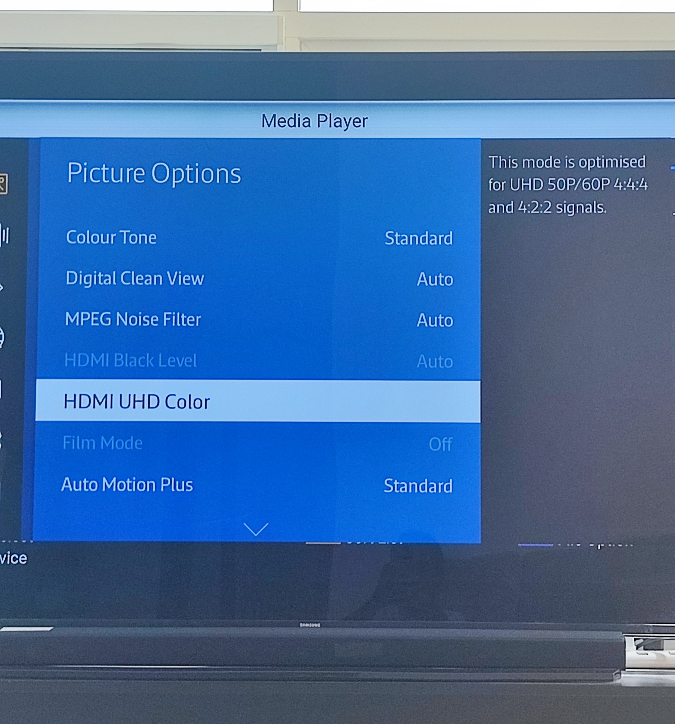

    I downloaded the manual for the TV from https://downloadcenter.samsung.com/content/UM/202011/20201116153100517/KM2ATSCN-3.1.0_...G_201023.0.pdf There is a section on page 95 that says the following:
    Viewing UHD videos
    Settings-> General External Device Manager->HDMI->UHD Color
    If an external UHD player is connected to the TV, use the HDMI UHD Color function to convert the TV's HDMI connector to a mode optimized for the UHD 50P/60P signals:
    • When you select the HDMI connector you want to use for HDMI UHD Color, and then press the Select button to set the HDMI UHD Color function to On, the TV screen flickers.
    • The HDMI connection with HDMI UHD Color set to Off supports up to UHD 50P/60P 4:2:0 input signals, while the HDMI connection with HDMI UHD Color set to On supports up to UHD 50P/60P 4:4:4 and 4:2:2 input signals. For more information, refer to "Supported Resolutions for UHD Input Signals."
    • When you connect the TV to an external device that supports only the UHD 24 or 30 Hz frequency or any FHD frequency, the HDMI UHD Color function may not be available. In this case, set HDMI UHD Color to Off.
    If the UHD content is 50p or 60p, then you could try turning on the HDMI UHD Color setting
  10. Image
    [Attachment 66694 - Click to enlarge]
    Yes This setting
    Still black screen only sound coming
    Aug 2006
    Yes This setting
    The HDMI UHD Color setting is not available unless the video is 50p or 60p. Is it possible that your satellite receiver is delivering 24p or 30p UHD video? In that case, the TV is limited to 4:2:0 chroma subsampling.

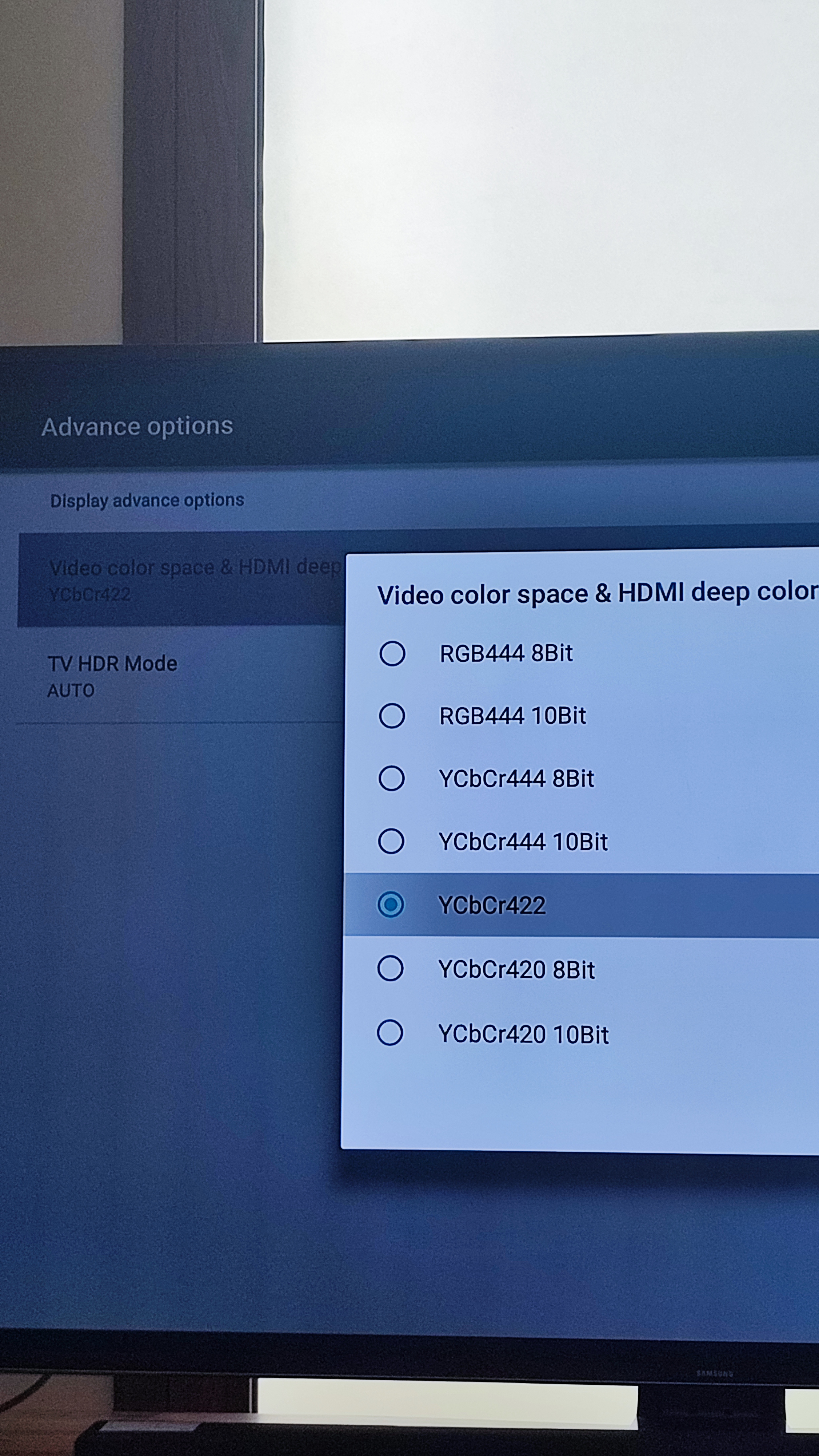

    You are saying that the picture above is a page displayed by the satellite receiver? There is one option listed for YCbCr 4:2:2, which doesn't show the color-depth/bit-depth like the other chroma subsampling options in the list. Does this page just describe the chroma subsampling for the video or can you select any of the other options shown?
