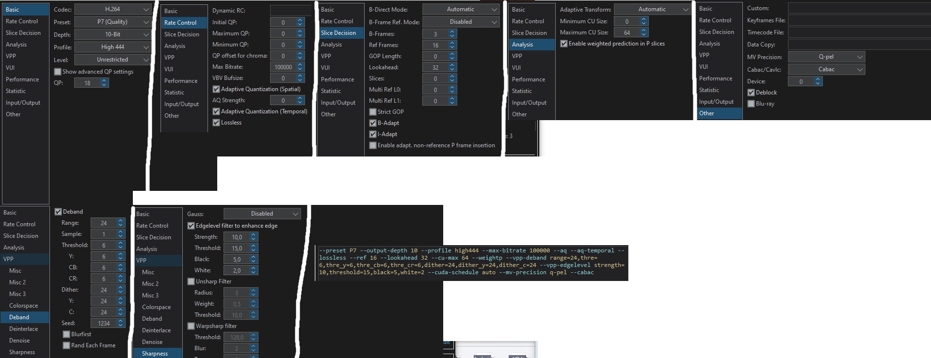

  16. Ok, Poisondeathray, thanks for all your replies.
    Now, please, someone can tell me:
    1) in Staxrip, I have seen in resize section Hardware Encoder, but there are no explanation on how to use it and I want to know if the results are good.
    2) I have an RTX3070, but with PRORES, i can't use the hardware encoding in Staxrip. Please can you tell me the best output container and the best settings for for h264 output?
    What are the differences between in the final files between the software encoded and the hardware encoded file? The quality with the hardware encoded file is bad?
    For your last response, in general is better to use only nnedi or combine nnedi and superres?
    In the meantime, I worked on nvenc settings. This is a file with my settings. The screenshot are only of the pages with settings changed. The rest that isn't in the screenshot are on default. Let me know if I can optimize some of these settings or other settings.
    [Attachment 66701 - Click to enlarge]
