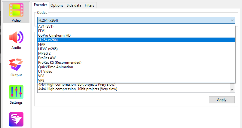

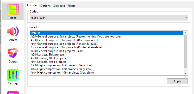

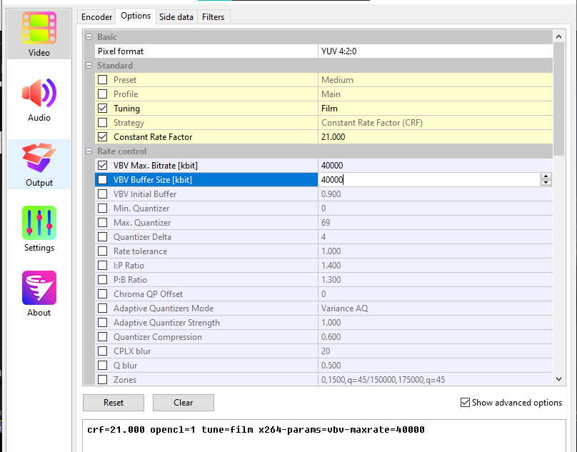

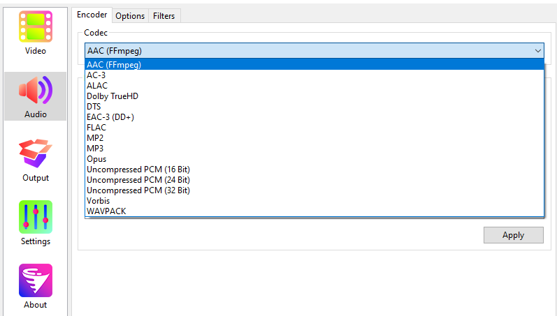

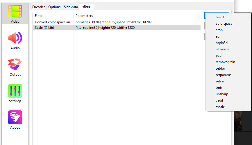

  5. If you are looking to straight encode, or use some basic filters use voukoder (free vegas export plugin) instead of frame server (voukoder has some filters as well).
Name:	_voukoder x264 settings.png
Name:	_voukoder x264 options.png
Name:	_voukoder filters.png
Name:	_voukoder codecs.png
Name:	_voukoder audio options.png

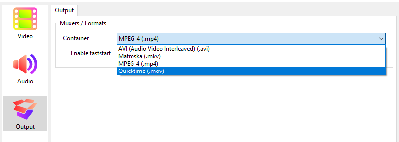

  6. also output ...
Name:	_voukoder output.png
