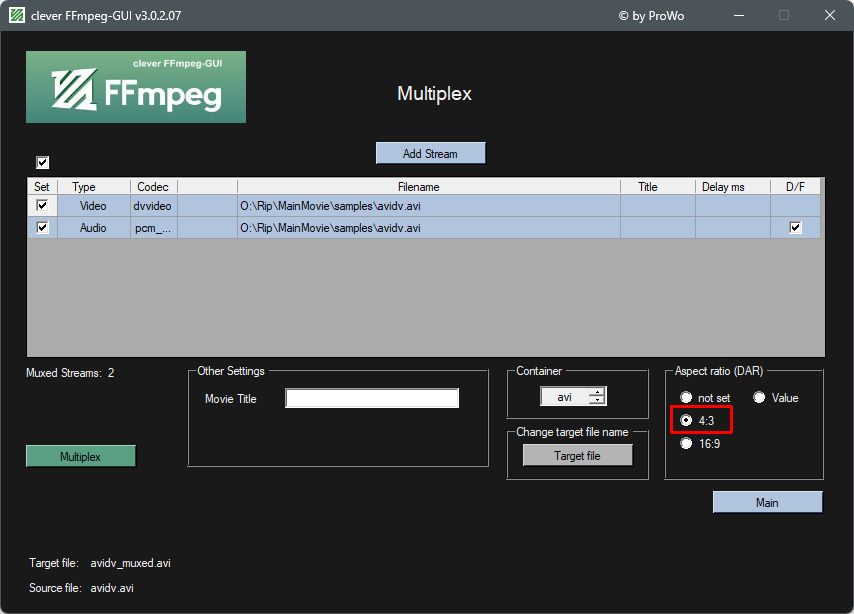

  2. Use clever FFmpeg-GUI.
    Load your avi, click main, click multiplex, select 4:3 as DAR, click multiplex. Done.
    Only remux, no reencode, so fast and no quality loss.
    [Attachment 66622 - Click to enlarge]

  7. Originally Posted by ProWo View Post
    Thanks - tried this, same result - if the AVI starts off 4:3, then on the converted file when it gets to a widescreen bit, it stays 4:3 so the image is squashed.
