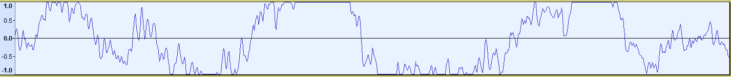

  8. With signed 16 bit sampling the smallest value that can be represented is -32768, the highest is 32767. To prevent clipping all samples must be between those extremes. When you amplify the audio the existing numbers are multiplied. If the result falls outside that range it will be "clipped". Any value over 32767 will become 32767. Any value below -32768 will become -32768. If you zoom into the a clipped waveform you will see flat tops on all the peaks, flat bottoms on all the valleys.
    [Attachment 66583 - Click to enlarge]
    Those flat tops create harsh sounding overtones, distortion.
