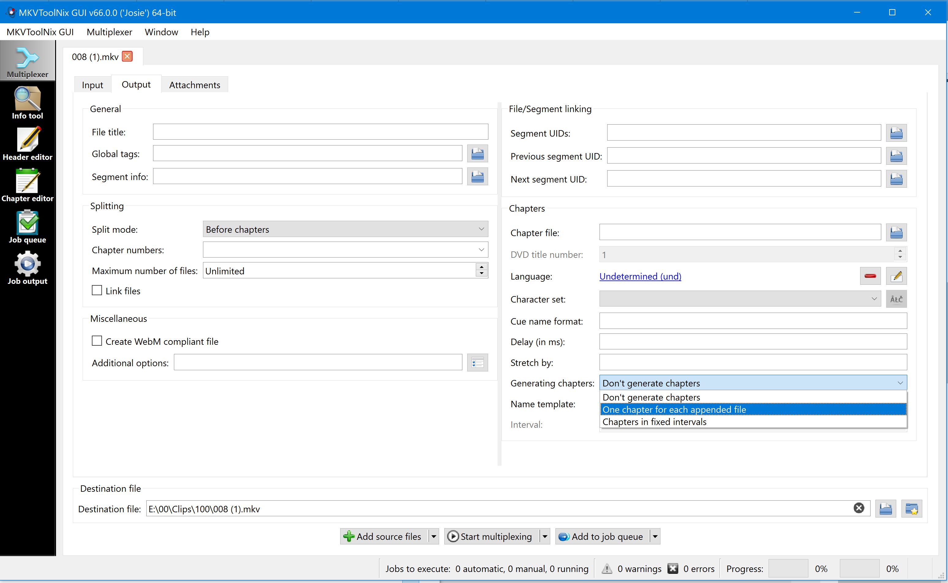

  7. Perhaps try on output tab to "Split before chapters" together with "One chapter for each appended file"
    [Attachment 66607 - Click to enlarge]

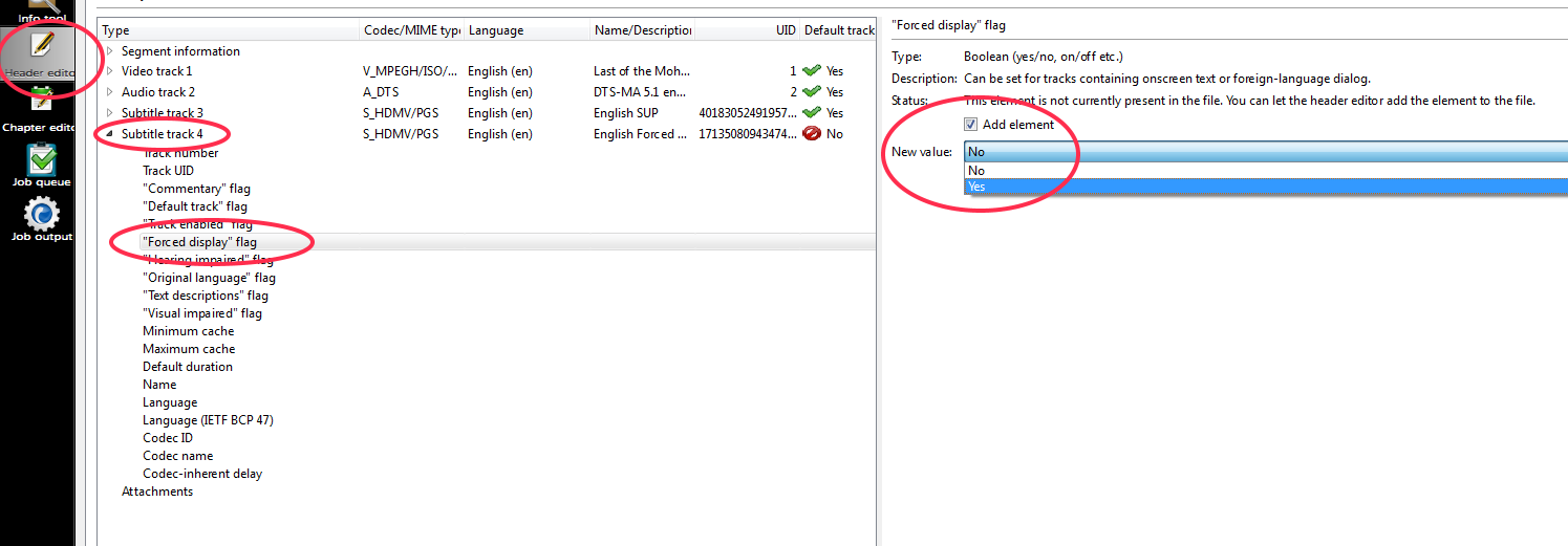

    Maybe I'm missing something, but I don't think any remuxing is necessary. OP's goal requires no more than setting a header boolean.
    Drag & drop your mkv onto MKVToolNix's Header editor. Expand the target subtitle track. In the list, select "Forced display" flag. In the settings window on the right, check "Add element" and set value to "Yes". Type Ctrl+S to save. Done. No remuxing needed.
    [Attachment 66609 - Click to enlarge]
